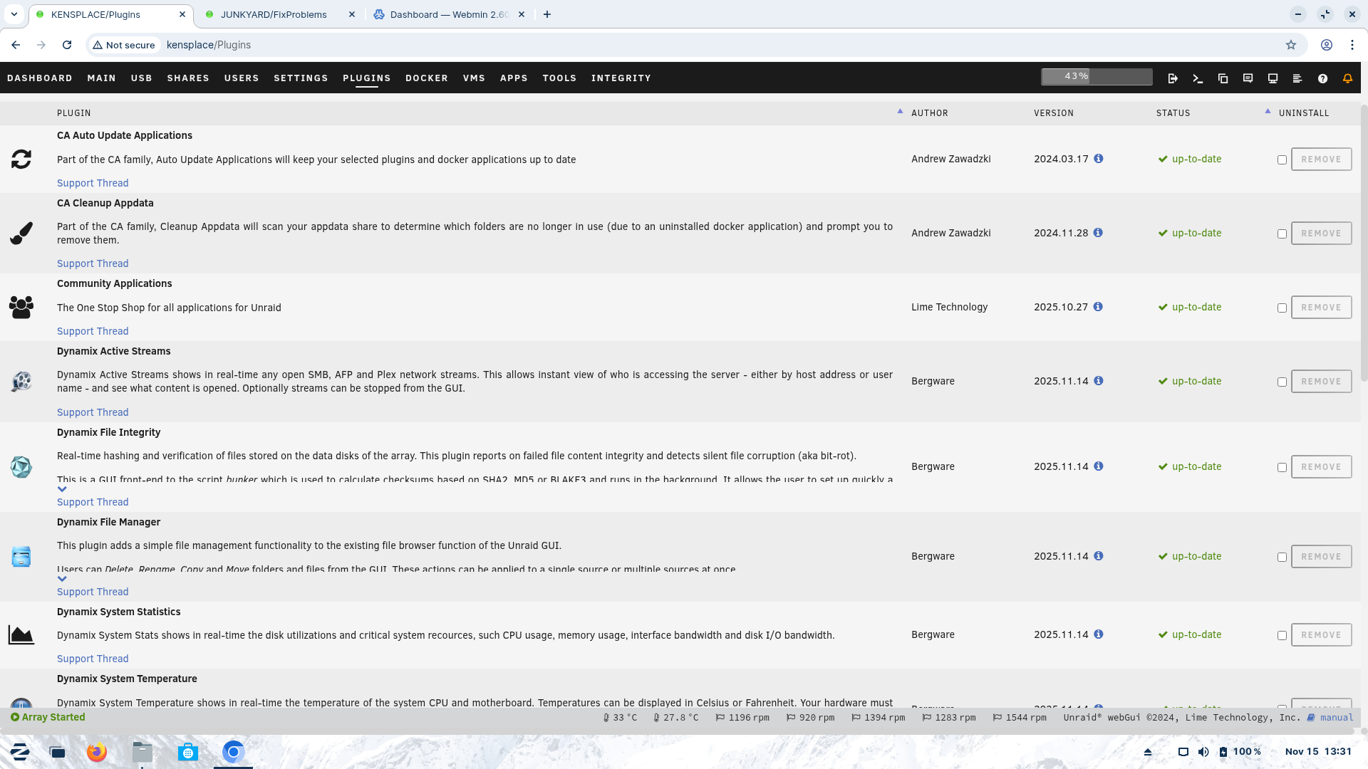

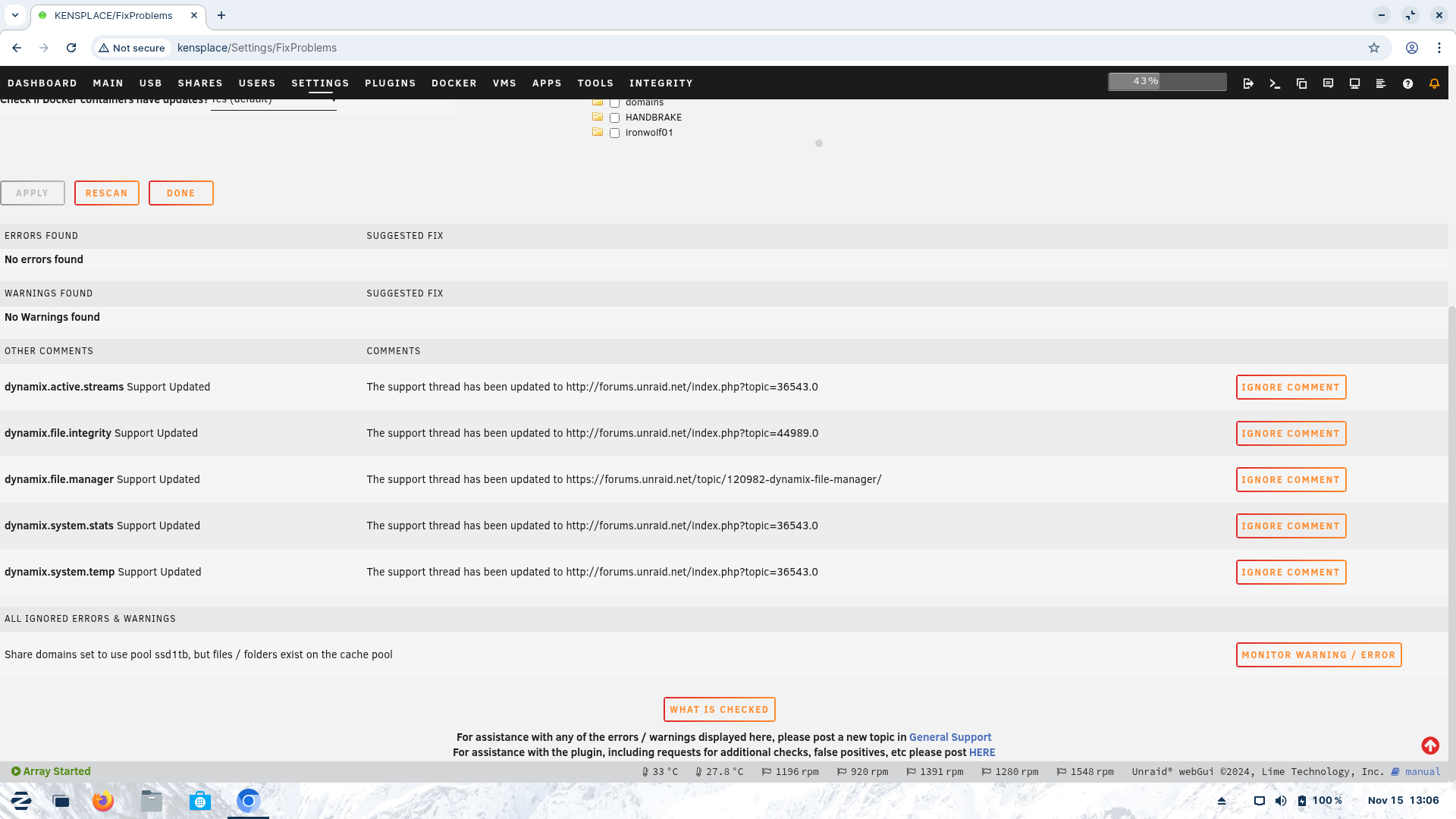

Fix Common Problems is reporting an issue with the Dynamix plugins I have installed. So I checked for updates and they were installed.
Ran Fix Common Problems again and still reporting issues.
Screen capture is after updating the Dynamix plugins...

    Hi @bonienl, is this the right channel to report a bug? If not, please point me in the right direction     I've been noticing an issue with Autofan in the last couple of months. It seems lik
  • Today has been a productive day   I have updated several Dynamix plugins, mainly bug fixes. Please check your plugins to get the updates.
Screen shot of plugins after updating.
This is happening on my two Unraid servers. Both are 6.12.15.
Cheers
Ken in Nova Scotia
It's not reporting an issue. It's reporting a comment to let you know what happened. Run fix common problems scan one more time and those comments will disappear and it should report no issues found.
Yes, 1st time "rescan" did not work, press the "rescan" button, and it will scan again for the 2nd time.
Now the error message will be gone.
Note: You must update all the plugina first, before proceeding to rescan.
