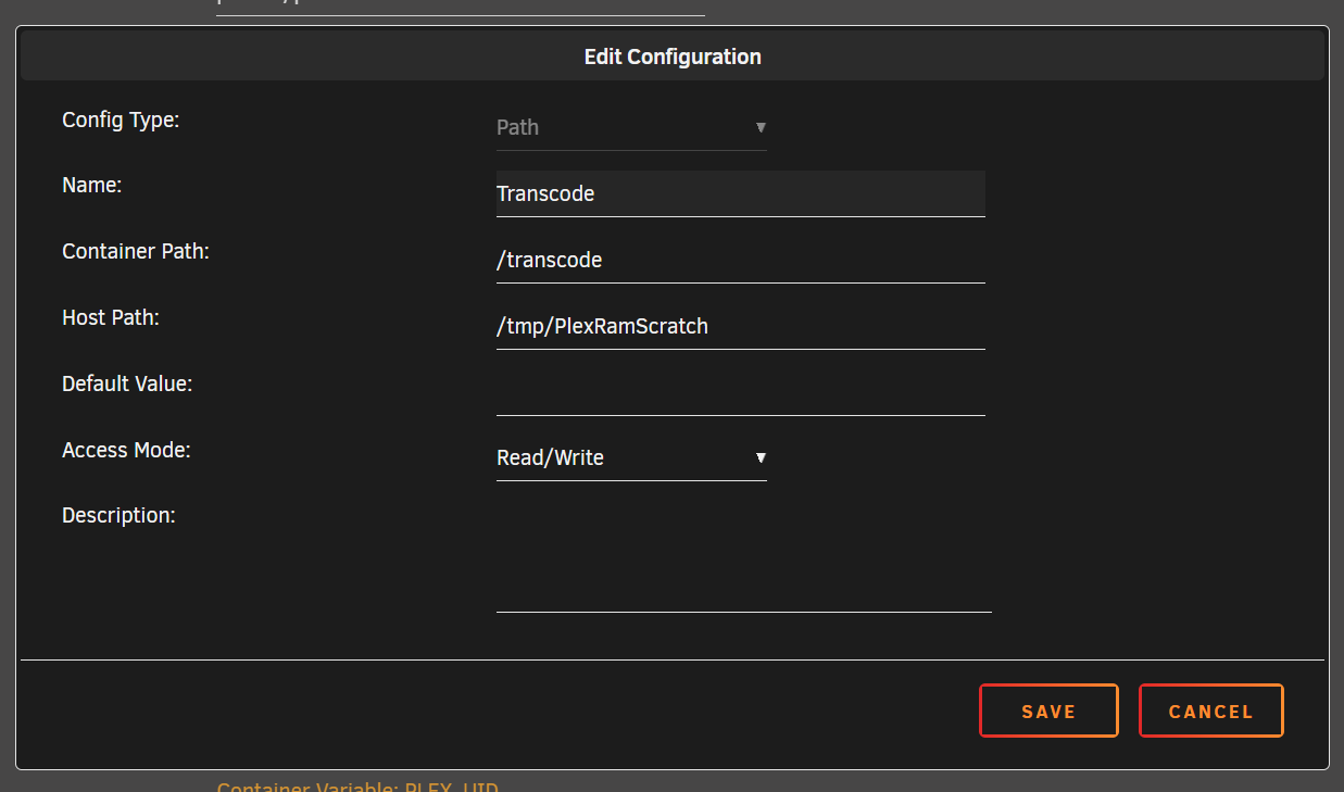

On 12/15/2023 at 10:17 PM, craigr said:
My go file PLEX lines:
#Limit PLEX Transcode RAM Drive Size
mkdir /tmp/PlexRamScratch
chmod -R 777 /tmp/PlexRamScratch
mount -t tmpfs -o size=32g tmpfs /tmp/PlexRamScratch
I do not have any extra parameters.  I am however using the Intel IGPU not Nvidia.

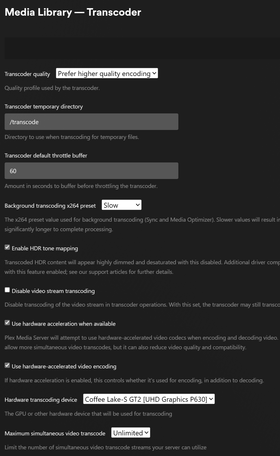

  • By this guide Plex uses your RAM while transcoding which prevents wearing out your SSD.   Edit the Plex Container and enable the "Advanced View":   Add this to "Extra Paramet
  • Yesterday, I was lazy and set only "/dev/shm/plextranscode" as my transcoding path. I checked the path and it was created: ls /dev/shm plextranscode/   But it stays empty while transcoding
  • Yes it is needed as /transcode will be created, even it is not mapped through the containers settings.   So I will hopefully update my guide for the last time ^^ EDIT: Done.
so i'm trying to move transcode to RAM to see if it works better like everyone says.  im using the below documentation to do the settings.
https://github.com/binhex/documentation/blob/master/docker/faq/plex.md
however, everytime i change and apply the settings the entire plex container disappears from the docker.  i have to change the settings back to my ssd for transcode for it to reappear and work again.  is there something i'm doing wrong or missing?  i have transcode settings in plex set to /transcode even after i change the container settings.

Forgive me if this has already been asked, but when transcoding in the RAM, should you see (hw) for transcodes? I have everything configured as the guide suggests but no extra parameters, and no GPU. My CPU is 2x E5-2697v2's (no iGPU). When I do a test transcode it just says transcoding, without the (hw). I am a PlexPass subscriber, on the latest PMS, and my transcode directory is set to /transcode which maps to /tmp/PlexRamScratch (using the go file posted).

I am struggling to set this up. For years I always used plex (linux server) with nvidia transcoding. Template has Transcode mapped as host:/dev/shm > container:transcode. This has worked well until recently when I set up a windows vm for blue iris cctv. Now I'm running into ram issues. So by adding this to Extra Parameters ** --mount type=tmpfs,destination=/tmp,tmpfs-size=4000000000 **. Do I need to change the container mapping to host:/tmp, something else or delete this mapping altogether? And inside the plex app settings, the Transcoder temp directory is /transcode. Does this need to be changed to something else as well?
