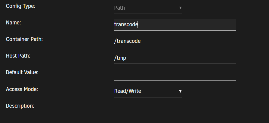

1 hour ago, tmchow said:
Currently, my plex container has /transcode mapped to /tmp.
This could be a problem.  I used to have mine set up this way but without limiting transcoding RAM in some way, tmp will eventually fill up all available RAM completely especially if there are multiple transcoding sessions going on simultaneously.
I also have 64GB RAM on my server but have limited transcoding to using 16GB RAM.
I have this in my go file to limit transcoding to 16GB and to recreate the folder in RAM on reboot:
mkdir /tmp/PlexRamScratch
chmod -R 777 /tmp/PlexRamScratch
mount -t tmpfs -o size=16g tmpfs /tmp/PlexRamScratch
With this, the mapping in the Plex docker container is /transcode to /tmp/PlexRamScratch
This forces Plex to reclaim space by deleting older transcoded bits that have already played rather than just waiting to delete them all when the entire transcode finishes.
Thanks!  Out of curiosity what does this last line do?  Is it just putting a max size on the folder? I don't quite understsand all the components of the command.
Mounts a RAM disk with a size of 16GB.  You can use less.  Some use as little as 4GB.  I am not dedicating much RAM to VMs so I have 16GB to spare for transcoding.

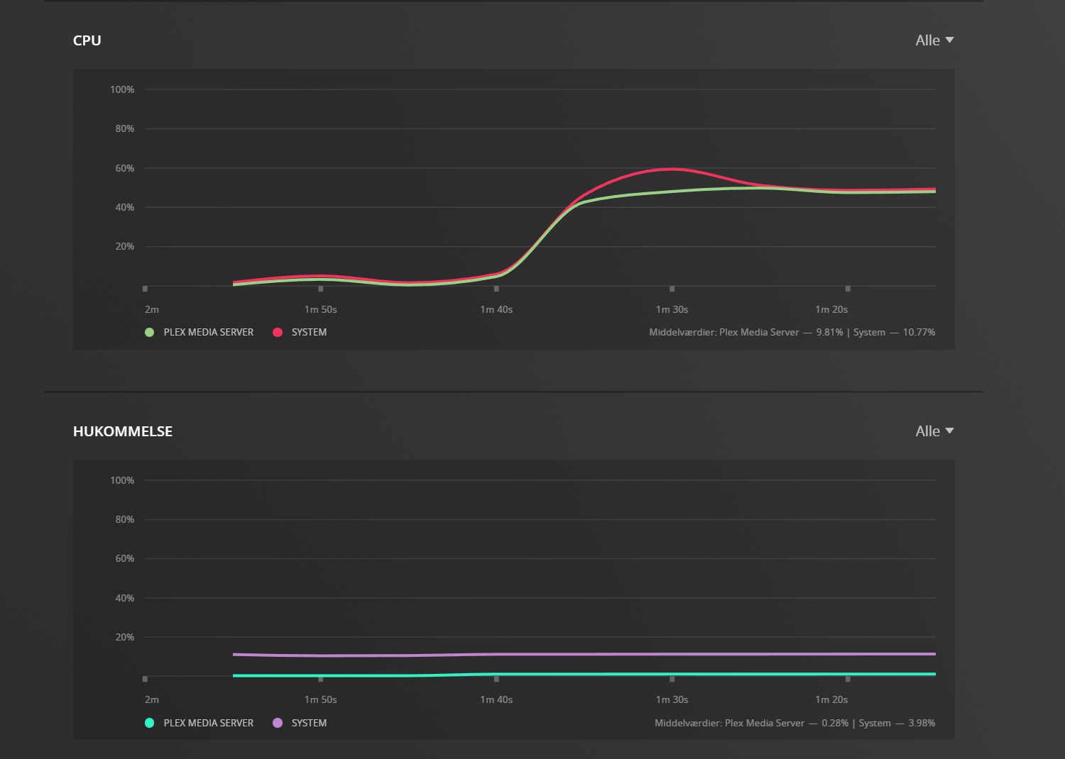

I did just try this but the CPU stills go way up?
Am i doing something wroung? :)
Assuming you are trying to do Plex transcdoing,
What is your CPU? Does it have an iGPU or are you trying to use a discrete graphics card for transcoding?
If using an iGPU, do you have the iGPU specified as the primary graphics adapter in your BIOS?
What Plex docker container are you using?
For iGPU, Do you have a /dev/dri folder on you server with the proper contents for transcoding?
For iGPU, Have you specified /dev/dri as a device for the Plex container to use?
For discrete graphics card, have you setup NVIDIA-VISIBLE_DEVICES variable?
In other words, if you are using an iGPU have you done everything specified in this tutorial?
If using a discrete Nvidia graphics card, have you done everything in this tutorial?
Edited by Hoopster
Did you read the initial post?! This thread has absolutely nothing to do with CPU load.
Ahh okay :) My CPU dosent have a iGPU. So i just want to move the transcode to RAM to save I/Os on the ssd :)
