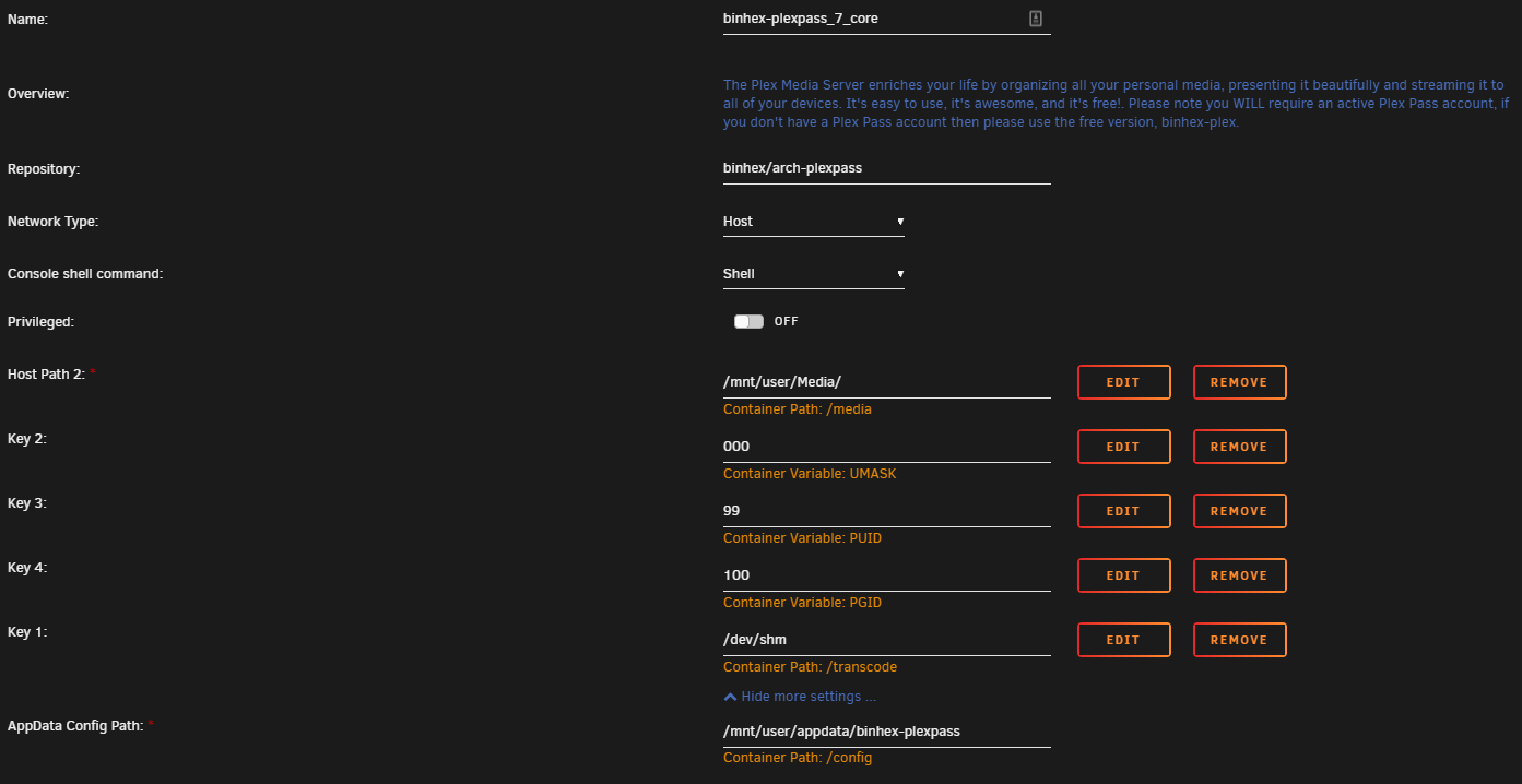

All worked well, except no files are written onto the RAM disk. One thing I noticed, the Docker template now has "Key 1" as a variable "Container Variable: TRANS_DIR" and not transcode anymore. Within Plex the transcode path is still /transcode. Could this be my problem?

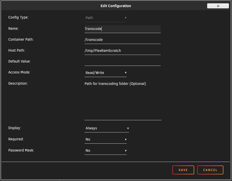

If you press the edit button of the path, what is set as container and what as host path? Take a screenshot of you like.
2 minutes ago, mgutt said:
As shown in the screenshot the container path /transcode needs to be linked to the hosts ram disk path.
Maybe that is where the confusion is. There is no /transcode setting like in earlier versions. Key1 is TRANS_DIR, which I assumed is the correct place to set the transcode directory.

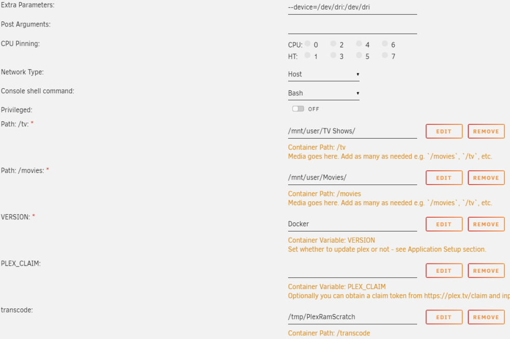

Well, that likely depends upon which docker container you are using for Plex.  Are you using Binhex or Plex Inc Official container?  I am using the Linuxserver.io Plex container and /transcode is still the setting I use and it works great.  All my transcode files are being created in PlexRamScratch as they should be.

Confusing. That does not look like the newest binhex-plexpass edition. Here is the current version, fresh out of the APPS tab. Note that the Key variables are in order 1-4 and Key 1 is named different than yours.

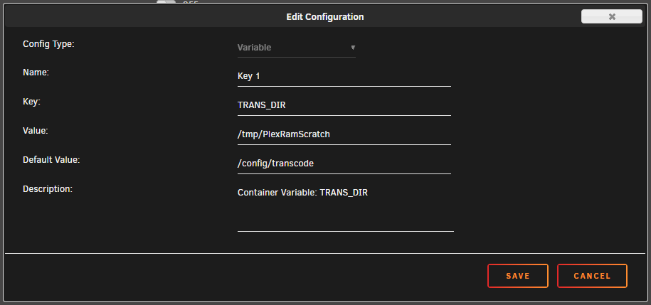

Note that this doesn't appear to be the default binhex-plexpass template though, since the default template uses a variable instead of a path, and @UnraidDuck also has a variable in the screenshot.
I also use linuxserver and haven't kept up with how people setup ram transcoding on binhex versions. From the default template posted above it looks like the variable is expecting a path that already exists within the container, with the default value being a subfolder of the config folder. So that would be a subfolder of the plex appdata. And I would expect that if you specify a /tmp or /dev folder for that variable, instead of creating a path mapping, it is going to transcode into docker.img.
/config/transcode seems to translate to /transcode within the root of the docker directory in appdata. In my case (which should be standard) /mnt/user/appdata/binhex-plexpass/transcode.

16 minutes ago, Hoopster said:
Here's what the Binhex Plex documentation has to say:
Ok, looks like the TRANS_DIR values aren't really paths. Instead these are "switches" to select between three predefined paths.
So the solution would be to set TRANS_DIR to /tmp
Does Binhex generate an additional subfolder in /tmp if this setting is used?
Thanks to @Hoopster Reminder to RTFM, I now have Plex transcoding to the RAM disk.

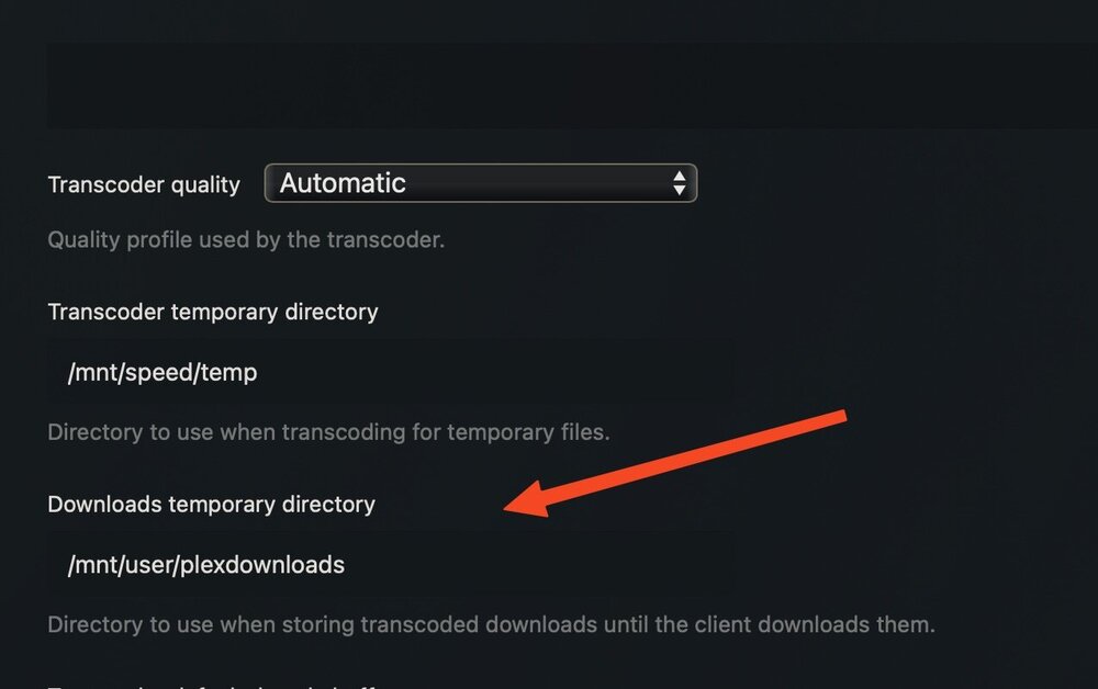

Hi everyone, looking for solution how to set up transcoding to the ram without docker. My server has 128GB ram and I wanna use it this for transcoding. I set folder and set trancoding in plex web:
sudo mkdir /mnt/plexdisk
sudo mount -t tmpfs -o rw,size=50G tmpfs /mnt/plexdisk
Set the Transcoder temporary directory to /mnt/plexdisk
But seems not working. Can someone help me?
Your screenshots shows 3.9G usage, so why do you think that? PS you need only 2 to 8G. Plex purges the folder automatically.
