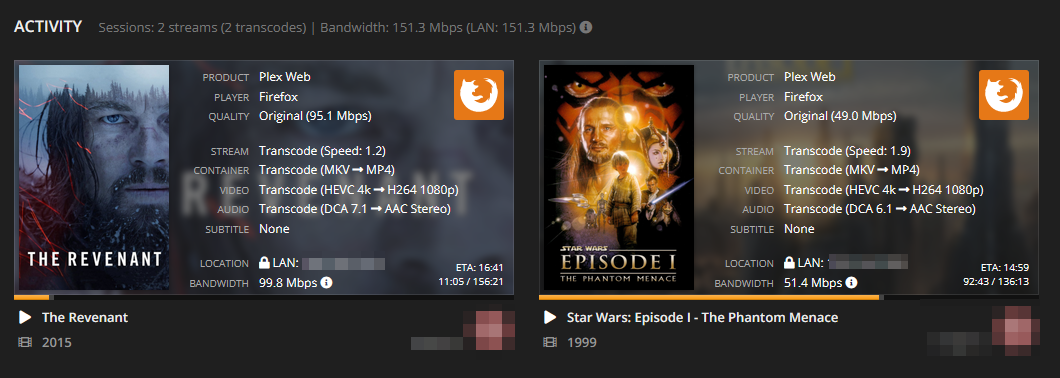

Edit: Kicked off two transcoding streams (from 4K, which I'm impressed my system managed - see attached image) and my observation was that the usage grew to 8GB (100%) and then dropped to 4GB (50%). So it seems Plex might be dividing the available transcode space evenly between jobs and purging history once they fill their "allowance".

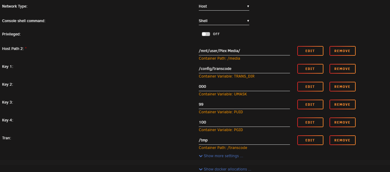

i havent ever used SSH so im not sure where to start with that. however, below is my docker config.
In Plex, what did you set as the transcode location?  You have two variables in your docker config which could potentially determine where transcoding takes place.  You have a TRANS_DIR variable set to /config/transcode (your Plex appdata folder on the SSD) and another set to /tmp.  Which container path did you specify in Plex  (TRANS_DIR or /transcode)?
You don't need both.

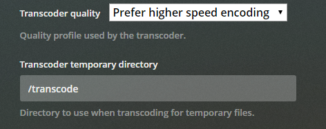

in plex i set it to /transcode . pictured below.
Then it should be transcoding in /tmp in RAM.  You can open a terminal session from the WebGUI and do a 'cd /tmp' from the command line.  You should see the Transcode/Sessions folder there.  If Plex is transcoding you will see the transcode files there.

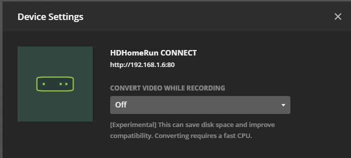

This is why I disabled RAM transcoding and went back to doing it on an SSD.  I have 128GB RAM, so it's not like I don't have options.  I think what was happening is that the RAW stream of the show was very big and for some reason was trying to play a full copy in the ramdisk.  I think I did validate at some point that's what it did (there's some commentary around it earlier in this thread I think).  There needs to be a way to separate the two out and then it would work I suppose, but I didn't look into it much further - too many projects on at the moment. :D
6 hours ago, Aerodb said:
 I have the homerun HD set up to allow me to stream live TV to the plex server and DVR media to the server. My homerun has two tuners and I have been able to DVR two shows at once to the server. BUT now that media is transcoding to RAM, it seems to error on the second show. Showing not enough storage space. as if my 32gb of RAM is not enough for two 60 minute shows. these are 720i (not 720p) streams, should be more than enough ram space. Also, while this is happening, the RAM is never over 40% used.
I no longer have transcoding to RAM configured for this reason. It was fine for a long time with HDHomeRun recorded shows, but, Plex changed something recently with how transcoding works that requires a lot more RAM/disk space when recording TV shows.  I would see the same thing if two overlapping shows were scheduled to record. The first one would record without issue and the second one would fail. I have 32GB RAM in my server.   I think it has something to do with being able to playback, FF/Rew a show while it is still recording and the setting mentioned below.
I switched transcoding to a 1TB SSD (which also has other uses) and no longer have the problem.
You might also try setting "Convert Video While Recording" to Off as this will use more RAM.  Do that first and see if it makes a difference.  If not, you may need either more RAM or a different transcoding location.
