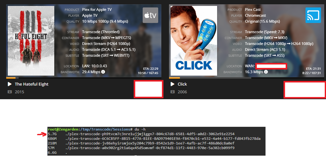

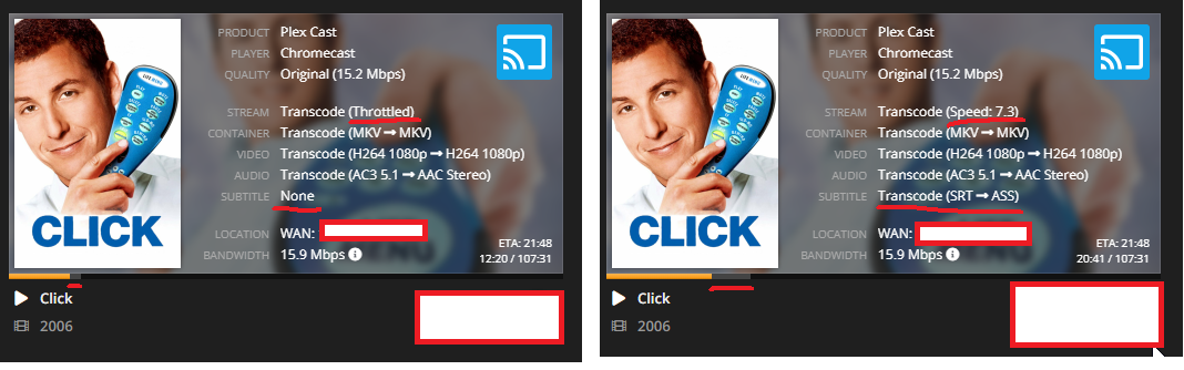

So I've been testing more and I've come to the conclusion that it is the client one of my users are using that is the problem: Chromecast. Whenever he plays something via the Chromecast it buffers the whole movie into RAM almost immediately, he can watch for 15 mins or so and then the whole movie is in RAM and gets killed.
I had him try using the web player on his computer, and then it worked fine, it only buffered a couple of % ahead of where he was, like it should.
This picture pretty much sums it up. Look at the buffer bars.
EDIT: I have narrowed it down even further, and come to the conclusion that it is the transcoding of subtitles that is causing the problem, atleast when transcoding to ASS format.
EDIT 2: And you can probably narrow it down even further to only being a issue with Chromecast users, because it transcodes to a MKV container. I tried with the web player in Chrome, which also uses ASS subtitles, but a MP4 container and then I can see the transcoder is throttled.
