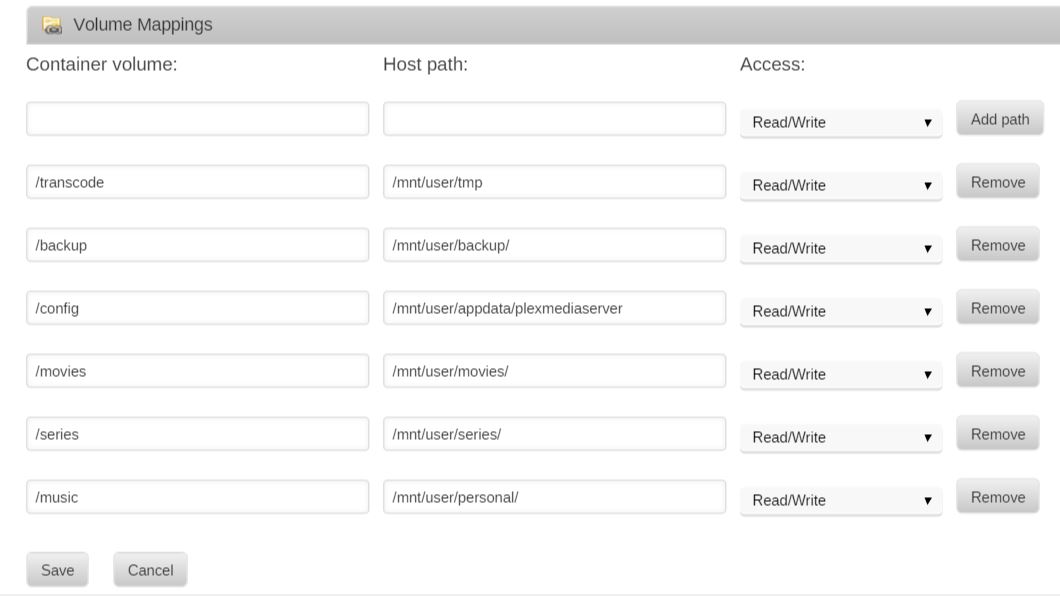

I'm newb and not as advanced as all of you. I faced an issue and I believe I solved it but not so sure.
I have unraid 6.1.7 and 32GB ram.
I've mapped the docker as suggested:
I've typed /transcode in Container volume box and /tmp in Host path box but when tested it and opened a movie, it didn't work.
Then I changed the Host path to /mnt/user/tmp and it worked
However, I kept that movie playing and I opened to the dashboard to see the load, CPU had about 50% load and the memory had just 4%
I'm not sure the transcoding is being performed by the RAM.
I have attached a snap shot of the mapping, what is wrong here?
Thanks,
Abdulla

/mnt/user/tmp is not in RAM. When you specified that path you actually created a user share named tmp which will be stored on your disks using the default user share settings.
Your original mapping of /transcode:/tmp was the right one because /tmp is in RAM, but you also have to go into plex and tell it to use /transcode for transcoding.
Also, there have been reports that this doesn't work correctly with recent version of plex anyway. Not sure if that was ever resolved or not.

Thanks for the quick reply. I changed that in Plex transcoder page but the video is not working.
Transcoding in RAM stopped working around Plex 0.9.14.  See the other comments on this page.
For more info on moving the transcoding directory, see: https://lime-technology.com/forum/index.php?topic=40937.msg419495#msg419495
