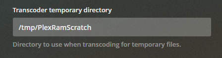

So I'm trying to get my Plex server (UnRaid Docker) to transcode to ram.. I have installed the CA User Scripts and set up the 4G ramdrive as listed a few posts up and set to start with the array. I just want to make sure all my settings are correct.
In the Docker container settings I have the TRANS_DIR variable set to /tmp/PlexRamScratch
In my Plex server settings under Transcoder Settings I have also set the Transcoder temporary directory to /tmp/PlexRamScratch
Is that all that should be required?
/tmp/PlexRamScratch is your host path.  What is your container path set to for TRANS_DIR?
In the Plex server Transcoder Settings you specify the container path (/transcode or whatever you defined) NOT the host path.

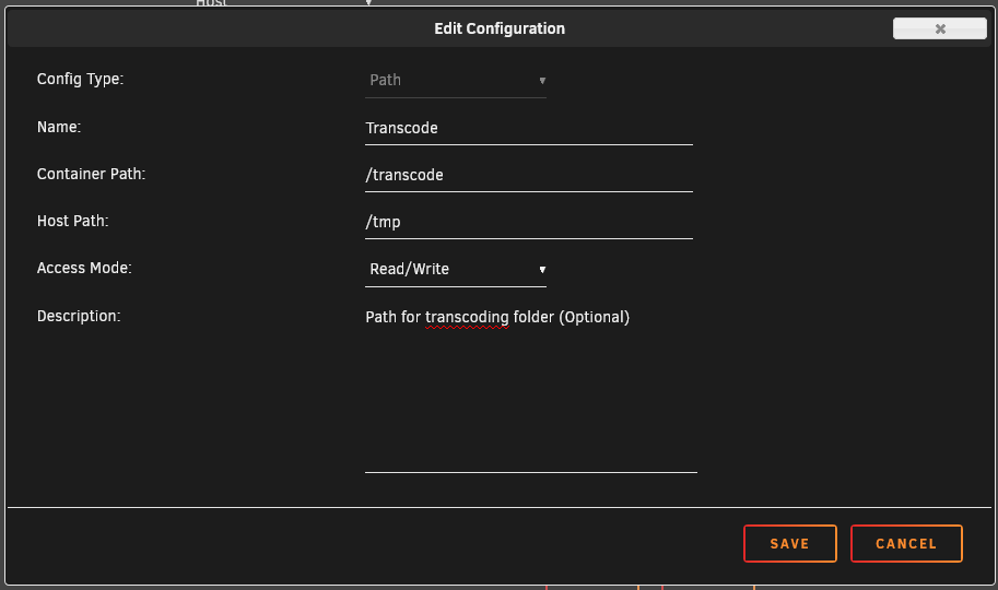

22 minutes ago, amplified2000 said:
Click on the Edit button for Key 1 and post a screenshot of the Edit Configuration screen.
