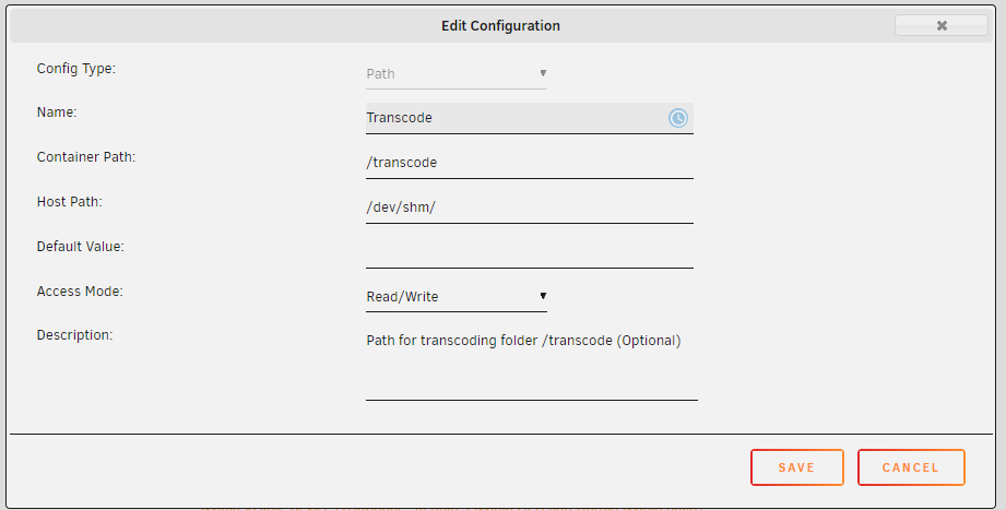

  • By this guide Plex uses your RAM while transcoding which prevents wearing out your SSD.   Edit the Plex Container and enable the "Advanced View":   Add this to "Extra Paramet
  • Yesterday, I was lazy and set only "/dev/shm/plextranscode" as my transcoding path. I checked the path and it was created: ls /dev/shm plextranscode/   But it stays empty while transcoding
  • Yes it is needed as /transcode will be created, even it is not mapped through the containers settings.   So I will hopefully update my guide for the last time ^^ EDIT: Done.

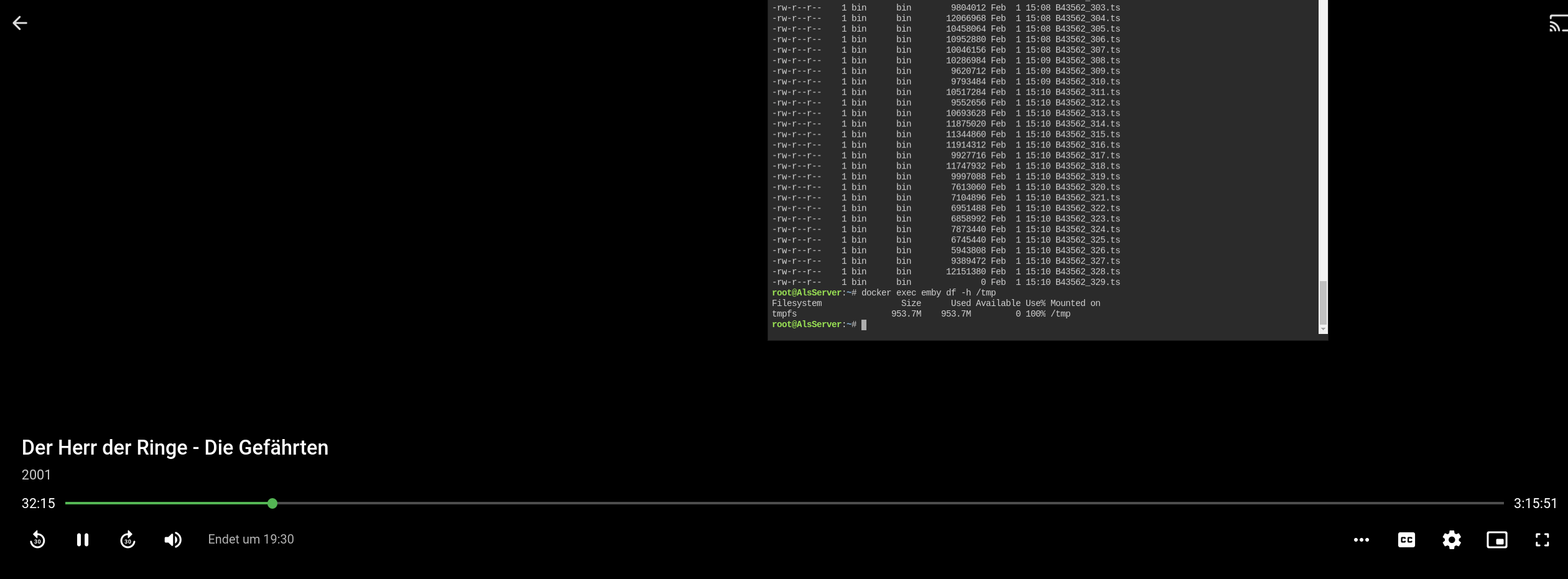

here a sample when emby stalls ... after 100 % fillrate in /tmp
stream stops, cant continue, only stop and restart stream.

On 2/1/2021 at 4:13 PM, mgutt said:
Is it needed? As /transcode does not exists, it should fallback to /tmp automatically.

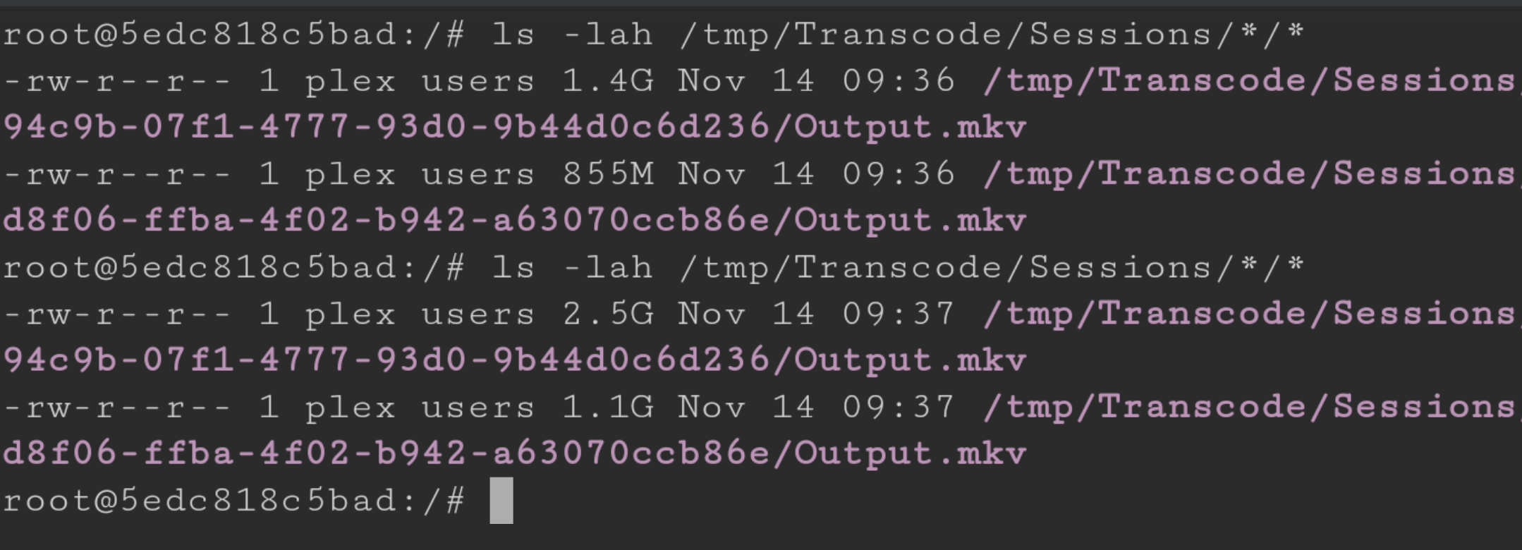

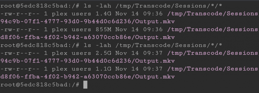

It seems so. I tested it and Plex creates the complete movie file, before it is downloaded through the client. My RAM Disk is limited to 6GB and as you can see it is automatically removed after the file hits this limit:
This means we need 10 to 50GB per movie, depending on the size of the movie.
But there is another problem. Multiple downloads per user, creates at least two parallel transcodes:
1999352997_Screenshot_20211114-0937372.thumb.png.40ff610b899a0bb62e482e2f9f889674.png
I did not tested multiple users, but I think this will be even more. So we really need to be able to change the download transcoding path somehow or we are forced to use an SSD for all transcodes or install much more RAM 🙈
