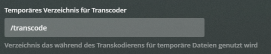

The screenshot has the destination down as /transcoding, is that a typo in the text with
--mount type=tmpfs,destination=/transc,tmpfs-size=4000000000
8 minutes ago, ich777 said:
--mount type=tmpfs
It should be:
--mount type=tmpfs,destination=/transcode,tmpfs-size=4000000000
As /transcode is the default transcode path of Plex:
This is really nice as it makes it even easier as this tmpfs path only exists inside of the Plex Container. I will update my Guide. Thank you!
Sorry my bad... :P
EDIT: Corrected it in my post but that shouldn't matter this describes only the path in the container itself whether it's '/transc', '/transcode', '/transcoding', '/mnt/transcoding' or whatever you want. Just be sure to set the transcoding path in your App (Plex, Emby, Jellyfin,...) to the corresponding path that you defined in the 'Extra Parameters'.

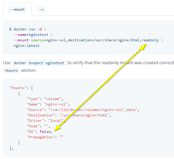

may consider add :rw
--mount type=tmpfs,destination=/transcoding:rw,tmpfs-size=4000000000
otherwise plex wont write into the mount (at least here ...)
ok, well, here it falls back and writes then into /tmp/transcode inside docker which ends up in filling up docker image, nevermind, was just taking a look if it simply works (as i expected too) but fails here.
ok, reverted and now it works ... dont ask me why

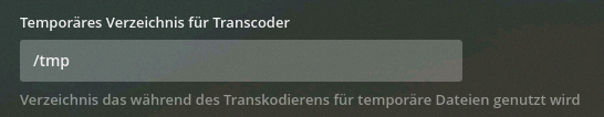

@alturismo & @mgutt
I now have a working solution.
Put this into your 'Extra Parameters':
--mount type=tmpfs,destination=/tmp,tmpfs-size=4000000000
Then go to your Plex transcoding settings and set the path to '/tmp':
Tested this after 5 restarts and the permissions for '/tmp' are always:
After the first start:
drwxrwxrwt   4 root root    80 Feb  1 15:36 tmp
After a restart:
drwxrwxrwt   3 root root    60 Feb  1 15:37 tmp
After the fifth restart:
drwxrwxrwt   3 root root    60 Feb  1 15:39 tmp
Hope that helps ;)
Is it needed? As /transcode does not exists, it should fallback to /tmp automatically.
