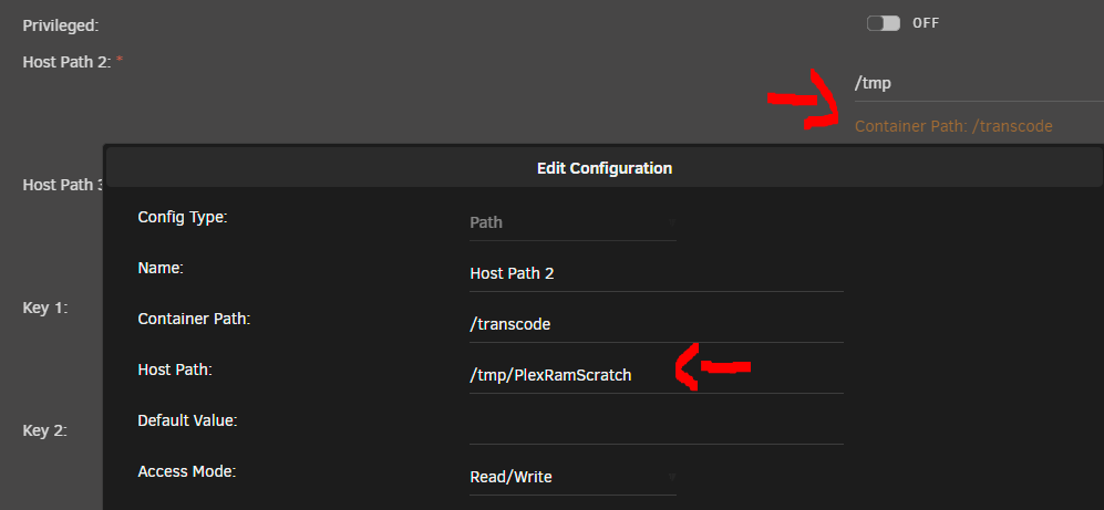

On 10/13/2022 at 6:37 PM, Hoopster said:
...I have this in my go file to limit transcoding to 16GB and to recreate the folder in RAM on reboot:
mkdir /tmp/PlexRamScratch
chmod -R 777 /tmp/PlexRamScratch

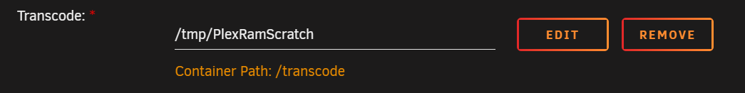

mount -t tmpfs -o size=16g tmpfs /tmp/PlexRamScratch
With this, the mapping in the Plex docker container is /transcode to /tmp/PlexRamScratch
This forces Plex to reclaim space by deleting older transcoded bits that have already played rather than just waiting to delete them all when the entire transcode finishes.
For those who may not realize, for this to work, the PLEX container must be mapped like this:

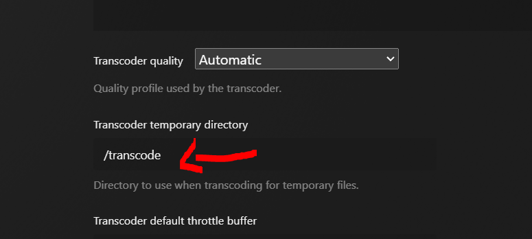

you can also accomplish this within Plex server settings specify the transcode directory to be /transcode/PlexRamScratch instead of it being /transcode

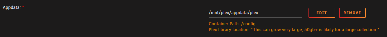

31 minutes ago, bombz said:
Are there some 'best practices' other than this transcode recommendation regarding the PLEX DOCKER deployment that are recommended?
I don't know about recommended but I also have Plex appdata folder on a dedicated SSD.  I separated it from other Docker container appdata because Plex appdata can get large and backing it up and restoring it is easier with dedicated storage.
This is certainly not a necessity.  It is just a personal preference.

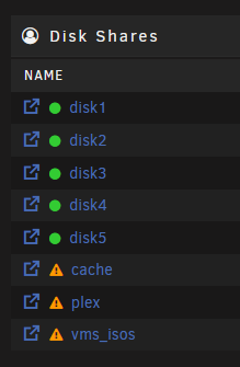

1 hour ago, bombz said:
I am really curious to this setup
In Shares, Plex is a disk share (name of SSD):
In Plex docker container plex appdata is on the mnt/plex disk share
View of Plex SSD in Windows:
Edited by Hoopster

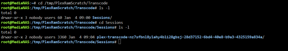

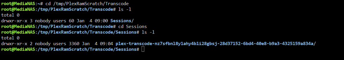

Look in the folder you have designated in RAM for transoding (/tmp/PlexRamScratch on my system).  There should be a Transcode folder there with a Sessions subfolder which contains the transcoding pieces if things are working properly.
Mine looks loke this, No "sessions" folder, but others
Is this working?
Thank you again :)
1 hour ago, smaiderman said:
Is this working?
Mine has always had the /tmp/PlexRamScratch/Transcode/Sessions structure; however, if you see the transcode files being created and deleted in your folder structure as a file is being transcoded, that would indicate it is working properly.

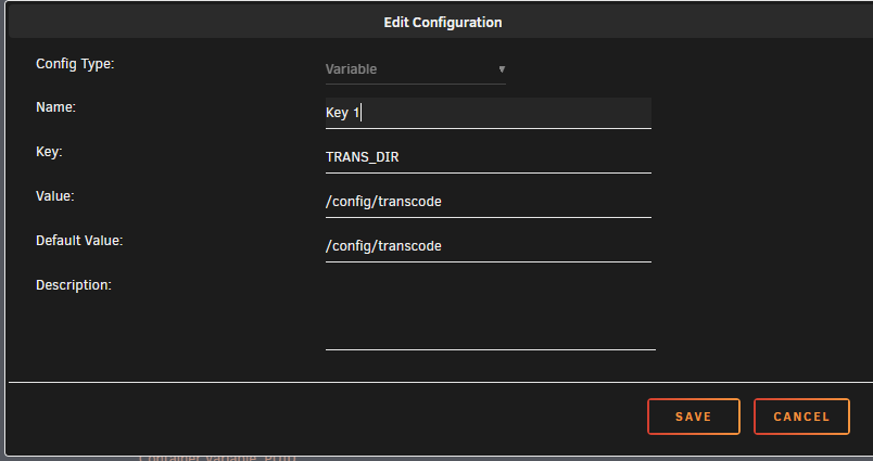

I've followed the guide from @craigr but for some reason the transcode isn't taking place on the RAM, as shown in the first screenshot.
The movie is definitely being transcoded as you can see below.
My Plex docker setup is shown below.
I dont know where i've gone wrong and I cant figure out where the transcoding session is because it's not in my Appdata either.
If anyone could help me out i'd really appreciate it. Thanks
not sure if you still have this issue, it seems that you set your Plex Media Server to /Transcode and yet the docker refers to /transcode. For Linux based OS, capital is different than lower case.
