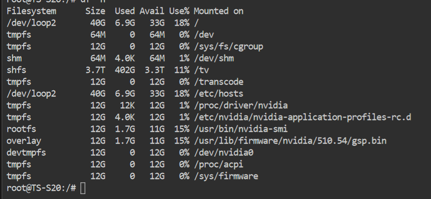

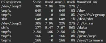

I'm having an odd issue with transcode to memory on 1 specific movie.
So just to establish I am successfully transcoding to memory with --mount type=tmpfs,destination=/transcode,tmpfs-size=4000000000
and /tmp directory in plex. I also confirmed this with df -h.
But for some reason when I play the movie "Cars" which is 4K HEVC and transcode to H264 I get the error "Not enough disk space to convert this item".
As a test, I edited to use up to 8 gigs of memory "--mount type=tmpfs,destination=/transcode,tmpfs-size=8000000000" and retested and no change.
What else could cause this? I tested 8 other 4K HEVC movies which do not have this issue at all. See screenshot of df -h below.
Edited by TopherHax
i guess (and its really a guess) its the audio line, as  sample, i also would need min 3 GB Ram Disk when i playback a DTS-HD movie as i use ARC and the TV cant playback DTS-HD Audio ... may take a look at the audio lines if there is a difference.
Update, I got a different copy of this movie and it fixed the issue.

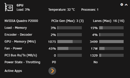

I'm having some issues transcoding to RAM.
I'm running the following parameters in my Plex container:
--runtime=nvidia --device=/dev/dri --mount type=tmpfs,destination=/tmp,tmpfs-size=20000000000 --no-healthcheck
The GPU is responding just fine:

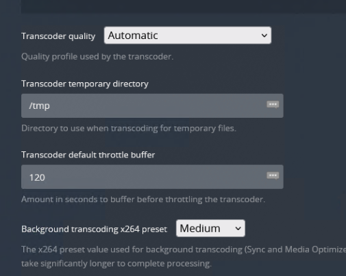

I've configured /tmp as my transcode directory within Plex:
But /tmp is not showing up when I run the "df -h" command.
Did I overlook something?
You don’t need those parameters in the Docker container, just map the container /transcode to /tmp on host and point Plex to /transcode.

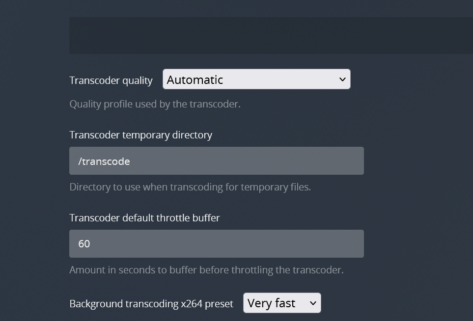

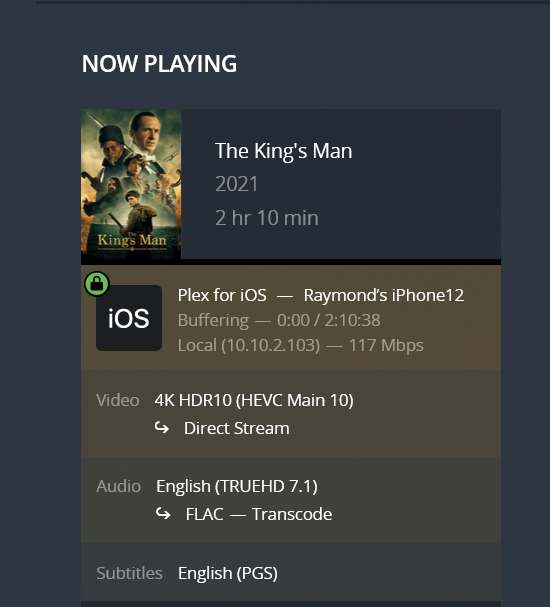

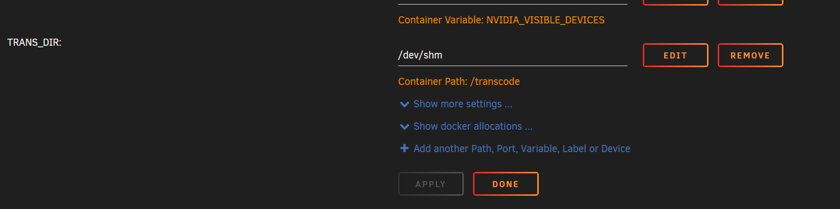

I setup Plex transcode to /dev/shm
but my transcoding seems doesn't work? I wonder why. The media just keep buffering and nothing happen.image.png.997ff73361a3526a15293f11c0f8cfb8.png
image.png.a53bf0462b03408aff75e5a1b81c8113.pngimage.png.72a153348895a50dd349c896036d5a10.png
