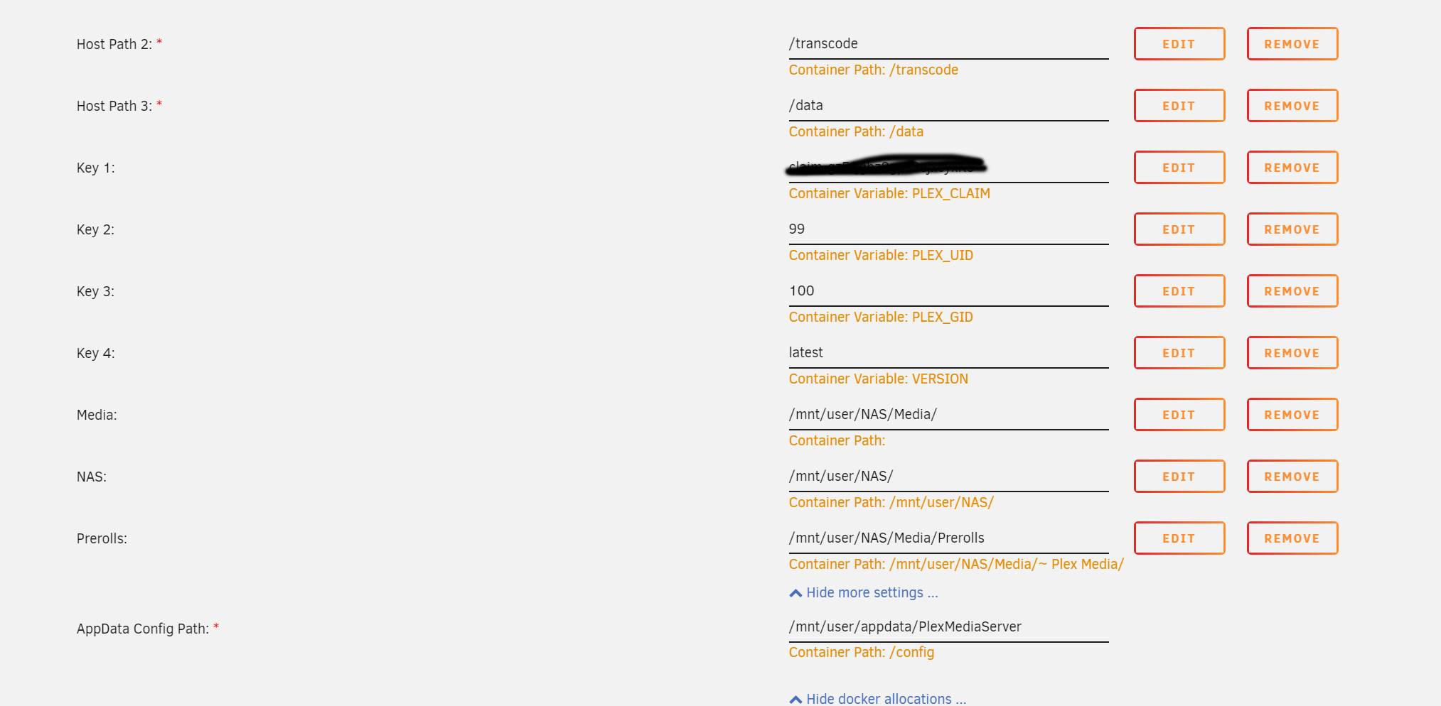

Started getting some notices today when I had a few people streaming that my docker utilization was high (75%). Checked with docker system df -v what was high in usage and noticed Plex was around 10gb. Thinking of either moving it to RAM or an unassigned SSD, but wanted to see if my config looked right first.
Plex settings is /transcode
Docker below
Edited by KJThaDon
Docker below
Your problem may be due to the /transcode path not being something like /tmp if you wanted to transcode to ram or /tmp/PlexRamScratch if you use the size limited ram disk script as posted earlier in the thread. Since /transcode does not exist as a an actual directory in your setup most likely, I believe Plex is defaulting to transcoding within the docker image and that is why it is filling up.

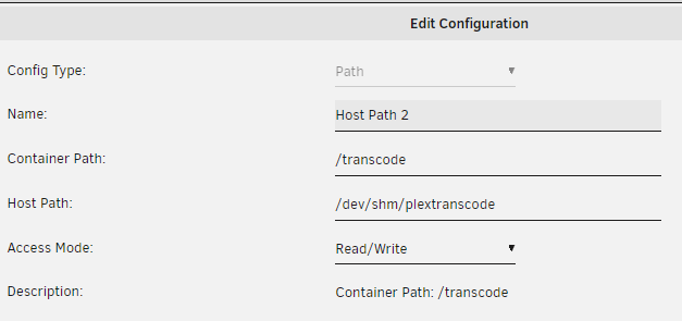

Yesterday, I was lazy and set only "/dev/shm/plextranscode" as my transcoding path. I checked the path and it was created:
ls /dev/shm
plextranscode/
But it stays empty while transcoding!

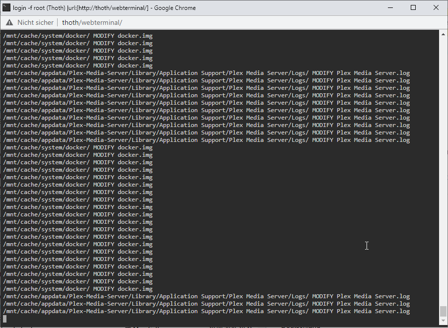

I saw in the Main overview of the Unraid WebGUI that it still produces writes on the NVMe where the docker image is located. With this useful command I was able to verify it:
inotifywait -mr /mnt/cache
While this returned nothing:
inotifywait -mr /dev/shm
So the writes are not leaving the docker image. But why? The container's config looks correct:

I verified if the container is able to write a file into /transcode
# echo "test" > /transcode/test.txt
# cat /transcode/test.txt
test
# ls -l /transcode/test.txt
-rw-r--r-- 1 root root 5 Sep 19 12:51 /transcode/test.txt
Re-checked if it exists in dev/shm:
ls /dev/shm/plextranscode
test.txt

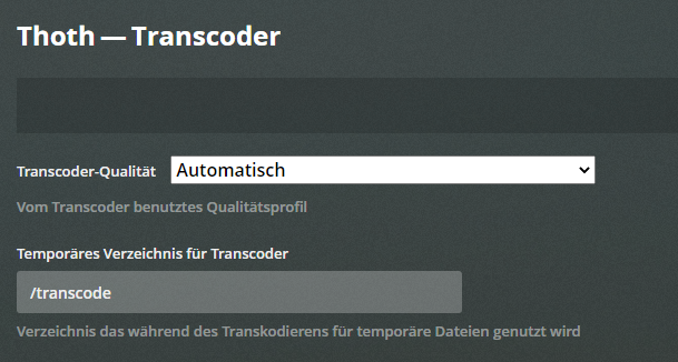

Strange. Re-checked plex transcoding path and its correct:
Double-checked the Preferences.xml content:

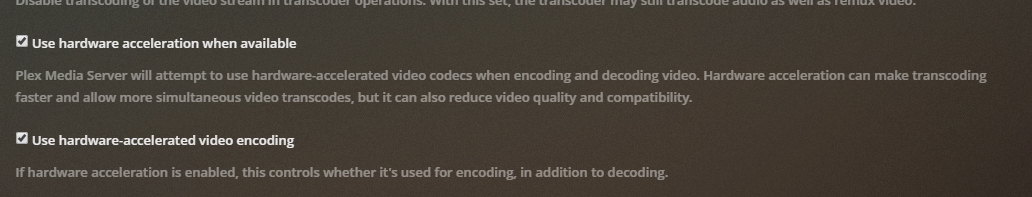

You also want to select these options in the Transcoder settings:

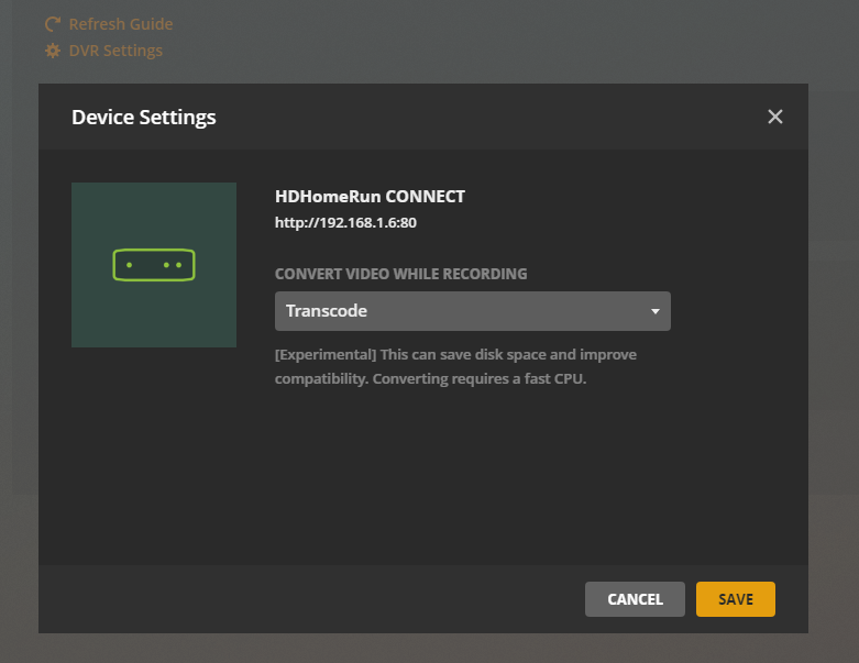

In addition to transcoding movies as they stream, I am running OTA TV show recording through Plex via a couple of HDHomeRun tuners.  A recent change in HDHomeRun recording started using 16GB per 1-hour program.  When I had two records going at once, the 2nd would fail as I only had 32 GB RAM.
The HDHomeRun change was to enable time-shifting while recording.  Since I never watch a recording in progress, I saw no need to use that much RAM.

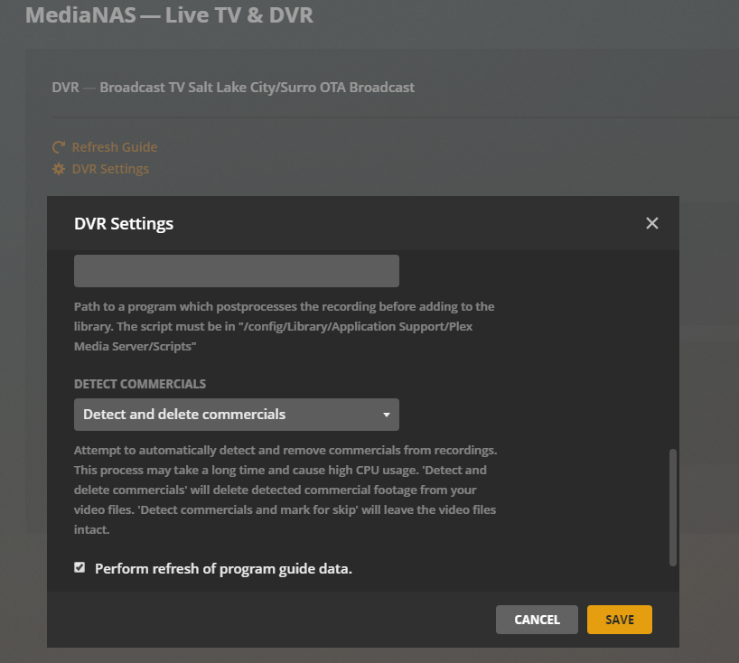

How are you removing the commercials? Does Plex do that on its own when you DVR something?

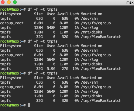

Well since I'm doing all this right now maybe I should just go ahead and set up the tmpfs/scratch disk method. I guess I need to go back some pages and research that a bit more.
What is the tmpfs/scratch disk method doing that helps you be able to transcode with RAM but still do all the dvr stuff with the OTA? I guess I'm not following whats going on. I'm actually setting up a HD Homerun this week so I guess I need to understand how this is all working.
It's a Plex Live TV and DVR setting.
I also now have 64GB RAM so it likely would not matter as much.
As I understand it (or maybe dont understand it) the tmpfs/scratch disk method allows you to create a limited amount of ram for Plex to use. If you were maxing out your /tmp then how are you able to have the same functionality of having two recordings going at once that use 16GB each when you have reduced your ram allocation?  Does Plex start to overflow into a different location that isnt ram?  I'm confused about that.
See the 2nd setting above; Convert while recording.  Otherwise I would run out.  I have allocated 16GB to the scratch disk.  Seems to be working so far.

I was able to setup as the guide. But a film lagged playing direct (116 Mb/sec). When setting transcode to smb ssd share, no lagging. How do I find out what is wrong?
It was directly playing and its bitrate is 116 Mbit/s?! This is extremely high, even for a 4K movie. Are you sure your Client is able to render such a high bitrate? And finally this stands in contradiction to the 19% fill rate of the "/tmp/PlexRamScratch" folder. If the movie was directly played, the folder must stay empty. Its only filled on transcoding operations.
It was not direct play.  It made transcoding to max resolution. The ramdisk picture is somewhat misleading, 19% is just after few minutes play. The film started with long stops after a few minutes, RAMdisk full? That could explain what no stops after I set transcoding to a smb ssd share.
40 minutes ago, frodr said:
RAMdisk full?
19% isn't full, but maybe your system was out of RAM?! Please check while transcoding your RAM usage with "free -h".
The film stopped later than when 19% was recorded. I will test again tomorrow. 128G of total mem, some 30% in use.
