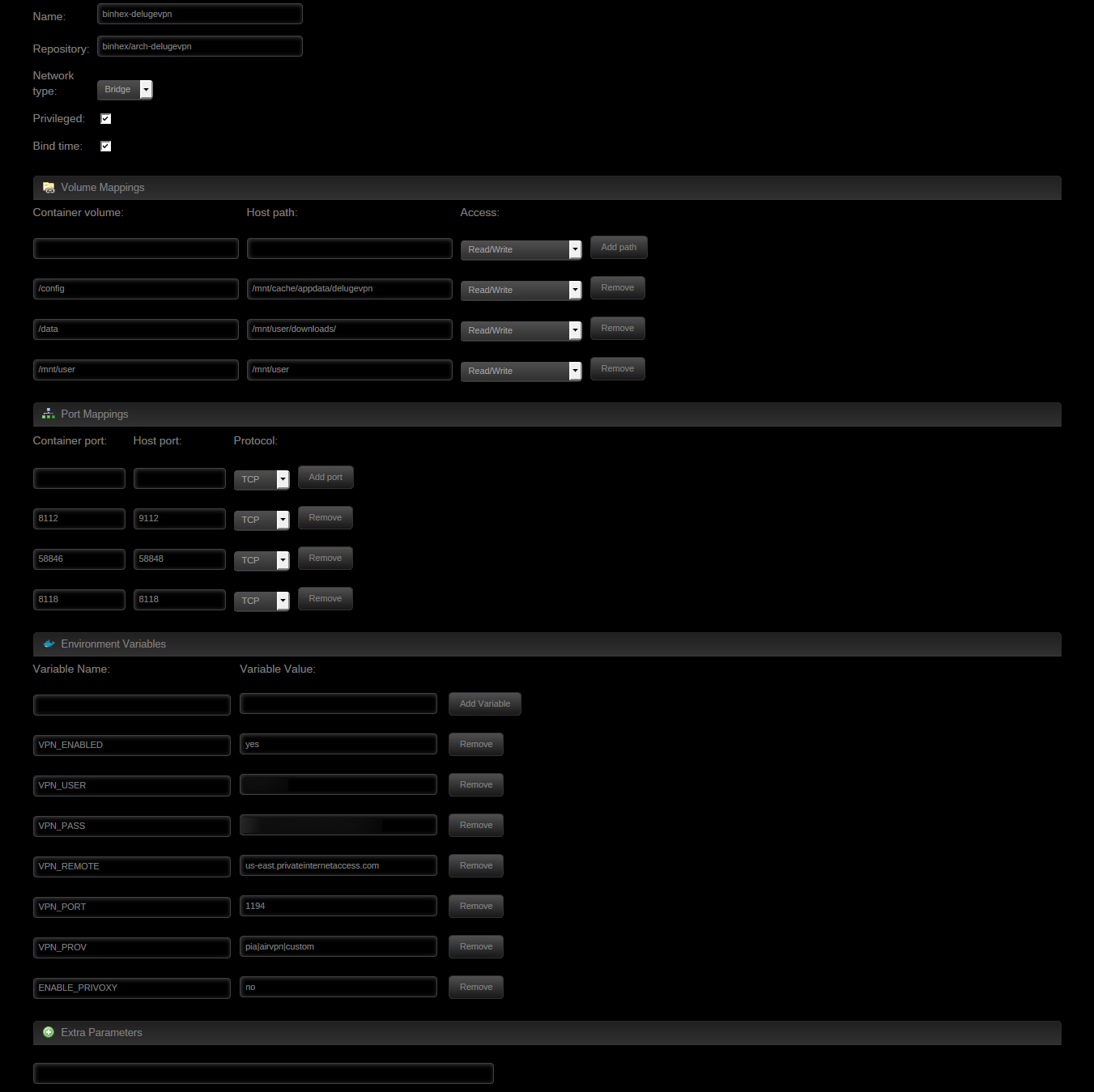

sadly, I cannot get the docker to load/connect.  Even with the new login/pass, it still just fails to connect to the docker GUI.
I'll try without the vpn enabled to see if that's an issue.
removing the vpn setting and the proxy setting (changing both to "no") allowed me to get into the deluge page and complete the basic setup.
I went back and re-enabled the vpn, confirmed my user and password are correct (using the new info), but now I cannot get into the webgui again.  I used the same password to login to the PIA control panel on the website, so I know I'm using the correct login into in the docker setup, but it just keeps failing to connect.
ideas?
ideas?
yep ive spotted the issue from your screenshot, for the vpn provider you need to choose between airvpn, pia, or custom, you currently have it set as default value which is "pia|airvpn|custom", change that to be just "pia" save and you should be good.
changed it to just pia, saved it, but still cannot connect :(
I've tried
IP:1194 (the VPN port from settings)
IP:58848 (changed slightly to not collide with the other deluge container)
IP:9112 (my port selection to keep in line with my other dockers)
IP:8118 (the proxy port)
IP:8112 (just to see if it worked)
none allow me to connect with VPN turned on.
if I turn off VPN, but leave the proxy set to yes, I can get to deluge at the IP:9112, but not either of the other 2 ports
Not sure how I got it so messed up, but it seems I'm not doing it right :(

Actually I think it was when I changed from network type: bridge to host that caused the issues.
yeah, thats not a good move, keep in mind sabnzbdvpn and delugevpn both have a vpn tunnel running, not to mention some iptable rules to block traffic, if you switch the networking from bridged to host then you could cause all sorts of issues, short story is always keep these dockers as bridged.
ok so once youve switched it back to bridged, if your still getting an issue, which im assuming you will, then please post the contents of your .ovpn file (located in /config/openvpn/) and the contents of the supervisord.log file (located in /config).
