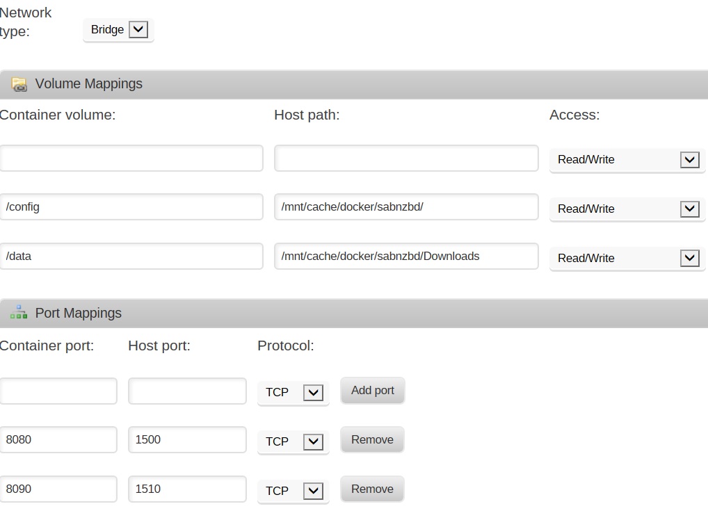

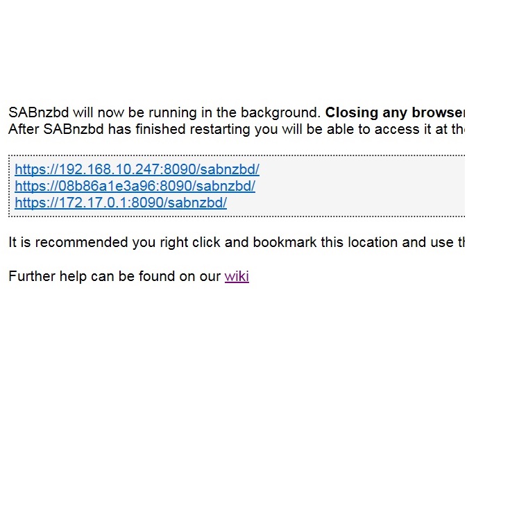

I may have messed things up. I added the sabnzb, using settings in the picture. I then accessed sab quick setup through server-ip:1500. After finishing this I was greeted with a screen like in the other picture. Why does it come back with this address through htttps and port 8090? Now while I still can access sab through http and port 1500 but I can not disable https in sabs general setup. I tried this several times, saving it and restarting sab, bit it always comes back with https enabled. I also can not set any paths like /mnt/user/nzb. Did I do something terrible stupid? Is it still fixable? Or is it better to remove the docker and start all over again?

The ports that Sab shows you is always going to be 8090.  You have to remember that within the container it is using ports 8090.  External to the container you access it through 1510 which docker "translates" to be 8090

I initially accessed and configured sab through port 1500/8080. And it came back with port 8090 as shown in the picture.
it will do, sabnzbd does not know your running docker, and is not aware of the port mapping from port 1510 to 8090, so when you restart sabnzbd it will always restart on the port IT thinks you want to talk to it on, which is by default 8090, in reality though the port YOU want to talk to sab on is port 1510, clear?.
But I don't want to use port 1510/8090 because this uses https. I also can't disable https in sabs configuration, whet I try to disable it, save it and restart it comes back with https enabled. I never used https in the plugin version, why should I now?
nobody is saying you HAVE to use SSL, this is just an option which is available to people who wish to use it, if you want to connect over straight http then in the unraid docker ui specify under port mappings the host port you want to use that maps to container port 8080 and then connect to sabnzbd ui using that host port instead, in your case thats port 1500, forget about 1510, its of no consequence that's its accessible on that port also, it most def isnt a security concern as SSL is, as im sure your aware, infinitely more secure than unencrypted http.
the reason you cant switch ssl off is because this is turned on via command line flag at startup.
edit - option if you NEVER want to use SSL is to delete the port in unraid docker webui, so just have the single port mapping left that maps container port 8080 to your host port, that way there is no chance of connecting via SSL
Still not working. I have removed the port 8090 and have only mapped 1500/8080. Still after sabs quick setup it comes back with https and port 8090. I also can not disable https in sabs general sonfiguration.

So after the wizard has finished if you go to http://unraidip:1500 you can access the webui, yes? If so then your set.
Regards can't disable SSL, "The reason you cant switch ssl off is because this is turned on via command line flag at startup."
It also can't create the incomplete folder under Downloads or other folders on the array.
What folder are you specifying in sab for incomplete? It should be something like /data/incomplete
