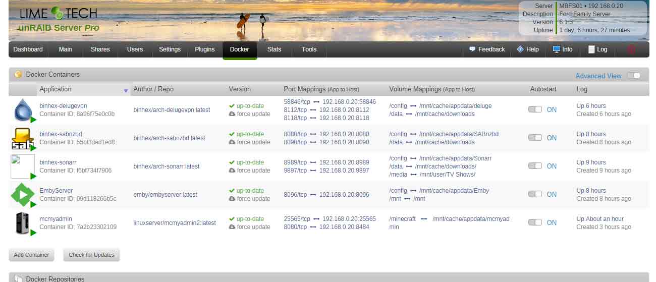

A Tiny request - could we fix the image for Sonarr pretty please :-)
No doubt I will be back shortly asking lots of other N00b questions!
Thanks :-)
im going to need a bit more info than that :-), i wasnt aware it was broken, what are you seeing that makes you think its broken, can you post your supervisord.log, please give me as much info as possible, the more info i have the more chance i have of fixing any potential issues.
ahh ok that makes more sense, so your using another user account and thus need the last octet set. ok i can put in some code that should force couchpotato to use umask 000, not sure if this is the underlying issue or not but it wont hurt, watch out for an updated image.
Thanks binhex, downloaded the update, works a treat now! Much appreciated.

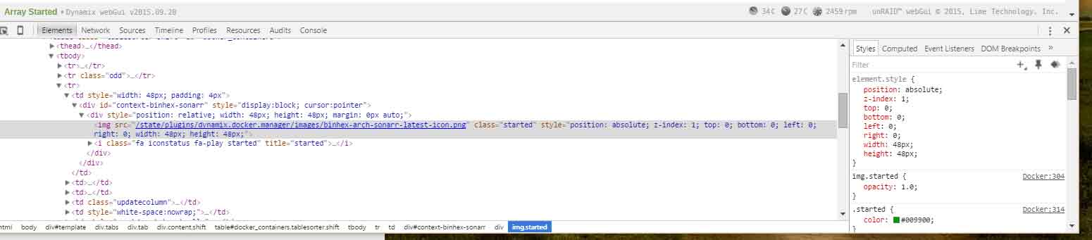

Thanks :-)
NP everything else works perfectly - Deluge VPn, SABnxb etc anyhows
1 - Screenshot
2 - Another Screenshot
3 - the log is to big to post let me go try something else...
Thanks :-)
1 - Screenshot
;D ok so when you say there is a problem with the image, you mean the icon, ahh i now understand, i would try and not use the phrase image in future, as the word image is used a lot to signify the created docker application :-), thus the confusion.
ive seen a missing icon a few times and its a bug somewhere in dockerman, for some reason it doesnt always copy across the icon and thus you get the ugly broken icon symbol, i can confirm the icon does exist and is correct in the xml and does indeed show up on my system. you can try a reboot of your system, that should force it to copy the icon to the correct location.
