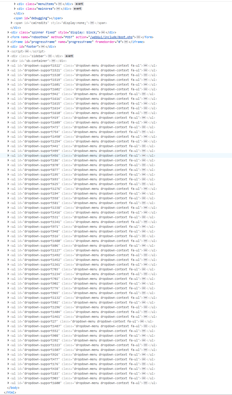

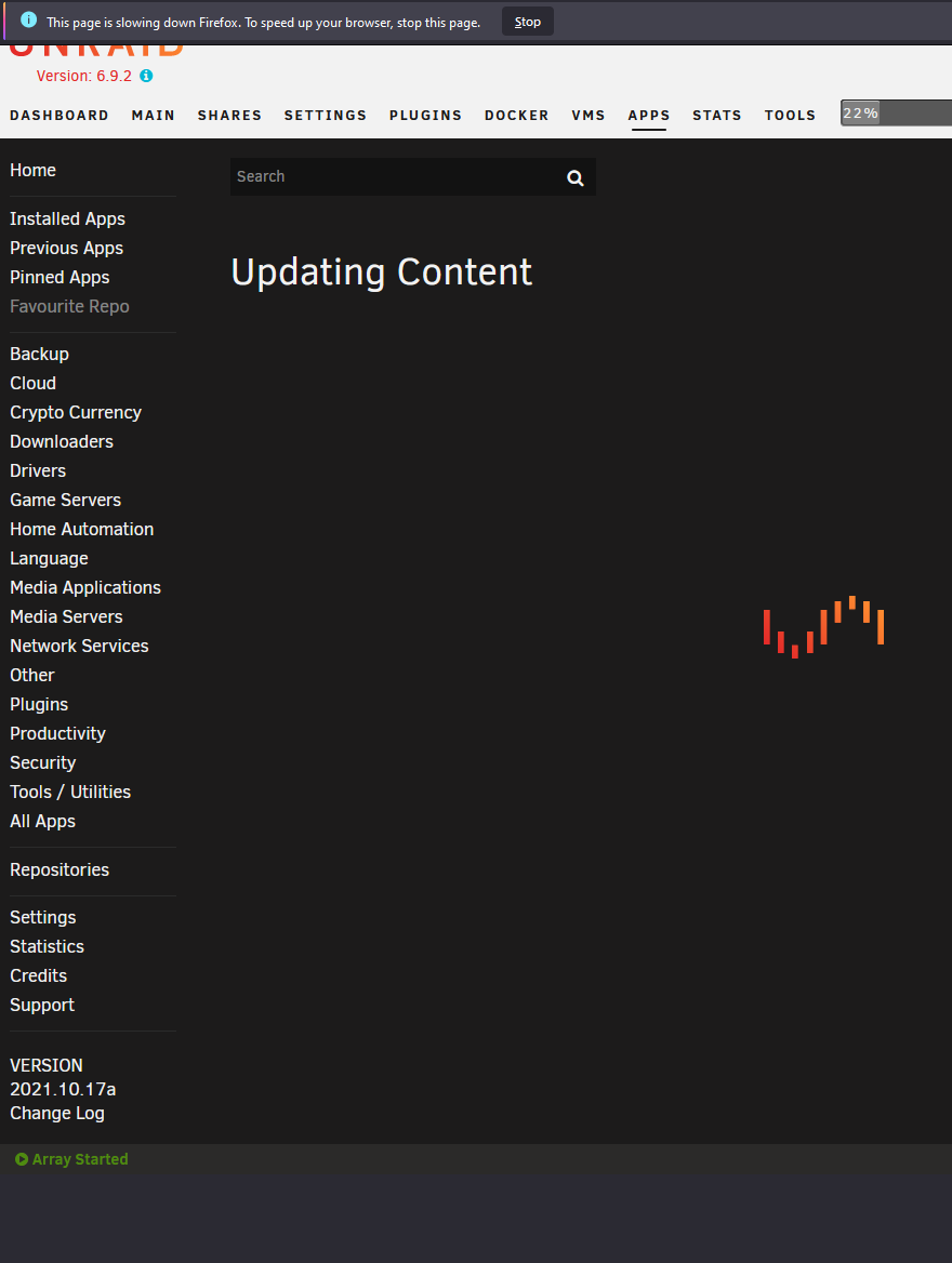

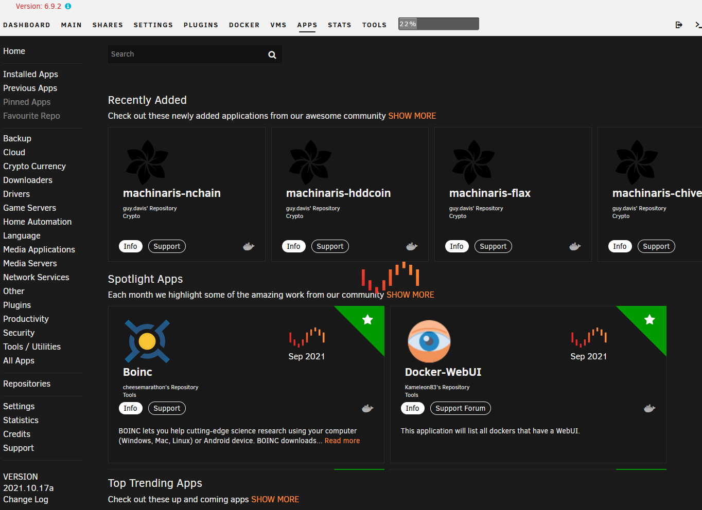

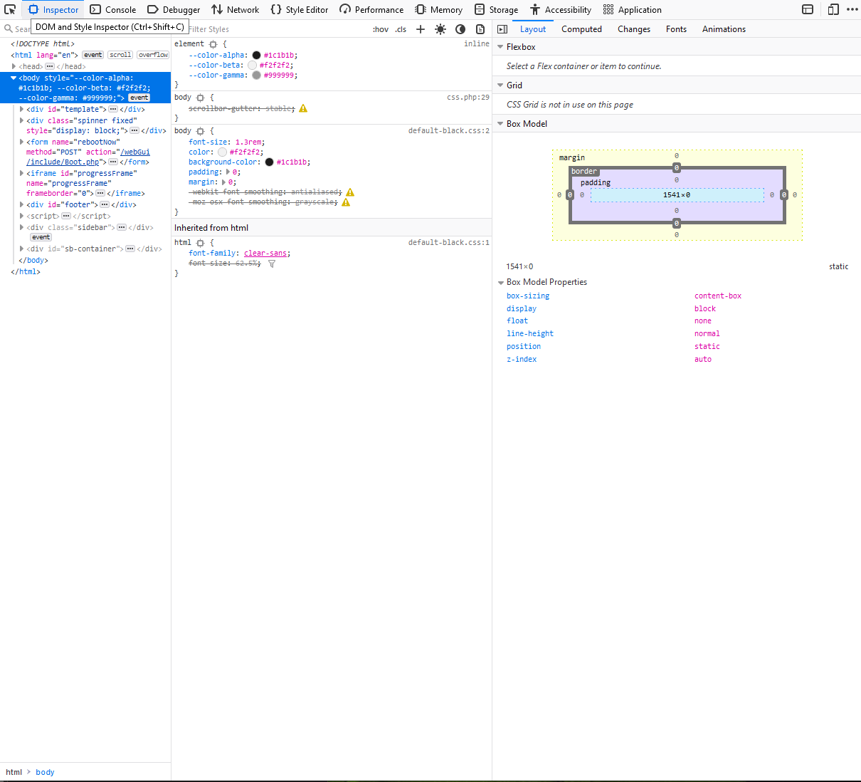

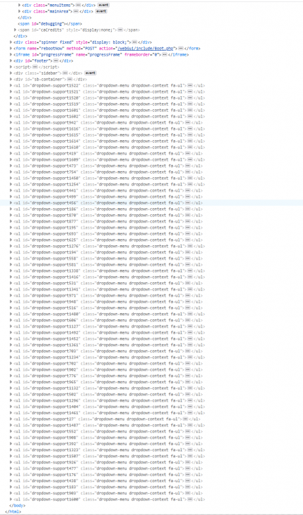

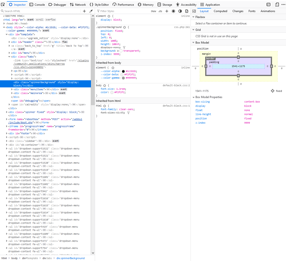

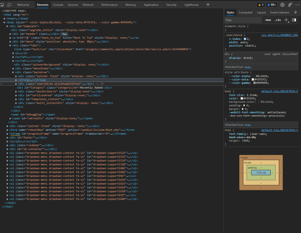

20 hours ago, Squid said:
That’s interesting if only because it says where the problem isn’t.   CA’s diagnostics are a pain to get at if the spinner doesn’t disappear so tomorrow I’ll issue an update to rectify that and we’ll see where the issue lies.   In the meantime I’m curious though what happens if you load up CA in edge and then immediately try it again in Firefox.
Pulling it up in Edge and then immediately in Firefox still hangs the FF tab.  However, if I click "Stop" on this prompt
it loads the page half-way, but the spinner still keeps spinning and I can't interact with the rest of the page:
I can then go to Inspector:
I compared it to inspector in Edge:
There are WAY more "dropdown-menu" ULs in FF:
