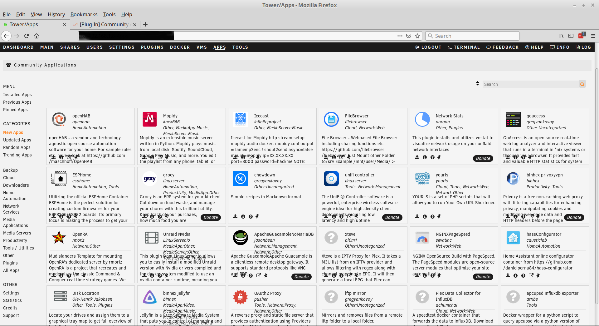

The description text of many apps are over the icons.
Unfortunately I can't install a lot of apps because I can't click on the icons that are under the text.
I'm using Linux Mint Cinnamon 18.3 with Firefox 65.0.1 (64-bit).
I already tried to zomm in and zoom out but it didn't solve the problem.
Edited by Trapizomba
What version of unRaid? Can you try a different browser?  I can't replicate via Firefox running on a Windows box.
unRaid 6.6.7
Works nice with Chromium Version 72.0.3626.119 (Official Build) Built on Ubuntu , running on LinuxMint 18.3 (64-bit)
On 3/6/2019 at 7:07 AM, Trapizomba said:
unRaid 6.6.7
The way it seems to me is that your version of firefox isn't rendering anything correctly.  The only way you should be able to see 6 columns when you're on at maximum 1920px across is either setting the zoom of the browser very small or setting the dynamix font size to be very small AND a zoom level very small
In your case, it appears that the font-size is relatively a normal size and the zoom is more or less normal, but your browser is deciding to ignore the box sizes I've specified which it does not do on a Windows platform (nor any other browser I can throw at it or Safari on a Mac, or my phones / tablet's browsers)
I'm on Mint Cinnamon 19 with the exact same version of FF and it works fine. I'm confident it's an issue specific to your system, not something @Squid can fix.
