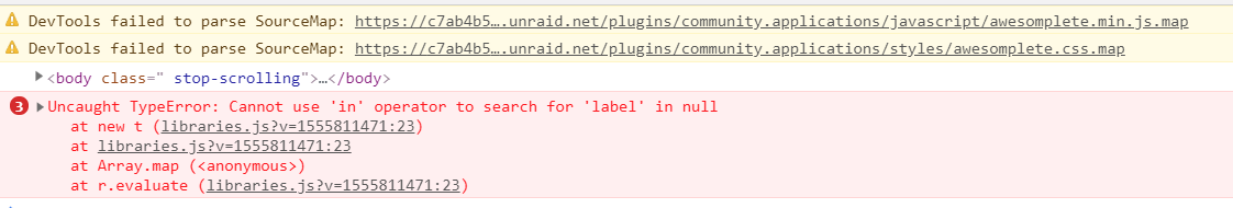

Hey guys. A quick search didn't yield anything. Has anyone noticed in the last few versions of CA, that the auto-complete in the search box no longer works? I've disabled all ad-blockers and browser plugins. Tried in both Chrome and Firefox and nothing. The changelog makes note of a few autocomplete changed but nothing about it being removed. Is this a widespread issue or just me?
Is it on a particular screen, or always?

It's on the main Apps page. I opened up Chrome's dev tools and see this in the console (hope this helps). The error comes after I type in "beet" (no pressing Enter).

Just tried on fresh installs on Chrome, Firefox, Edge, and Brave.  No problems populating the autocomplete
I removed then re-added CA and all works fine now. Thanks again for checking, and thanks for the great plugins!
