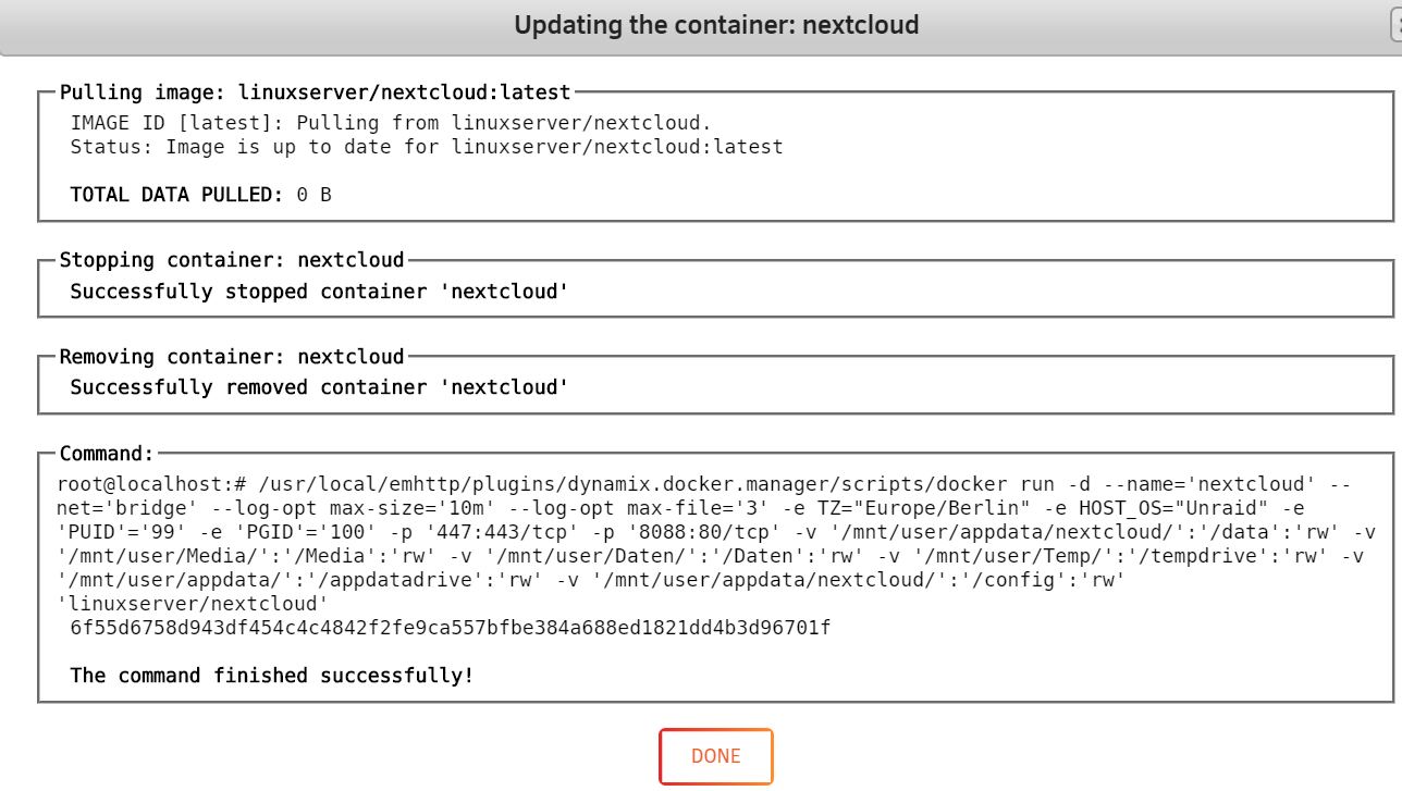

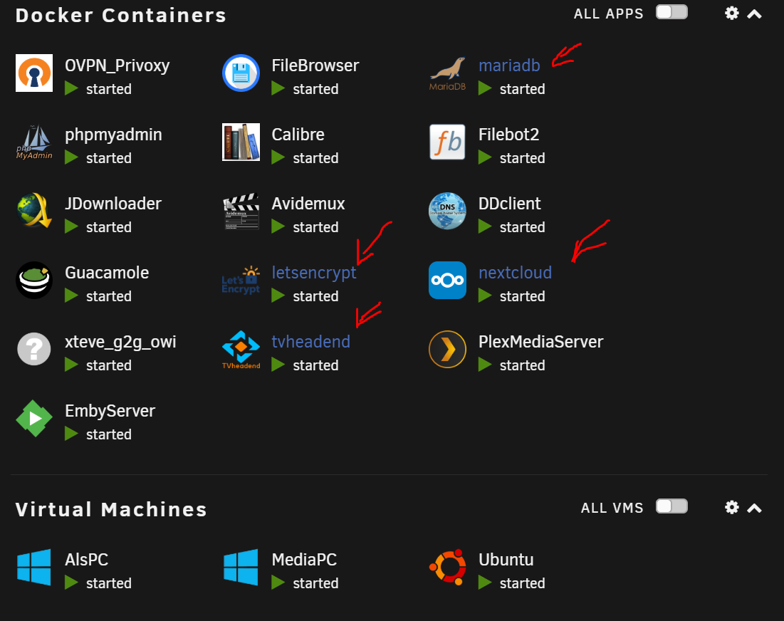

g morning, since tha last CA Apps update it seems there is something weird with LSiO Dockers, always showing update available even
all updates are done.
when i then say update all it also pulls 0 byte and just restarts docker.
when i then again say check for updates lsio dockers are all available again ...
no big issue, just wondered ...
sample when updating
Definitely nothing at all to do with CA

If it helps, the last few days I've run morning updates, its tried to reupdate other containers.  For example, I've had alerts for three updates, so I go to the docker tab, click update all and more try to update (which were updated over the last few days).  From memory those that are duplicated do little more than attempt then restart, but I'll log it the next time.  If it's not related, I'm sorry.
The update available thingy has nothing to do with CA at all.
Fair play, cheers
