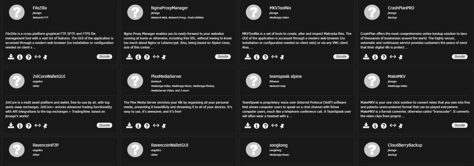

July 10, 20197 yr On 7/3/2019 at 5:42 PM, MarkRMonaco said: Not sure if anyone ran into this issue, but right after installing and configuring Pi-Hole (Docker), icons on the unRAID apps tab are getting blocked. - Does anyone know the correct domain or sub-domain that needs to be added to the whitelist? I know on my Docker I build the app icon turned into the question mark icon when the raw image url hasn't changed.
July 10, 20197 yr On 7/7/2019 at 11:21 AM, Squid said: FYI for anyone else (since its a seemingly minor problem) is that you would not have been able to install or update any plugin while it was in that state. I am not using Pi-hole, and my recently updated Docker-template without changing the app icon location, has turn the app icon into a question mark on the Community apps screen. https://github.com/paulpoco/docker-templates/blob/master/paulpoco/delugevpn-flexget-dev.xml
July 10, 20197 yr Author I am not using Pi-hole, and my recently updated Docker-template without changing the app icon location, has turn the app icon into a question mark on the Community apps screen. https://github.com/paulpoco/docker-templates/blob/master/paulpoco/delugevpn-flexget-dev.xml It's something happening in the app feed I'll check it outSent from my NSA monitored device
July 11, 20197 yr Author 8 hours ago, Paul_Ber said: I am not using Pi-hole, and my recently updated Docker-template without changing the app icon location, has turn the app icon into a question mark on the Community apps screen. https://github.com/paulpoco/docker-templates/blob/master/paulpoco/delugevpn-flexget-dev.xml Fixed. Technically, it was a quirk of GitHub where if you change a file / folder only by the case (which is what happened due to you changing dev to Dev, the cached icon for the feed was uploaded to a different folder which the CA knew about, but GitHub never actually changed the case, so it was giving a 404). Switched the cache to instead be completely lowercase all the time.

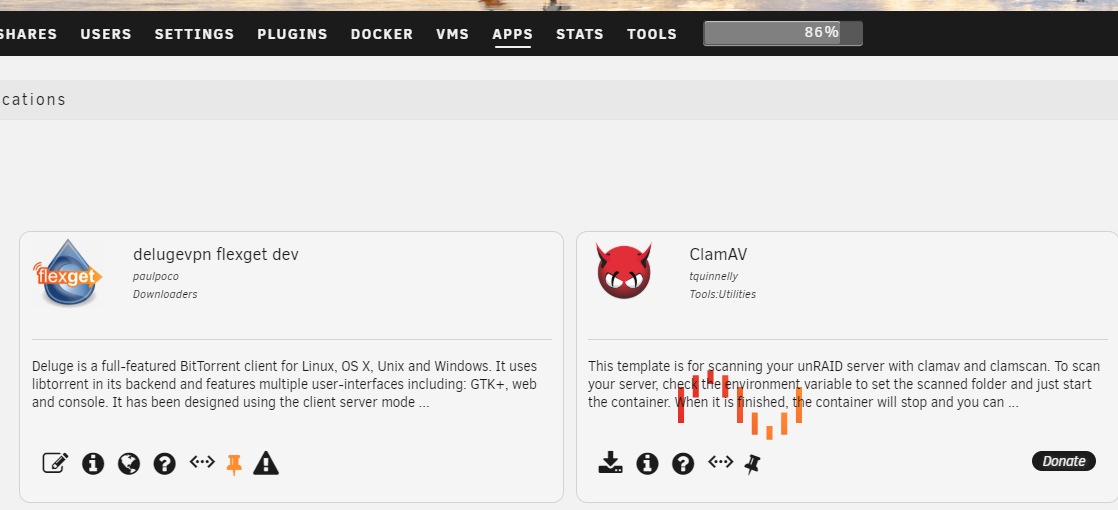

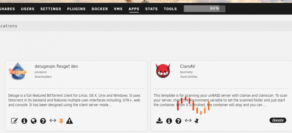

July 11, 20197 yr Bug Report: APPS tab --> Pin/Unpin ---> whole website freezes while the Unraid animation occurs.
July 11, 20197 yr 35 minutes ago, Paul_Ber said: Bug Report: APPS tab --> Pin/Unpin ---> whole website freezes while the Unraid animation occurs. Works fine for me. What browser/OS/etc? Nevermind. I see the same exact behaviour after applying the latest CA update. Firefox 67.0.4 Linux Mint Edited July 11, 20197 yr by jonathanm Updating broke it.
July 11, 20197 yr 9 minutes ago, jonathanm said: Works fine for me. What browser/OS/etc? Nevermind. I see the same exact behaviour after applying the latest CA update. Firefox 67.0.4 Linux Mint Windows 10 64bit Chrome 75.0.3770.100 14 pinned tabs plus usual 6 or more. I am CPU/GPU mining on this PC, maybe that animation uses lots of CPU/GPU. I never have an issue browsing, even fine playing a YouTube video.
July 11, 20197 yr Happens using Win10 OS with Edge using Chrome Engine Dev branch too. Nothing else running on my desktop, so it's not cpu intensive on the client.
July 12, 20197 yr I came back hours later, browser wasn't frozen but the animation was still going. After upgrade no freezing. Should the animation be over top the App you are pin/unpinning.

July 12, 20197 yr Author 14 hours ago, Paul_Ber said: Should the animation be over top the App you are pin/unpinning. No. It's centered on the display. It appears every time the browser makes a request to the server.
