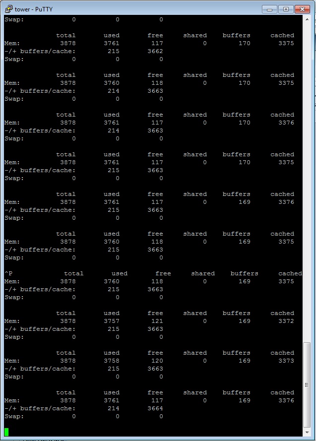

Hi guys,
I have a memory leak issue I can't get to sort out.
Summing up, the installation is done in an SDD drive outside of the array mounted on system startup with SNAP. I symlinked the /usr/local/crashplan and /var/lib/crasplan directories to the SSD relevant directories.
I'm backing up my Win 7 desktop to unRaid and everything seems to work fine. The backing directory is /mnt/users/crashplan.bak and is actually located on disk3 of my array. I can see the size of this directory grow as the back up goes, so my assumption is that it 's not writing to RAM.
During back up I'm monitoring RAM usage with free -m -s 5 and I can see the cached section grow until I run out of memory and CrashPlan then crashes. For what is worth, I have 4GB and standard use is around 500 MB before starting back up. Then cached memory grows, free memory shrinks and finally system crashes.
BTW, if I run echo 3 > /proc/sys/vm/drop_caches, the cached memory drops up to around 300MB, but then starts growing again, so the story goes.
Any ideas?
UPDATE:
It's been running all night without crashing but memory cached remains stable at 3,370MB and buffers at 172, leaving just 120MB of free memory. Is this normal? My back up is at 50% and running. I didn't runt this time the memory flush and I'll report if either it crashes before finishes or how the memory usage behave after completion
Backup finished ok with cache memory usage above 3300MB. I googled it and looks like the cache memory is actually a functionality of linux... so you all know now I'm a complete newbie  :-[
I don't know why the crashplan engine crashed after first installation, but it looks like it's running fine now. Not that is important, but any idea?
BTW, 3h after finishing back up cache memory hadn't drop a bit so I run a cache memory flush with echo 3 > /proc/sys/vm/drop_caches to check what would happen. Surprisingly (for me), it didn't grew back... I have some questions though:
1. is this safe to run this command?
2. why while crashplan was  backing up cache memory grew above 3GB but it doesn't grow now that crashplan is iddle? (engine is still started)
3. why it didn't reduce the cache footprint when it finished?
4. and most important, should I add a cron job to periodically clear the cache memory?
thanks guys,
daniel
I've not 100% thought through your problem - so I'm just throwing this in off the cuff but I think the response is sensible.
The kernel will use memory as a filesystem cache where it can, so having all your memory used is normal. What is more important, as you've found, is to see how much of the memory is actually in use by the kernel and processes and how much is in the cache.
I can't answer that from the info you've given. Even though you've already looked into it this is almost exclusively caused by something writing to RAM somewhere. If you've ruled out your actual backup target (and make sure your /mnt/users/crashplan.bak is *really* physically ending up on a disk) then check also any logfiles, crashplan cache files etc too.
1 - Yes it's safe, though you may see a performance hit in the short term and more disk i/o than expected in the mid term. You will definitely notice if you're running the cache_dirs script.
2 - At a guess simply because there isn't much disk i/o when it's not backing up? So nothing further to cache. It will keep what its already cached / recycle the cache with new data as necessary. There is also a cap on how much cache it can use as it won't (/shouldn't) displace active memory being used by processes. i.e your cache usage can't keep growing it has to stop sometime.
3 - If it doesn't need the memory for anything else why would it? There would be no efficiencies in caching the data if it purged it from memory as soon as it was finished caching it. As above it might not be the same data in the cache though you'll find - relative to the memory needed by your running processes - the amount of cache memory should stay as high as possible. This is normal and good.
4 - Only if you want to forcibly reduce disk performance. I can't think of a reason you'd want to do this unless you find the memory scheduling done by default by the kernel isn't working in your particular usage. I'd find that scenario, for anything you could do with unraid on it's scale, unlikely.
The kernel will sort it all out. Perfectly normal to have all your memory in use including cache. Linux will drop stuff out the cache if it needs the memory for real processes.
