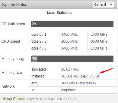

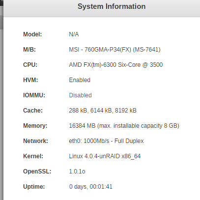

Memory reporting has a glitch. Shows Max allowable ram as 8GB. Upgraded to 16GB (actual max for this mobo) today and still shows 8GB as max. All 16 are seen both by hardware & unRaid.
Have you tried 6.1-RC series? I think there was a bug similar to this fixed in there.
Just updated to 6.1-rc2 and the "Info" popup is right but still wrong on dashboard page.
Memory: 16384 MB (max. installable capacity 16 GB)*
