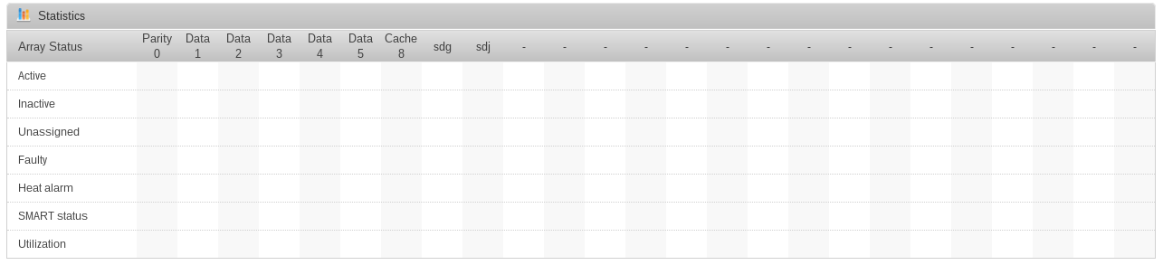

I'm wondering what has caused the Statistics section of my Dashboard tab to become empty.
It was empty before a power cut this morning and it is still empty after the reboot.
