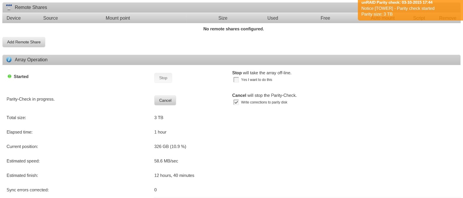

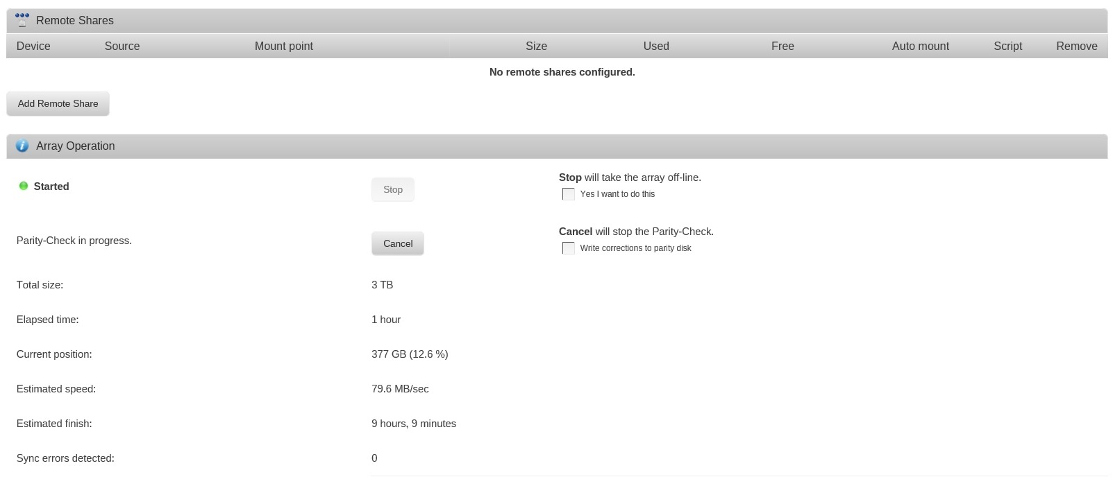

i make 1 hour parity check tests with 6.1.3 and 6.1.2.
Docker disabled, VM disabled, cache dirs disabled, no webgui, no usage.
But i realize that i forgot to uncheck write corrections at 6.1.3 test does it affect speed?
Results:
6.1.3: 326 GB(10.9 %) average: 92,7 MB/s
6.1.2: 377 GB(12.6 %) average: 107,2 MB/s
i will try to retest 6.1.3 with nocorrect and other versions when i find some time.
Although 92 MB is a fair speed there has to be some explanation about 15% slowdowns background. And it is odd that Frank1940 not having this slowdown issue since we have pretty much same hardware. Maybe it is related with SASLP or it is related with me :)
