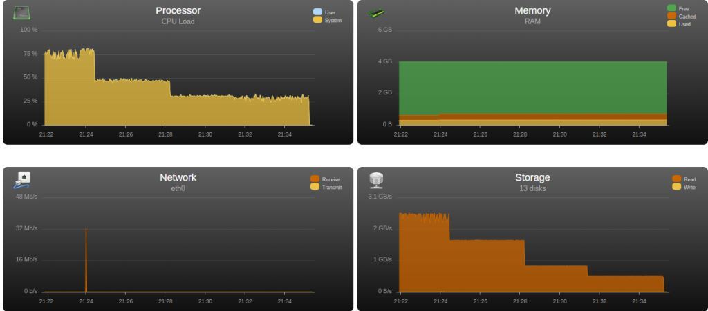

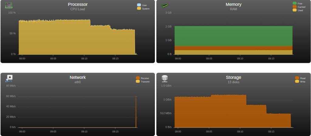

Hardware used:
Server 1 – Supermicro S9SCL-F, Celeron G1620, 4GB DDR3
Server 2 – Supermicro X7SBE, Celeron E1200, 2GB DDR2
Common hardware: 12 SSDs (4x32GB+4x80GB+2x120GB+2x180GB) on Dell Perc H310 and Adaptec 1430SA
To keep tests as accurate as possible they were done on a clean Unraid install with the WebGUI closed during the check, only plugin installed on v6 was dynamix system stats but not used during the tests on server 2 because it impacts performance (about 5 to 10Mb/s), it does not impact performance on server 1 and I it used once for a second pass on server 2 for the screens below.
Average speed for a full parity check (MB/sec):
                    Server 1 –  Server 2
V5.0.6    -    223.1    -  182.8
V6.0.0    -    223.7    -  167.9
V6.0.1    -    223.9    -  173.6
V6.1.0    -    223.7    -  167.9
V6.1.1    -    223.9    -  173.3
V6.1.2    -    224.5    -  172.9
V6.1.3    -    224.2    -    173.8
For low power CPUs there’s a small hit going from v5 to v6 but I can’t find any significant difference in the V6 releases, naturally this does not mean that there’s not an issue with some specific hardware, but anyone experiencing it should try to pin down in what version starts to occur and post the hardware used.
Screens below are a sample from each server, slowest one with V6 can still do 100Mb/s+ when reading all 12 disks which I find pretty acceptable for a dual core Celeron @ 1.6Ghz. Expect slower performance for servers with similar CPUs and more disks.
The main conclusion has to be that there are no general software defects introduced into unRAID, related to parity check performance.  (Thanks Johnnie!)
                    Server 1 –  Server 2

Hardware used:

Nice test => the low-powered server shows almost exactly the same amount of degradation that mine does with the settings I used in my last test of this ... i.e. about a 6% reduction in speed.
6% isn't all that bad (much better than the 31% I saw with my first test before adjusting some settings) ... but nevertheless I don't understand what might have changed to cause this.    It's also resulting in VERY high CPU utilization during the checks ... something that was not the case in previous versions.    The CPU demands of a GUI don't account for this, as these tests were done with no GUI loaded and (at least in my case) the "disable updates during parity checks" box checked.
It's pretty much in the "no big deal" category, as any new systems I build will have CPU's with at least 8-10k Passmark ratings, but it's nevertheless frustrating that a simple NAS function like a parity check is now maxing out the CPU even if there are no other add-ons in the system.

can you tell us which process are eating almost all CPU?
The 2 processes used by Unraid during a parity check: unraidd and mdrecoveryd
