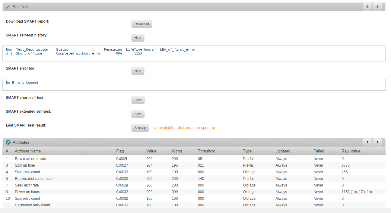

Hi boniel, thanks for your great work - we nearly have it! :)
What is working now are all ports, so this is the first time I could show the SMART values of all disks that are attached to my RAID controller - very great!
What also is working - beside the SMART details - are the self-tests! I can start them and see the result - worked on all disks (did a short test on all disks). Also great!
One very last thing: See attached screenshot - the place at "Last SMART test result" still shows "disk spun down" instead of the last smart test result which obviously can be seen correctly in the history. (The other details below are capped but all valid!) So perhaps "disk spun down" should only be shown when the disk really is spun down and not when the state is "unknown". So same case as with the self-test buttons that all work now :)
So except of this, everything else is working very perfect now - I have to say a big thanks!!! A really big one :)
