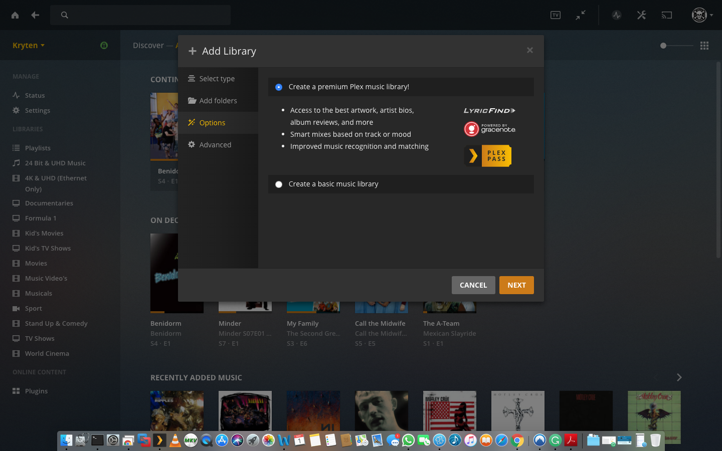

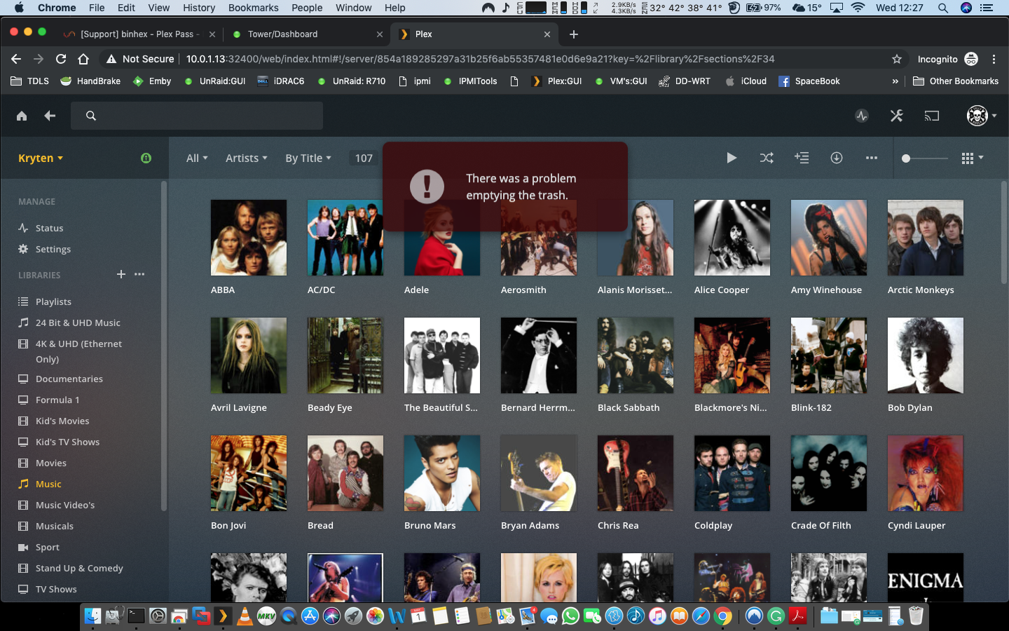

Hi really need some help I have the latest docker plex-pass I added a new library Music, No problems slowly started adding media and it works amazingly but as I add more it doesn't pick up the new files. I have deleted said Music library but it's still there So I moved the entire folder out of the Plex folder deleted again But still there. Iv shut the array down rebooted the Server Still there Optimised database, Cleared bundles but now it won't empty trash... I have attached logs. why won't the deleted library Go? this is the 3rd time iv tried adding a music library all the Music is OK as its from iTunes and all is correct iv checked.
Is this an Unraid issue, Plex issue or Docker
Regards
Lee
Plex Media Server Logs_2019-04-30_10-58-20.zip

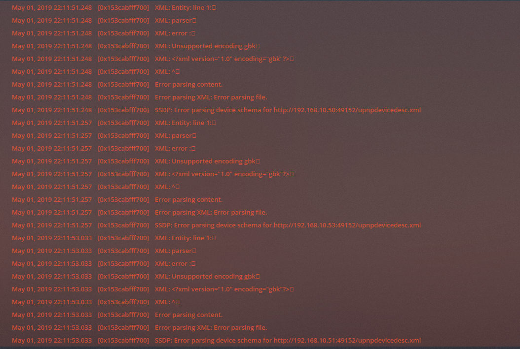

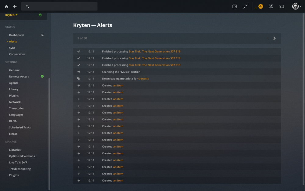

HI i really need some Help!
I recently added a new library Music! i have been adding music from my iTunes. Most items have scanned and work ok but iv added Liam Gallagher its the same as all my other files .mp3 and works fine elsewhere iv added all of led zep also but when i click scan library files it circle spins for about 5 seconds and stops. I have tried to delete the library but it remains, i am unable to empty the trash also. i have attached log's etc. It just randomly stopped scanning newly added folders. I know these files are all ok as used them on Plex previously  Please any help would be much appreciated.
Plex Media Server Logs_2019-04-30_14-26-56.zip

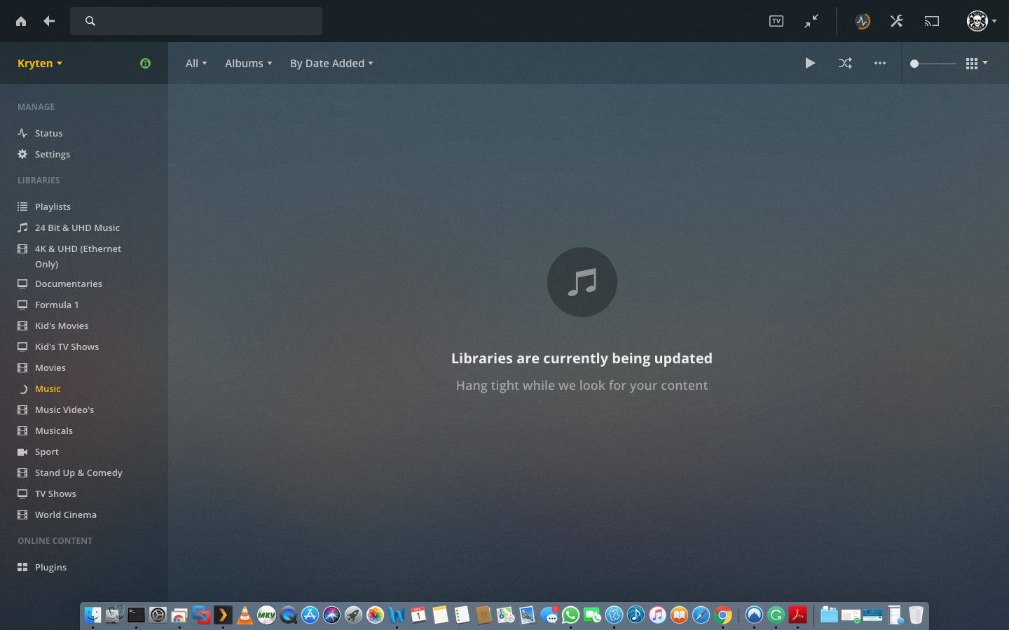

i dont know what this means tbh, bundles? trash? is this in plex right?.
i would suspect your issue is bad metadata for some of your mp3's, try and identify which albums/tracks are causing the issue and move them out for the time being, then re-scan in plex, once everything else indexess in ok then you need to look at the mp3 tags (metadata) and possibly wipe them and re-enter the tags, try wiping and re-entering metadata with a couple of troublesome mp3's first then add them back into plex, if they scan in ok then proceed to do the rest.
best tool for removing/adding tags is mp3tag:- https://www.mp3tag.de/en/download.html
i would guess this is a failure of plex to cope with badly formed mp3 tags and thus it stalls on the first dodgy file and the scan then stops for all subsequent files also, from what you have described i would very much doubt this issue is unraid or docker specific.
I have moved the folder Music out of the Plex folder and re scanned all the albums are still there but says files are missing, i click delete library Music i get the check box i tick it and click delete but nothing happens. Iv re started the plex docker and re started the array

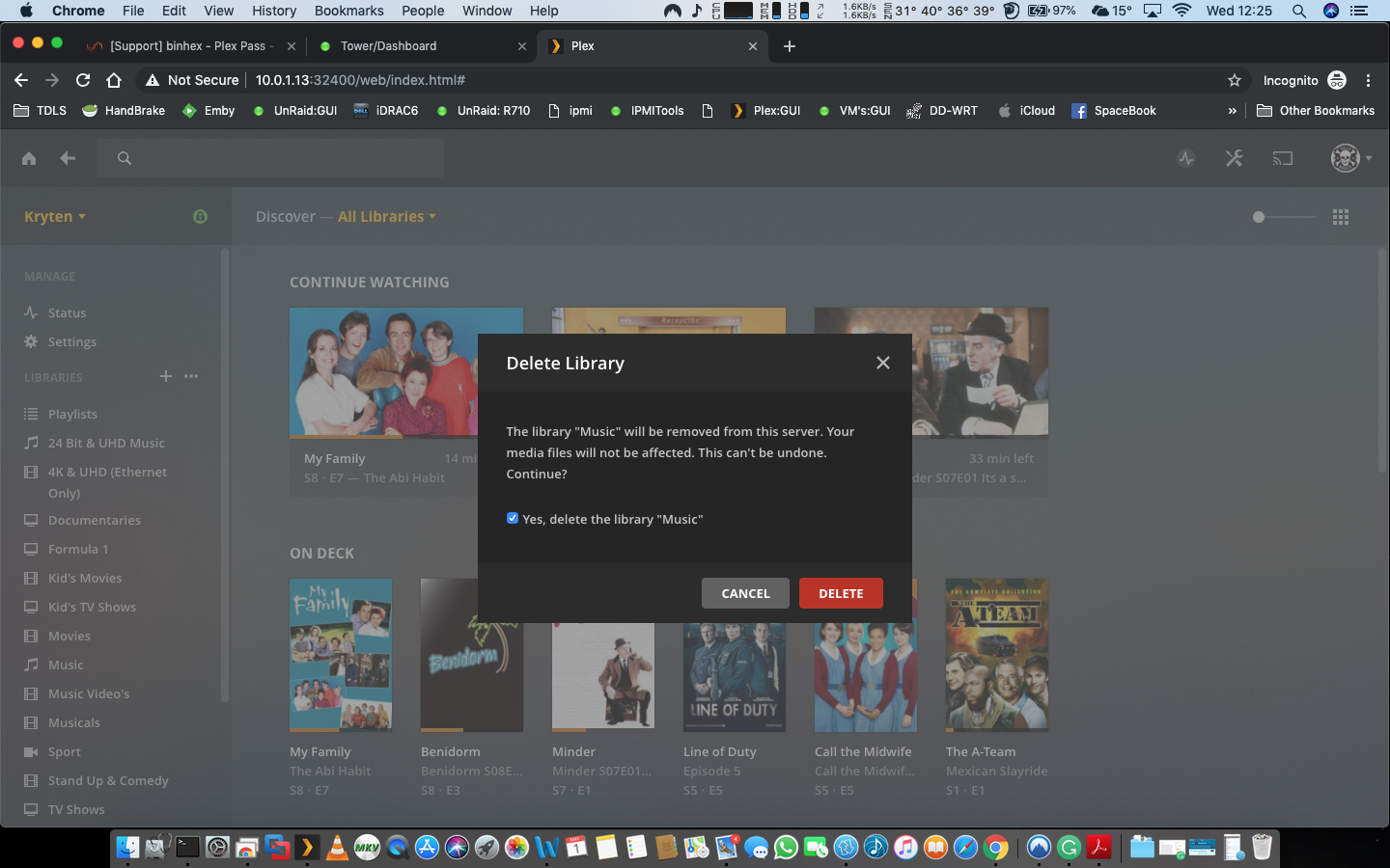

have a look at this article, the deletion through plex looks scary, with the possibility it will delete not only the metadata but also your media!, watch out for this.
https://support.plex.tv/articles/202606363-how-do-i-delete-something-from-my-library/
Hi Bud
Yeah i copied the media from my iMac so if it goes it goes but i have many backups, Like i say i have moved the Music folder out of plex folder iv refreshed the library etc But the albums remain but with no files. I have tried to delete the Library Music but it just wont go. have a look at the screen dumps  ... Delete Library, Tick box clicked delete All still there after refreshing
I hate not understanding whats going wrong and the web has been no help So i thought i would try your expertise
Many Thanks .

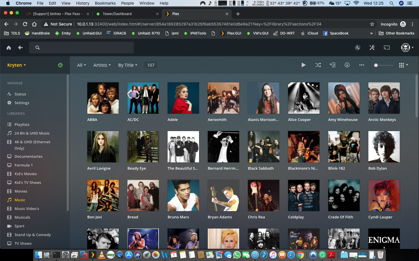

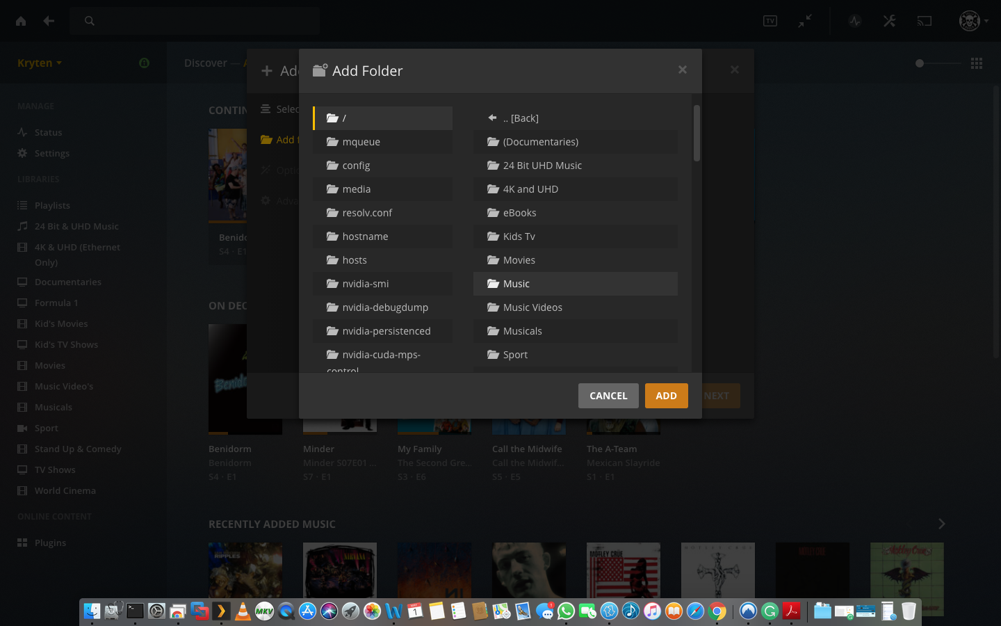

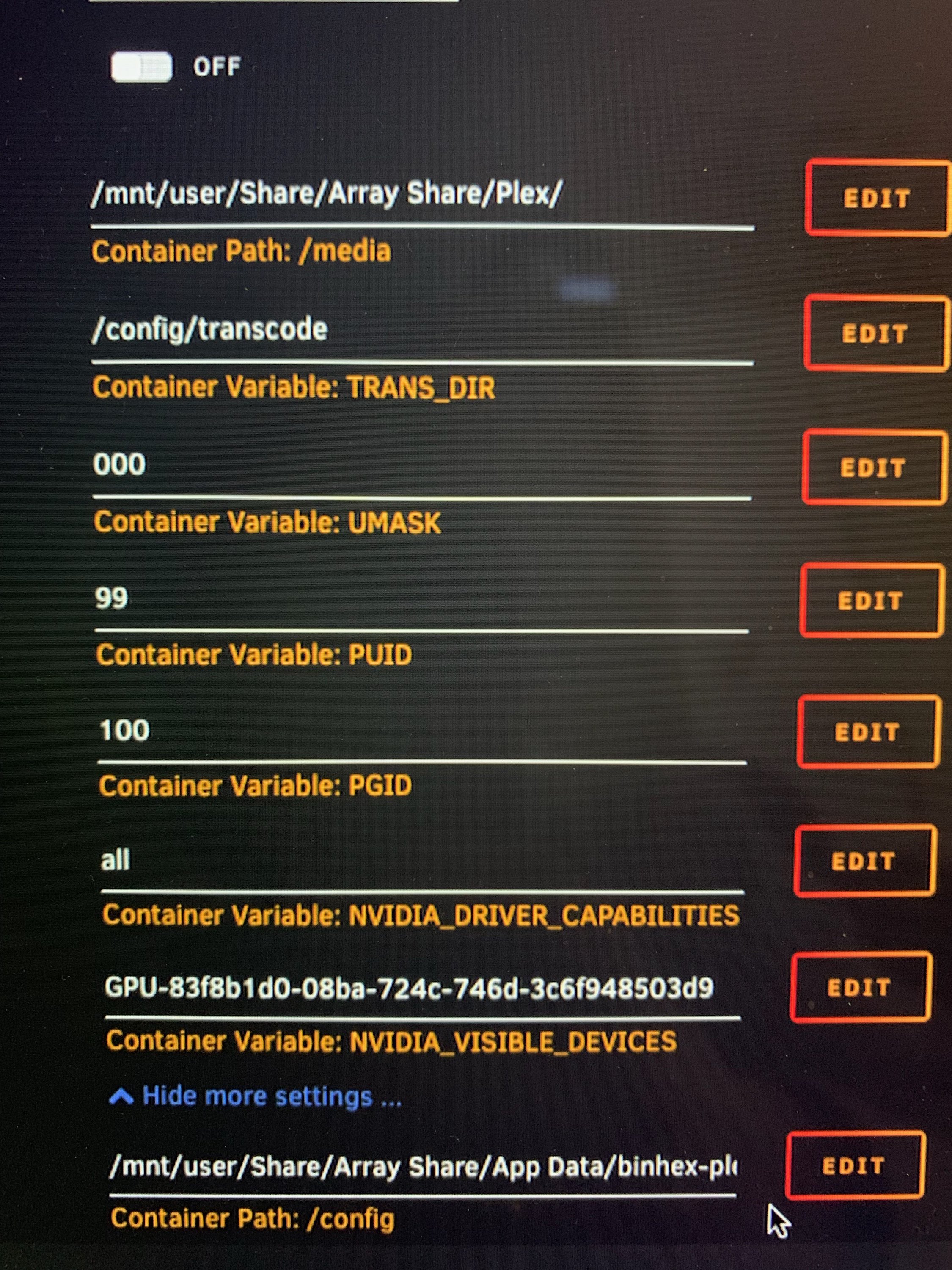

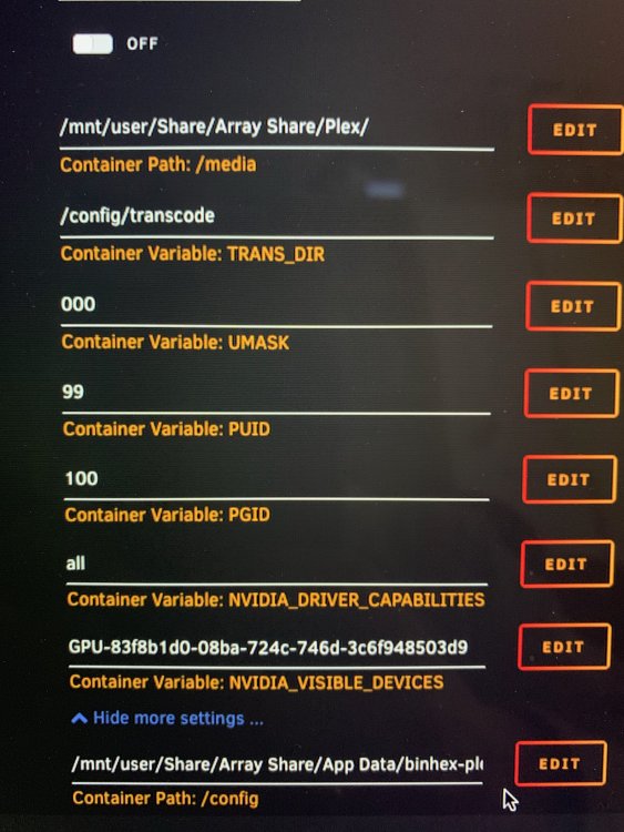

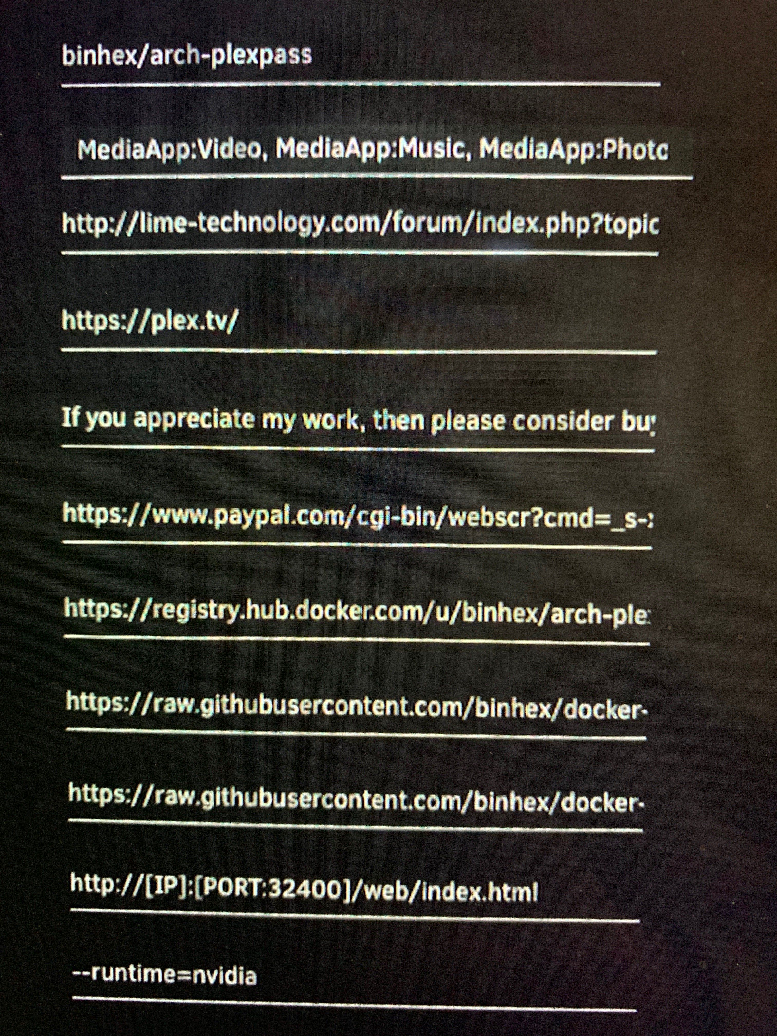

ok can you post a screenshot of the unraid configuration screen for this container.
Hi of course there attached, Only had this issue since adding Music
many thanks
L33

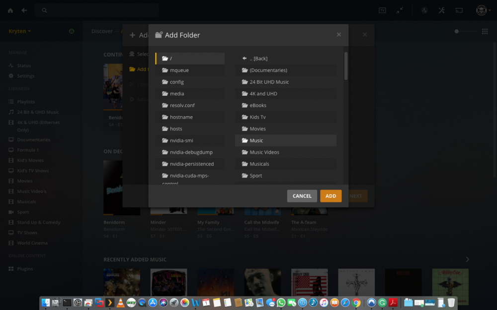

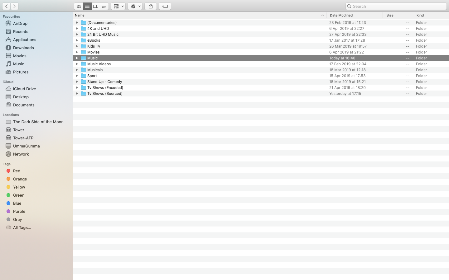

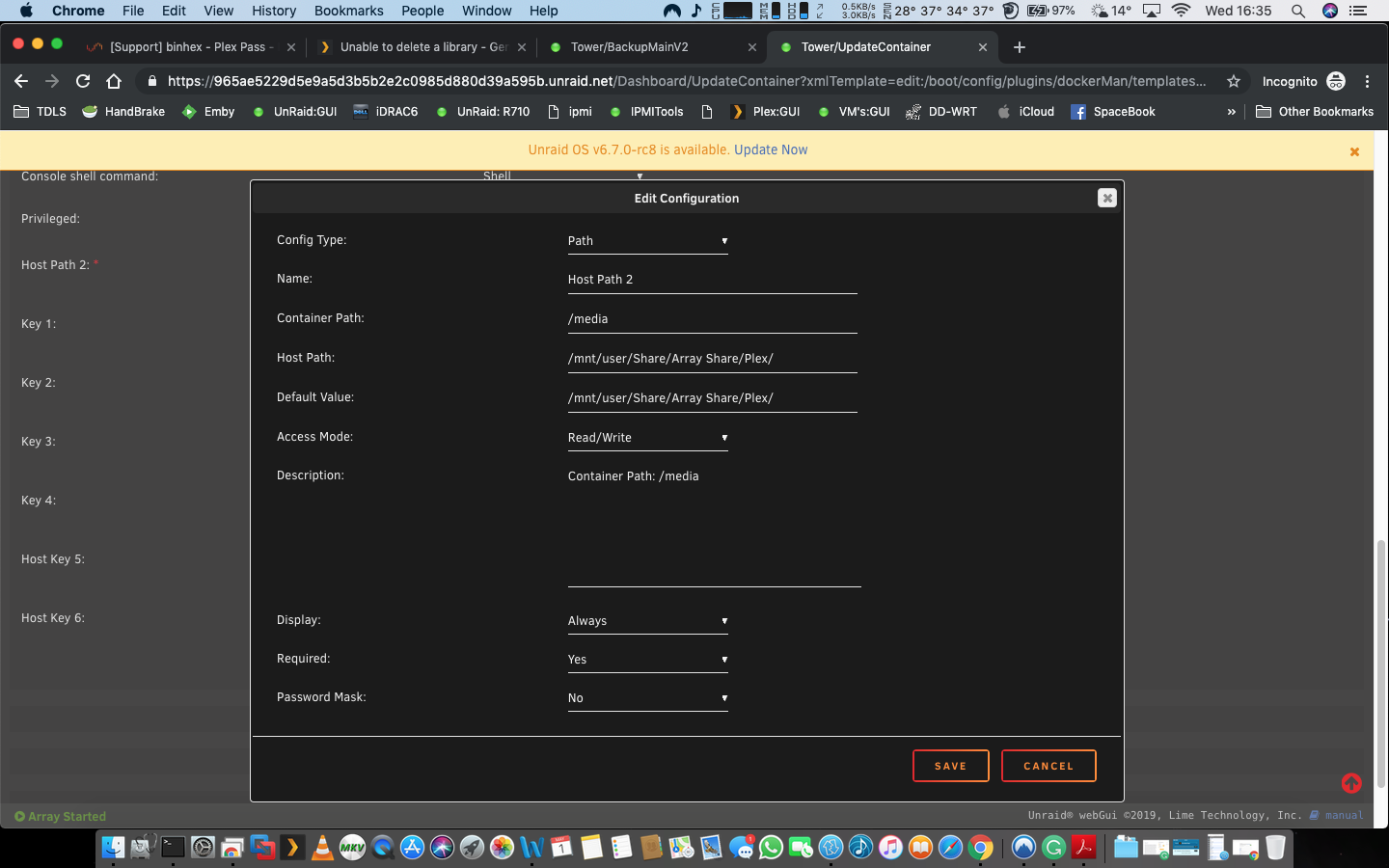

can you click on the 'edit' button next to the container path /media and then screenshot that, i just want to ensure that access mode to your media is read/write.
Is it possible that this is an issue with RC7? i have a CA backup that i am currently restoring it was created Sunday before i added the Music library. Once restored and all up and running i am going to Create a New library in plex Music, and point it to   /mnt/user/Share/Array Share/Plex/ in there i have all my plex folders Ill pop a screen dump below
TIA
L33
OK

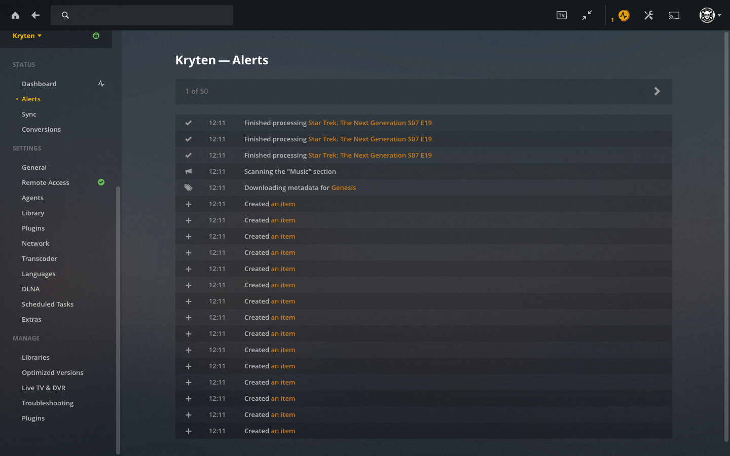

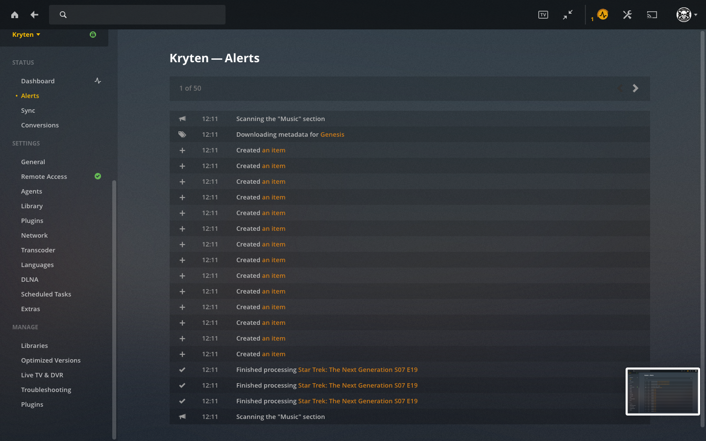

I have restored my CA backup all is ok, I have now Added Music and pointed it to the folder Music in Plex and it is now scanning.  This is the exact process I did but I added the artists one at a time instead of all at once. I have taken logs as soon as Plex loaded and ill take them again if it does the same again.  I shall keep you Posted :)

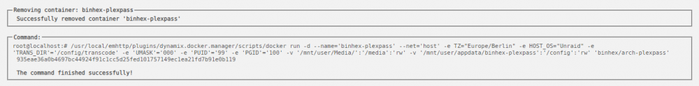

I have recently transferred my server over to Unraid and finally got all the data moved over. I downloaded the recent Binhex-PlexPass Docker and have been having issues with accessing the WebUI for it.
This is from the log from the docker.
2019-04-28 20:45:26.621356 [info] System information Linux xxxx 4.18.20-unRAID #1 SMP Fri Nov 23 11:38:16 PST 2018 x86_64 GNU/Linux
2019-04-28 20:45:26.653640 [info] PUID defined as '99'
2019-04-28 20:45:27.301416 [info] PGID defined as '100'
2019-04-28 20:45:28.067040 [info] UMASK defined as '000'
2019-04-28 20:45:28.097798 [info] Permissions already set for volume mappings
2019-04-28 20:45:28.127115 [info] TRANS_DIR defined as '/config/transcode'
2019-04-28 20:45:28.215223 [info] Starting Supervisor...
2019-04-28 20:45:28,598 INFO Included extra file "/etc/supervisor/conf.d/plexmediaserver.conf" during parsing
2019-04-28 20:45:28,598 INFO Set uid to user 0 succeeded
2019-04-28 20:45:28,600 INFO supervisord started with pid 8
2019-04-28 20:45:29,602 INFO spawned: 'plexmediaserver' with pid 54
2019-04-28 20:45:29,603 INFO reaped unknown pid 9
2019-04-28 20:45:29,734 DEBG fd 8 closed, stopped monitoring <POutputDispatcher at 23063968459808 for <Subprocess at 23063968458440 with name plexmediaserver in state STARTING> (stdout)>
2019-04-28 20:45:29,734 DEBG fd 10 closed, stopped monitoring <POutputDispatcher at 23063968460528 for <Subprocess at 23063968458440 with name plexmediaserver in state STARTING> (stderr)>
2019-04-28 20:45:29,734 INFO exited: plexmediaserver (exit status 255; not expected)
2019-04-28 20:45:29,735 DEBG received SIGCLD indicating a child quit
2019-04-28 20:45:30,737 INFO spawned: 'plexmediaserver' with pid 59
2019-04-28 20:45:30,783 DEBG fd 8 closed, stopped monitoring <POutputDispatcher at 23063967894488 for <Subprocess at 23063968458440 with name plexmediaserver in state STARTING> (stdout)>
2019-04-28 20:45:30,783 DEBG fd 10 closed, stopped monitoring <POutputDispatcher at 23063968464408 for <Subprocess at 23063968458440 with name plexmediaserver in state STARTING> (stderr)>
2019-04-28 20:45:30,784 INFO exited: plexmediaserver (exit status 255; not expected)
2019-04-28 20:45:30,784 DEBG received SIGCLD indicating a child quit
2019-04-28 20:45:32,787 INFO spawned: 'plexmediaserver' with pid 64
2019-04-28 20:45:32,833 DEBG fd 8 closed, stopped monitoring <POutputDispatcher at 23063967894488 for <Subprocess at 23063968458440 with name plexmediaserver in state STARTING> (stdout)>
2019-04-28 20:45:32,833 DEBG fd 10 closed, stopped monitoring <POutputDispatcher at 23063968460528 for <Subprocess at 23063968458440 with name plexmediaserver in state STARTING> (stderr)>
2019-04-28 20:45:32,833 INFO exited: plexmediaserver (exit status 255; not expected)
2019-04-28 20:45:32,833 DEBG received SIGCLD indicating a child quit
2019-04-28 20:45:35,838 INFO spawned: 'plexmediaserver' with pid 69
2019-04-28 20:45:35,881 DEBG fd 8 closed, stopped monitoring <POutputDispatcher at 23063967894488 for <Subprocess at 23063968458440 with name plexmediaserver in state STARTING> (stdout)>
2019-04-28 20:45:35,882 DEBG fd 10 closed, stopped monitoring <POutputDispatcher at 23063968457792 for <Subprocess at 23063968458440 with name plexmediaserver in state STARTING> (stderr)>
2019-04-28 20:45:35,882 INFO exited: plexmediaserver (exit status 255; not expected)
2019-04-28 20:45:35,882 DEBG received SIGCLD indicating a child quit
2019-04-28 20:45:36,883 INFO gave up: plexmediaserver entered FATAL state, too many start retries too quickly
2019-04-29 21:59:10,387 WARN received SIGTERM indicating exit request

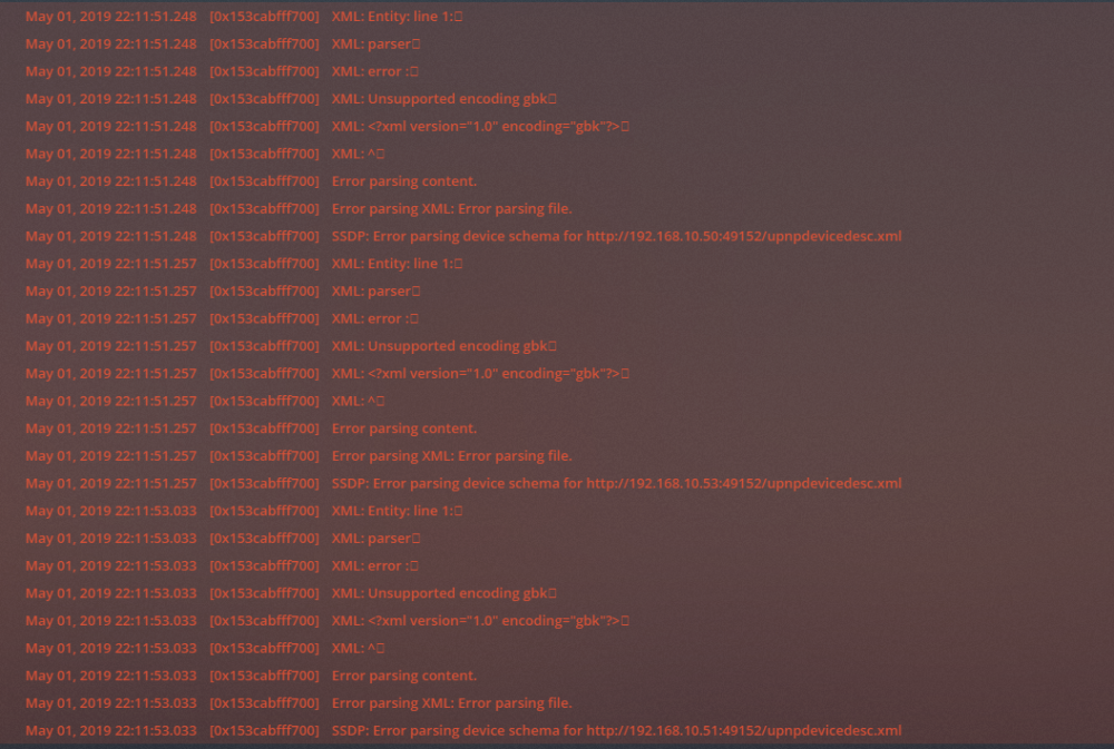

OK the problem has started again the library is u and running and the media has been scanned and plays ok, The mover has completed moving the media to the array. I have just added another folder but it has not picked it up So i added another and the same its only scanning the media thats already in the library Nothing New. I know these two albums work as i had them in the previous library. i have stopped the container and Scanned library files, Optimised the database and cleaned the bundles. Stopped and Started the docker and then dropped another album into the music folder but it doesn't put the Artis nor Album in the library. Says added item.
from docker log
if self.shouldRollover(record):
File "/usr/lib/plexmediaserver/Resources/Python/lib/python2.7/logging/handlers.py", line 156, in shouldRollover
msg = "%s\n" % self.format(record)
File "/usr/lib/plexmediaserver/Resources/Python/lib/python2.7/logging/__init__.py", line 734, in format
return fmt.format(record)
File "/usr/lib/plexmediaserver/Resources/Plug-ins-4610c6e8d/Framework.bundle/Contents/Resources/Versions/2/Python/Framework/core.py", line 77, in format
record.__dict__[key] = uni(record.__dict__[key])
UnicodeDecodeError: 'utf8' codec can't decode byte 0xa9 in position 18: invalid start byte
Logged from file audiohelpers.py, line 248
2019-05-03 04:13:26,008 DEBG 'plexmediaserver' stderr output:
GUI: Requesting metadata for '...And Then There Were Three...'
2019-05-03 04:13:28,060 DEBG 'plexmediaserver' stderr output:
GUI: Requesting metadata for 'A Trick Of The Tail'
2019-05-03 04:13:28,161 DEBG 'plexmediaserver' stderr output:
GUI: Requesting metadata for 'Abacab'
2019-05-03 04:13:28,221 DEBG 'plexmediaserver' stderr output:
GUI: Requesting metadata for 'Calling All Stations'
2019-05-03 04:13:28,290 DEBG 'plexmediaserver' stderr output:
GUI: Requesting metadata for 'Duke'
2019-05-03 04:13:28,313 DEBG 'plexmediaserver' stderr output:
GUI: Requesting metadata for 'Foxtrot'
2019-05-03 04:13:28,364 DEBG 'plexmediaserver' stderr output:
GUI: Requesting metadata for 'From Genesis To Revelation'
2019-05-03 04:13:28,373 DEBG 'plexmediaserver' stderr output:
GUI: Requesting metadata for 'Genesis'
2019-05-03 04:13:28,384 DEBG 'plexmediaserver' stderr output:
GUI: Requesting metadata for 'Genesis Live'
2019-05-03 04:13:28,398 DEBG 'plexmediaserver' stderr output:
GUI: Requesting metadata for 'Seconds Out'
2019-05-03 04:13:36,289 DEBG 'plexmediaserver' stderr output:
__code__:487: FutureWarning: The behavior of this method will change in future versions. Use specific 'len(elem)' or 'elem is not None' test instead.
2019-05-03 04:13:36,670 DEBG 'plexmediaserver' stderr output:
__code__:500: FutureWarning: The behavior of this method will change in future versions. Use specific 'len(elem)' or 'elem is not None' test instead.
2019-05-03 04:13:44,057 DEBG 'plexmediaserver' stderr output:
File "/usr/lib/plexmediaserver/Resources/Python/lib/python2.7/logging/handlers.py", line 76, in emit
2019-05-03 04:14:02,184 DEBG 'plexmediaserver' stderr output:
It was working fine its added some media ok but now its just stopped adding newly added albums
Can anyone shed any light on this PLEASE for my Sanity
Regards
L33
Plex Media Server Logs_2019-04-30_13-34-33.zip
