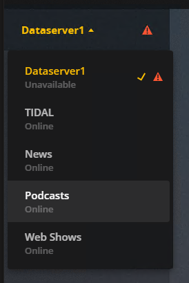

5 hours ago, LumberJackGeek said:
Bump, any ideas on this? The gf is getting mad that Plex has been down for so long O_o
Do you have an ssd?  If so, check to see if the drive or the docker image is full with logs.  By default, unraid doesn't limit the logs... I've had both plex and Home Assistant with multiple gigs of logs.
sadly that zip isn't much use here, those are diagnostics logs for unraid itself, not for this container, can you post the /config/supervisord.log and also there should be plex specific logs in /config/plex media server/logs (or something like that, i cant remember the exact path) can you post those too.

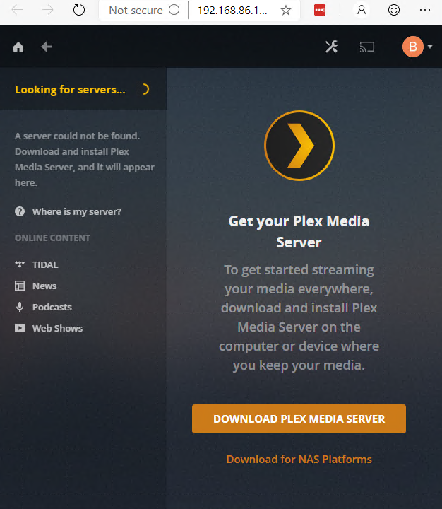

This is what I am greeted with after? :'(
Yes you will need to re add your server, like you did when your initially installed Plex, you need to go to a machine in you LAN and go to http://:32400/web

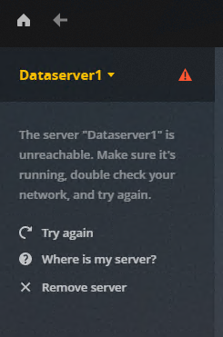

I am pretty sure that's where I am:
Or should I try "Remove Server"
Yes remove the old server and then hopefully you should be able to add the new server

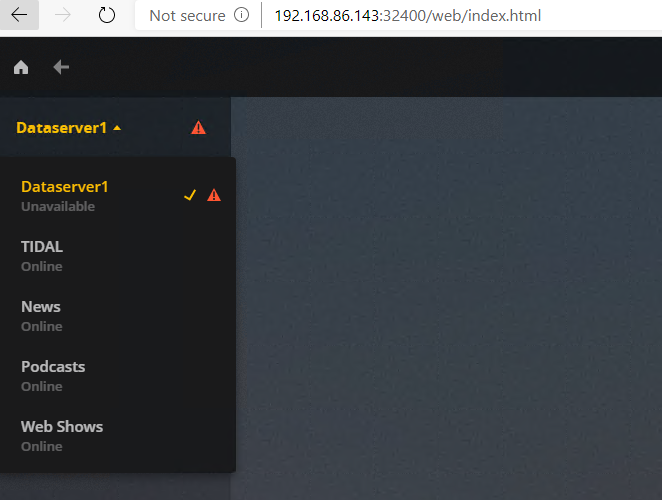

This is currently where I am at now, I am not being prompted to "add" a new server:
Scratch that, I disabled my proxy and it looks like it's taking me through the setup now.

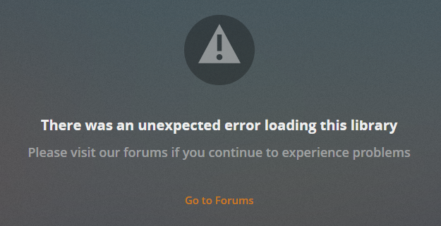

Ok so Plex was up and running for less than a day, now I am hitting this:
But this time Plex is showing as running, so it's not the same issue as before? Currently working on extracting my backup that was made at 4 am last time, but it's going to take several hours. Plex logs are attached.

im afraid there are signs of corruption again, taken from log file 'Plex Media Server.log':-
Jun 25, 2019 10:53:15.573 [0x14e02a5f2700] ERROR - SQLITE3:(nil), 11, database corruption at line 64883 of [bf8c1b2b7a]
Jun 25, 2019 10:53:15.573 [0x14e02a5f2700] ERROR - SQLITE3:(nil), 11, statement aborts at 44: [insert into statistics_bandwidth (account_id,device_id,timespan,at,lan,bytes) values
so this might be a partial corruption causing error loading library message you are getting, what is the host path you have defined for /config? you may reduce the chance (not eliminate) corruption by moving from /mnt/user/appdata/<rest of path> to /mnt/cache/appdata/<rest of path> see Q7 from my FAQ linked below:-
