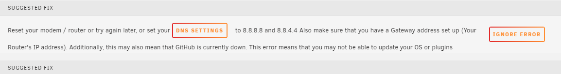

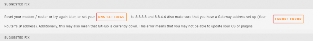

can someone please answer this as I think it might be a false error .
this morning I log onto my server and discovered the following.
so I want and check my DNS and my DNS is pointing to 8.8.8.8 and 8.8.4.4
and also I have a G/W that is point to 192.168.1.1
so I am not sure what I need to do to resolve this.
also for your knowledge I have a PFSENSE that handles all my DHCP and routing from my ISP with PFBlocker and I have tested this with and without PFBlocker turned on and I am getting this

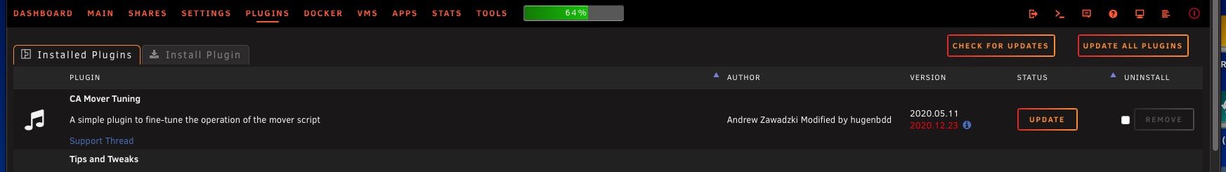

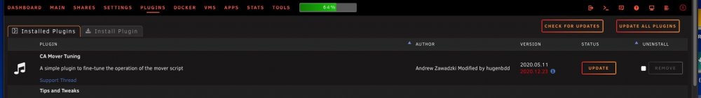

Perhaps this is expected behavior? I have the modified Mover Tuning plugin installed but have not updated to the most recent version. Still on vs 2020.5.11 which I believe is compatible with unraid 6.8.3. However, FCP is reporting that this version of the plugin isn't compatible. I have ignored the warning but thought it might be a bug in FCP.
48 minutes ago, wgstarks said:
bug
It's not supposed to do that™

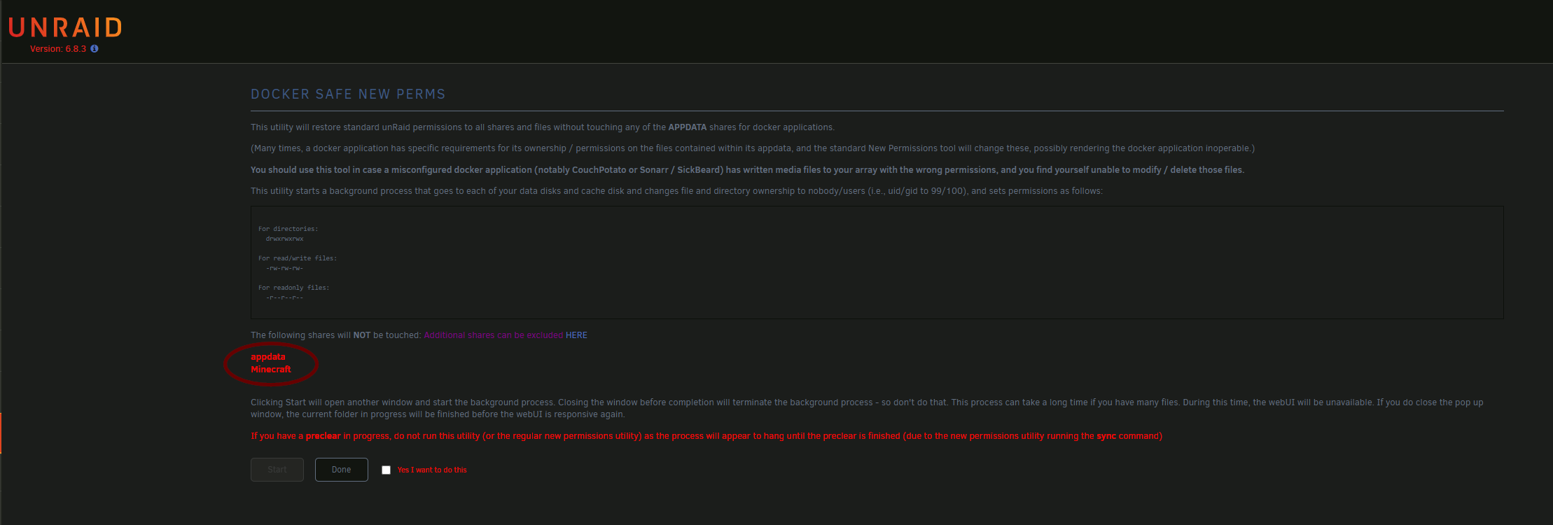

Hi, I am fairly new to UnRaid. I have been running it for a 3 months without too many issues. I am not sure if this is the correct place to ask my question. If not please let me know. Currently I am running into an issue with permissions on one of my shares. This share is where I put the appData for all of my Docker Minecraft servers. I have two separate Docker images for the two different types of servers. One for Java edition and one for Bedrock edition. The directories in this share for the Java editions work perfectly fine. However, the directories Bedrock containers are giving me permission issues. When trying to edit/modify/delete files and folders in the Bedrock directories from a Windows device I receive an error:
You require permission from Unix User\nobody to make changes to this folder.
I have been Googling and reading forums on similar issues. Everything that I read says to try running the Docker Safe New Perms Tool. I have tried running this tool but it automatically excluding my Minecraft share. I am not sure why this share is being automatically excluded. I have tried searching for how to remove this share from the exclusion list but am unable to find anything.
I have tried running an extended test in Fix Common Problems but still nothing. Ultimately my problem is that I have directories in a share that have permission issues. But from what I am reading the best common fix is to run the Docker Safe New Perms Tool. Unfortunately, this tool is automatically excluding the share that I am having issues with.
My question is, is there a way to exclude a share from the exclusion list for this tool?  Please let me know if I'm asking in the wrong place or if there is a better way to go about fixing my ultimate issue with folder permissions.
Thank you!
Fairly normal for the appdata directories.  Apps have their own unique permission requirements which may or may not be compatible with SMB.  You could always either use the command line or the Krusader app to manipulate these folders (or bug the maintainer in the support thread for further advice)
Because of those unique permission requirements, Docker Safe New Perms doesn't ever touch those folders.  If you want to take a shot (YMMV), then run the New Permissions tool against the appdata share.
Thank You Squid!  The Krusader app worked for me.

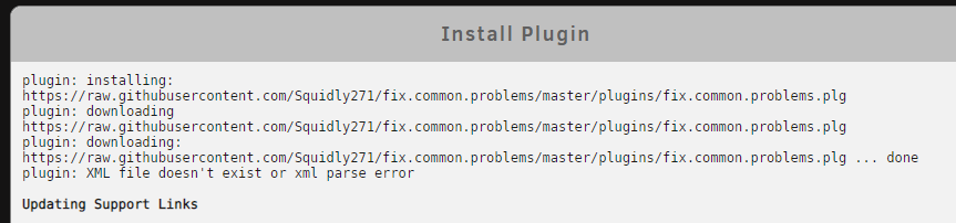

I cant seem to install the plugin even when directly using the github url.
Post your diagnostics.  There's something else going on.
try again after rebooting.  If it still doesn't work, post another set of diags
