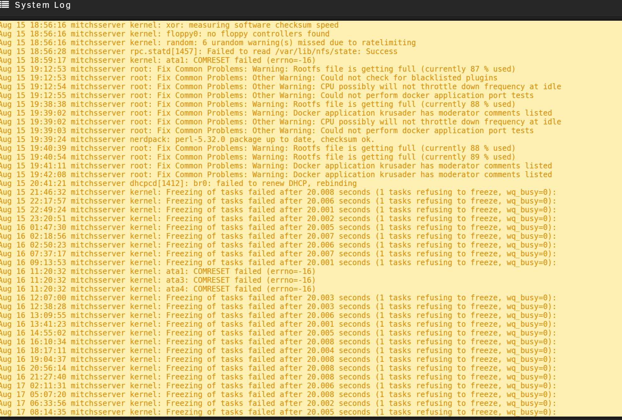

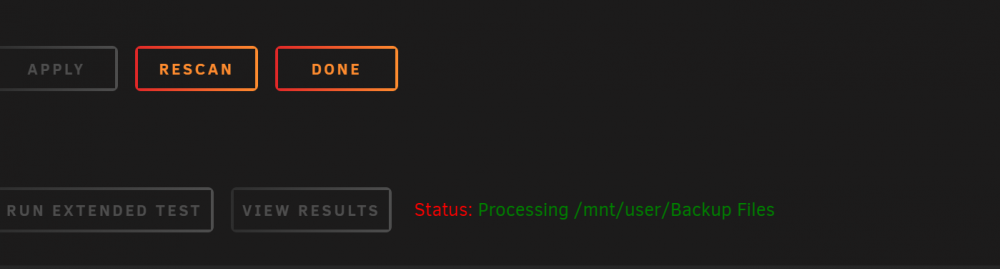

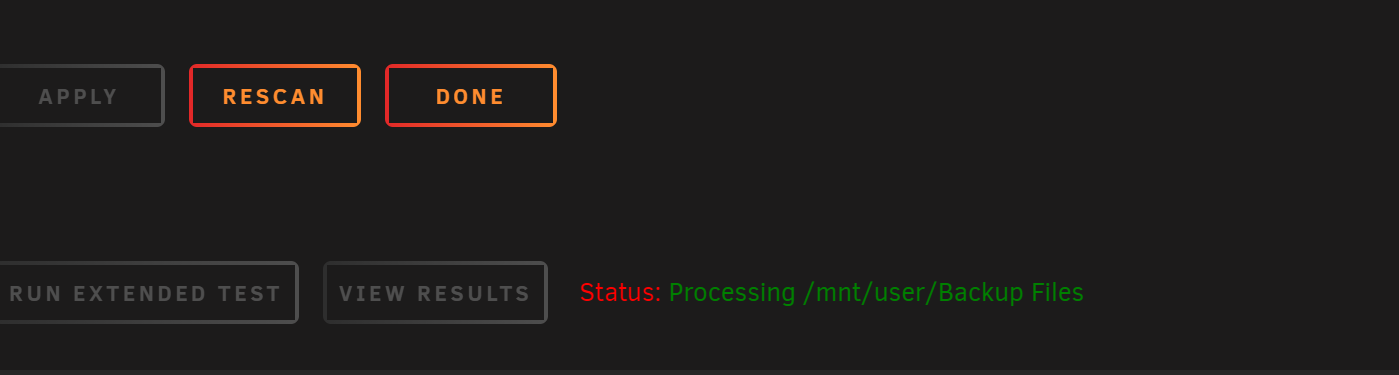

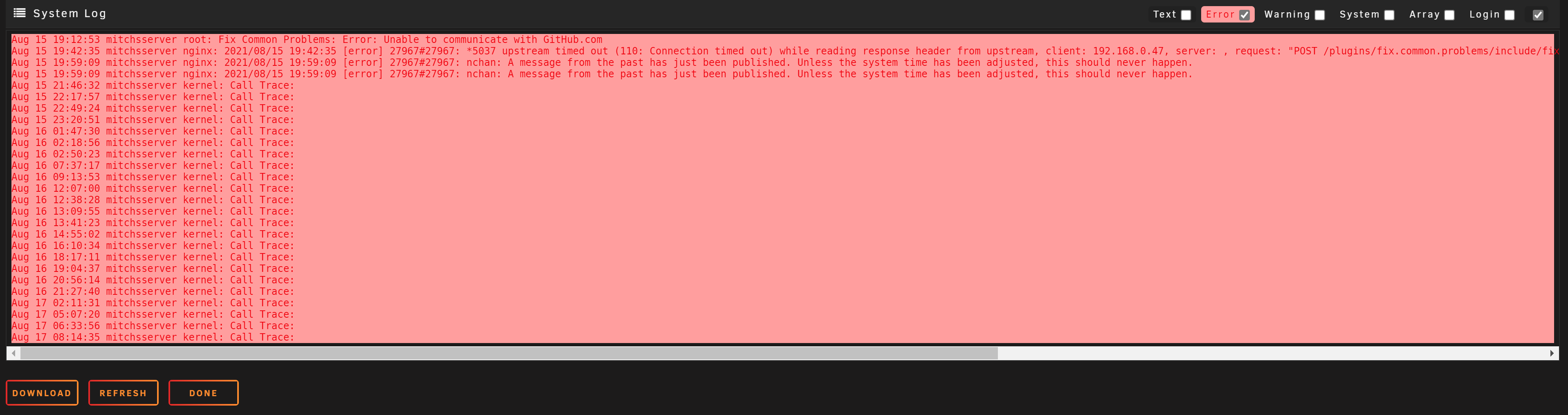

so i decided to check my sisters Unraid.. its a 4 Bay unit..   i ran the Extended Scan..  been running since yesterday afternoon.. its stuck    it hasnt done anything... and now i see the drives are spun down...   does the diagnostics say anything?
maybe whats caused it to just be stuck?  i looked in the system log  but i cant really tell
mitchsserver-diagnostics-20210816-0818.zip
so its been least 24 hours and it hasnt moved any ideas from the diagnostics whats wrong
whats causing it to be stuck?  since i cant run a extended scan
mitchsserver-diagnostics-20210816-1934.zip
ok so day 3.. still need help...
@JorgeB said Fix Common Problems Plugin is causing these errors, and  appears not to be an unraid issue, hardware.. but something in the plugin
mitchsserver-diagnostics-20210817-0901.zip
Edited by comet424
and tell me what a Call Trace error is as it says nothing what it is whats its calling etc... and what a freezing of tasks failed.. what is it what it does.. why is it freezing etc
i have a 8TB drive preclearing.. so i hoping it solves the FCP plugin from freezing
but i guess could be computer or power supply problem..  hoping not yet.. but will see
but hopefully 8TB drive will fix something.. its newer lol
Edited by comet424
