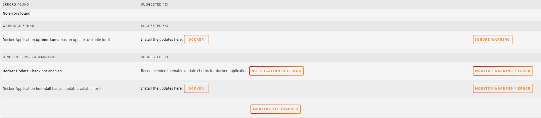

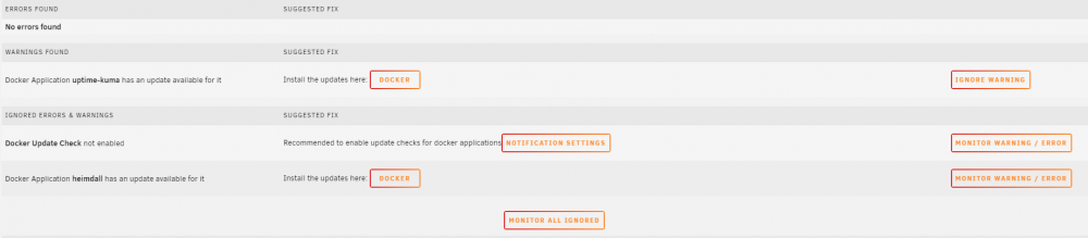

On 12/30/2021 at 4:32 PM, Drikani said:
This one would be great to know.
I manage all my docker containers with portainer and watchtower and do not need those notifications and errors popping up all the time.
Is there any way for me to disable this on module?
All the other checks I still want to be able to monitor and be notified about.
On the unraid docker tab it also shows me that there are updates available for my containers even though there are none and it really bugs me out.
I don't want unraid to manage those things for that I have portainer with a much better UI...
I'm having the same issue. I managed to hide the visual elements and you can read about it here: https://www.reddit.com/r/unRAID/comments/rlbubo/hide_update_info_from_the_docker_page_when_using/
But I have not found any way of disabling the notifications only for docker containers. Is there a way to do so? I have my own python-script to update all on one go and the notification doesn't seem to go away even though the container has been updated. I have 50+ docker containers and I'm not really into rewriting them as I prefer portability. I like FCP, would it be possible to ignore all container updates somehow so I don't have to ignore them on a per-container basis? :)
