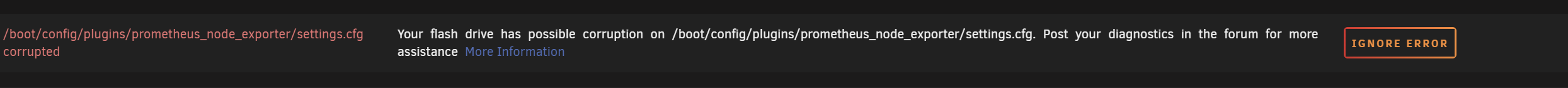

Hello Folks,
My unraid server started showing the following FCP error "Your flash drive has possible corruption on /boot/config/plugins/dynamix.schedules/dynamix.schedules.cfg. Post your diagnostics in the forum for more assistance".
I have downloaded the diagnostics report (attached here)...and I am keeping the server ON until I have captured all information, screenshots, diagnostics, copy config files and formulated a plan on how to fix the issue before I reboot the server and find that it wont reboot for whatever reason.
Appreciate any help or guidance on how to proceed forward. Thanks in advance.

You'll need to post the contents of that file here

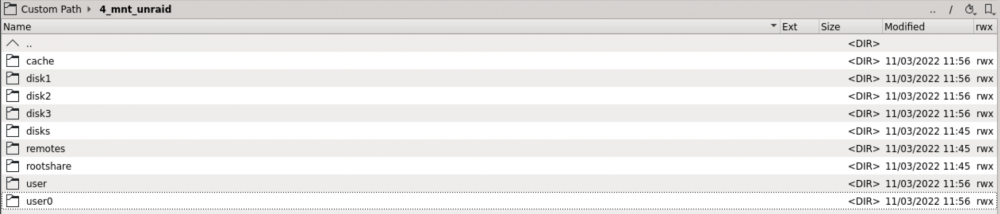

2 hours ago, ISwearItIsNotMe said:
I got the "Invalid folder root share contained within /mnt" error but I don't really know what folder is out of place here.
Here is a screenshot of /mnt via krusader.
Ive attached my logs as well.
Any help would be appreciated because i have no idea what I am doing.
Thanks!
unraid-server-diagnostics-20220311-1205.zipunraid-server-diagnostics-20220311-1205.zip 113.11 kB · 0 downloads

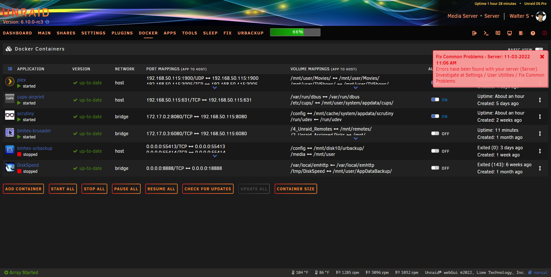

Hi all, I just updated to the latest Unraid rc3 and I noticed this error.  I don't like to mess with a good think, so I proceed with caution with my beloved media server.  I received this error via Fix Common Problems, and I'm not sure how to correct it (if necessary)
any further explanation/help would be appreciated.
Thanks..
server-diagnostics-20220311-1219.zip

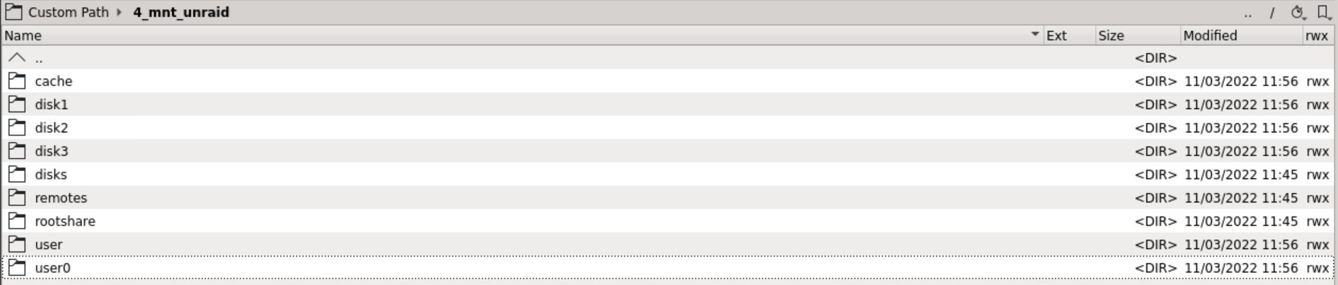

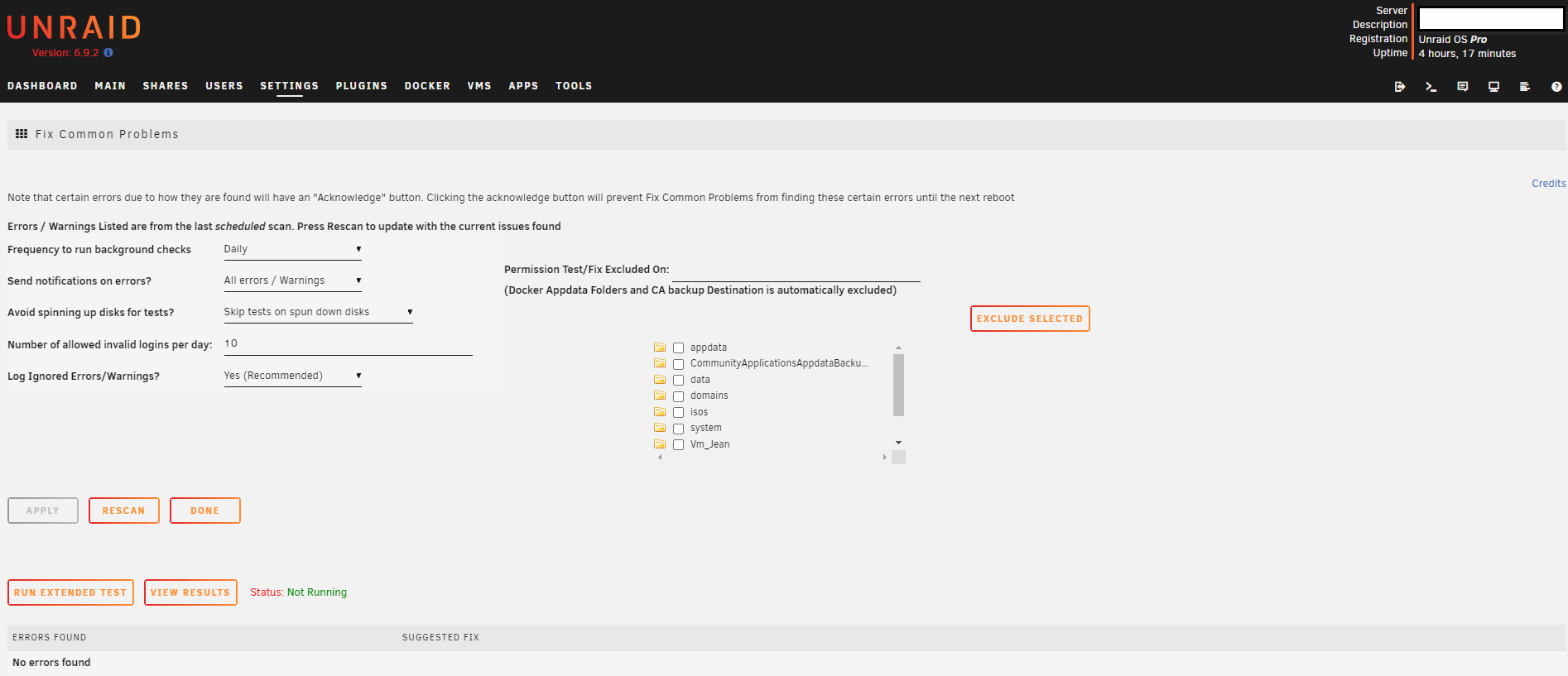

Hello all,
I have the "Invalid folder rootshare contained within /mnt" error on my system. I have attached the diagnostic logs and a print screen of the FCP page. The funny thing is everything was working fine and this problem only occurred after a reboot of the system. Since this problem has occurred, Plex is not able to find the media on the drives. Any assistance you can provide to help me locate and fix this issue would be greatly appreciated.
tower-diagnostics-20220311-1956.zip screenshot-Fix Common Problems 2022.03.11-20_01_35.pdf
