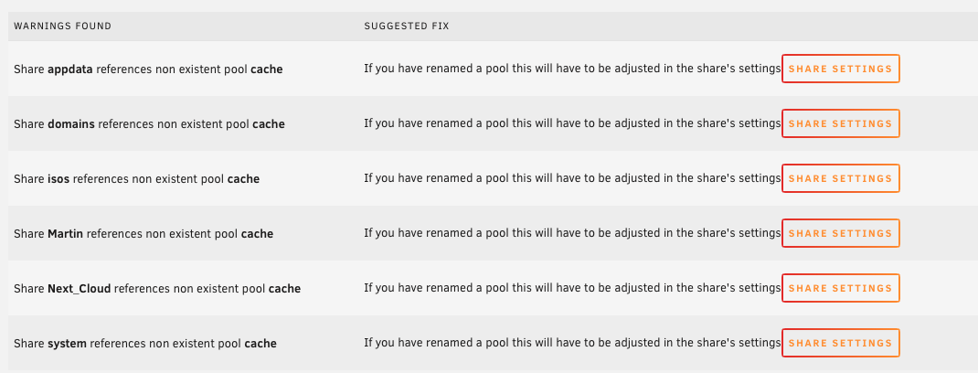

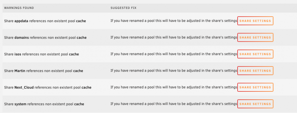

Hi Folks I hope I am posting in the correct group? got a strange error message that came up after fix common problems ran can you please advise see screen shot below every thing that I have running works ok and everything is kept updated and I have not had any power cuts etc...  I am scratching my head at the moment? 1687575789_Screenshot2022-01-30at17_02_46.thumb.png.33f8e0c7f5da9453e61b587dcaabd8dc.png
Do you have a cache pool named "cache"  What are the share settings for those shares in question?  If you can't sort it out, then post your diagnostics
Hi Squid
  With regards to your question I do not have a "cache" pool and I downloaded the diagnostics file however while looking at your Fix common problems it showered there was an update. I ran the update that rescanned my system and the error messages disappeared.
