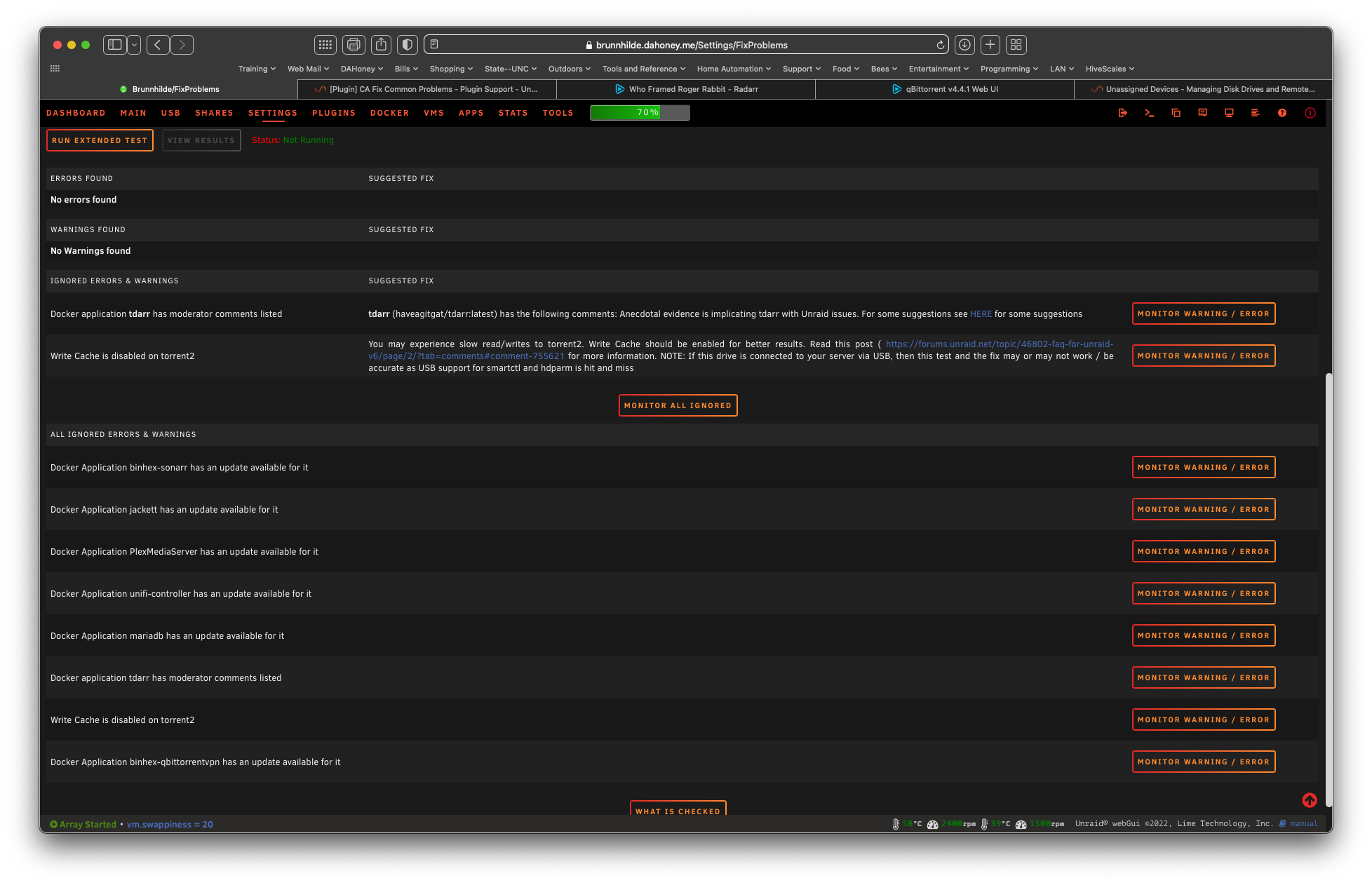

I'm getting this warning again-
Link: https://Brunnhilde.dahoney.me/Settings/FixProblems
     (Note: if clicking link requires reauthentication, copy/paste instead)
Event: Fix Common Problems - Brunnhilde
Subject: Warnings have been found with your server.(Brunnhilde)
Description: Investigate at Settings / User Utilities / Fix Common Problems
Importance: warning
* Wrong DNS entry for host
When i go to FCP settings there aren't any warnings though-
1604724382_ScreenShot2022-03-12at5_19_56PM.thumb.png.e2c65428a3fc5cf7d26ea6963ab2ba17.png
Strange.  Hit rescan
2 hours ago, Squid said:
Strange.  Hit rescan
Finally showed up.
Using DNS server 10.0.1.1, the DNS entry for 'Brunnhilde.dahoney.me' resolves to 10.0.30.109. If this url resolves correctly for your client computers using a different DNS server, you can probably ignore this warning. Otherwise, you should ensure that it resolves to 10.0.1.20.
Makes sense I guess. I recently setup a custom docker bridge on a VLAN (10.0.30.0/24). Looks like the server is using that network as well as the LAN (10.0.1.0/24). I'll have to figure out how to allow docker on the VLAN but not the server management.
