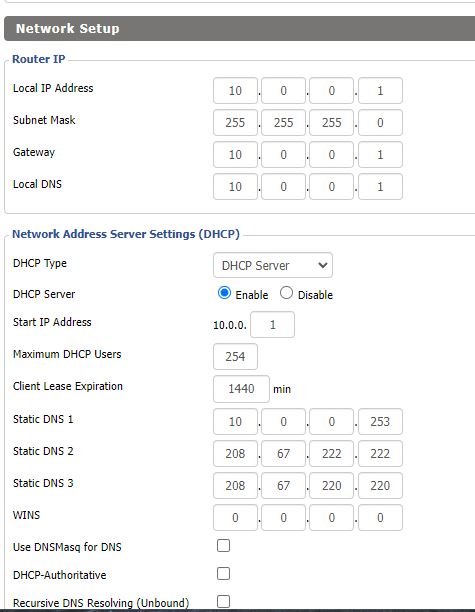

I am unable to figure out how to fix this:
"Unable to communicate with GitHub.com" - "Reset your modem / router or try again later, or set your  to 8.8.8.8 and 8.8.4.4 Also make sure that you have a Gateway address set up (Your Routers IP address). Additionally, this may also mean that GitHub is currently down. This error means that you may not be able to update your OS or plugins  More Information"
Over the weekend i swapped my router for a nighthawk R6700 running DD-WRT V3.0. I think the issue seems to be improper DNS settings. I have pihole running on 10.0.0.253. Pihole works. But any docker container is unable to communicate with github. Any advice is much appreciated. I've tried a number of options including the image below with static DNS 2, 3 blank to no avail.
Go to Settings -> Network Settings and set the DNS server to a known good public server that does not block anything, 8.8.8.8 is typically a good choice. Do not add your router or pihole to the list.
Once everything is working if you want to complicate things by adding pihole or another blocking DNS provider (OpenDNS) you can, just know that any problems are related to that change.
Read the post. Google DNS servers nor opendns servers are working. Stopping pihole and removing it's DNS address doesnt do anything better.
@ljm42 was asking for you to bypass piHole and your router's DNS and set the DNS directly within the OS (Settings - Network Settings)  Did you try that?
I have. I've tried pihole stopped. Static DNS 8.8.8.8, 8.8.4.4 and also opendns servers. Ive updated DD-WRT to latest firmware. It's got to be a setting somewhere I cannot see. I am attaching newest diagnostic file whereas I went back to pihole running and using it's ip for DNS. I'll revert back in a few hours to pihole off and google DNS so to not disrupt internet access to other users in peak hours. Hope someone can point me in the right direction.
