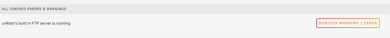

November 12, 20224 yr Minor issue, but apparently I hit ignore on this warning a long while ago but the "MONITOR WARNING / ERROR" button doesn't work. Clicking on it does nothing. It's been like this for maybe a year, just never bothered looking into fixing it yet.

November 18, 20224 yr Author On 11/11/2022 at 11:14 PM, s449 said: Minor issue, but apparently I hit ignore on this warning a long while ago but the "MONITOR WARNING / ERROR" button doesn't work. Clicking on it does nothing. It's been like this for maybe a year, just never bothered looking into fixing it yet. fixed
