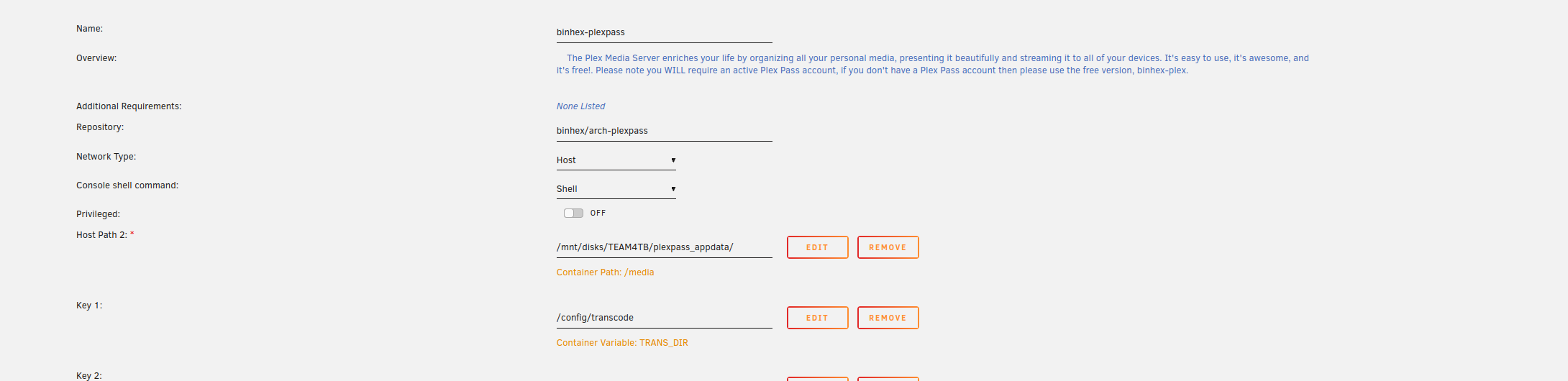

You have the wrong mapping of the drive.  You're referring to the drive in the docker mounted at /mnt/disks/TEAM4TB, but the drive is actually mounted at:
Aug 22 21:57:10 KRAKEN unassigned.devices: Successfully mounted 'nvme0n1p1' on '/mnt/disks/112110050430099'
Do the following:
  • Stop the plex docker container.
  • Unmount the UD drive.
  • Click on the UD mount point and change it to 'TEAM4TB'.
  • Mount the UD drive.
  • Start the plex docker container.

Hello, thanks for all the help but I'm not sure what I';m doing anymore. You reply let me find that all my info is there.  I dont know why it all stoped working. I created a link to UD back when I installed the NVME for plex andd file. so when you say to do "Click on the UD mount point and change it to 'TEAM4TB'." not sure how this is done or where it is. I see now what the problem is my link that was create might have gotten changed after the upgrade that cchanged something.  I will try and see if I can change it back!
In my case:
Click on the 'Testing' text when the drive is unmounted and change that to 'TEAM4TB'.
