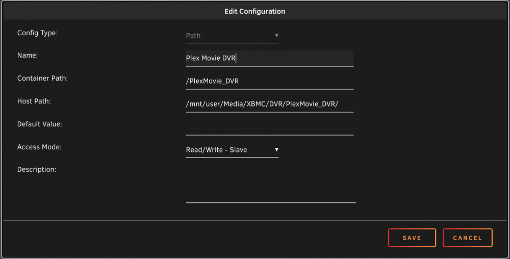

Hello, just updateto the lastest unraid6.11.0-rc3 Now the plex server is broken. I have a link or share in unassigned device with the plexe data. Only problem is that unraid doesnt see my files on it. It doesnt need all the videos either.  It know that 2TB has been used and there is 1.4TB free but I cant see any of the files . "
Due to how Docker works, if you have an disk or share being mounted by Unassigned Devices and that device or share is being passed through to a docker container under certain circumstances the docker app may not always see the files present within it.
The solution here is to edit the docker app in question, and next to the path that you're mapping to the container hit EDIT.  On the popup window that appears, for the access mode select one of the Slave access modes
" I do not understand what I need to do when is says"for the access mode select one of the Slave access modes"
so I dont know what I need to do if that will fix the problem.  I get this error "
Go to the docker tab and click the name of your plex docker. This will open the configuration window. Click the edit button for the path associated with the UD device and you will see a popup window similar to this-
18672744_ScreenShot2022-08-20at9_39_12PM.thumb.png.c731fd2903ef60fda31483b46b7d761b.png
Set the access mode to Read/Write - Slave and click "Save".

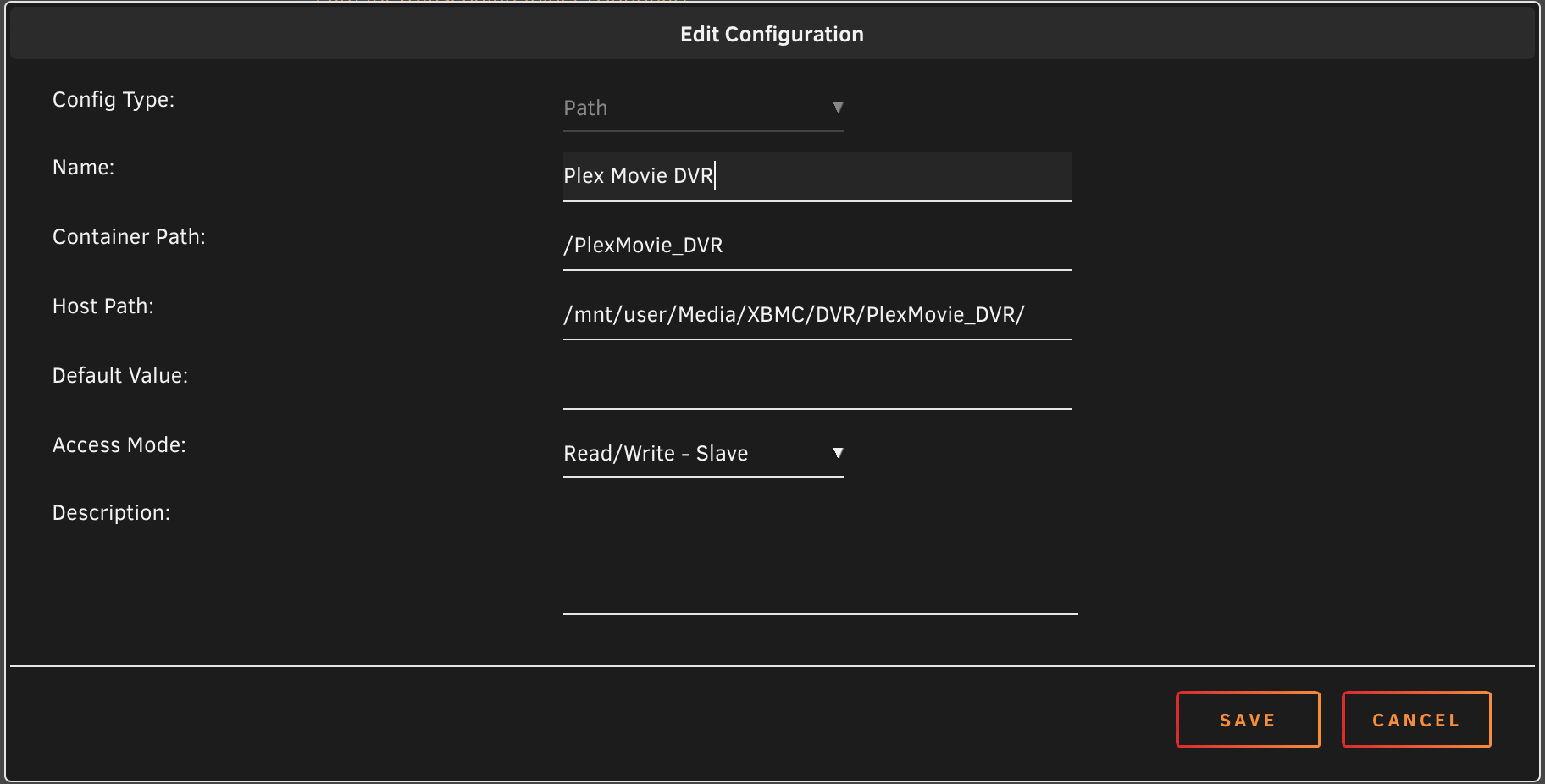

Hello, Yeah I found and understand what I needed to do but that didnt fix my problem!  I still cant see what on the drive so my plex server still isnt working. When conneccted threw the network all my file are not displaying. But unraid main page see the drive and that I have used up 2.4TB and have 1.5Tb free but under the unassign devices no files are showing up
I don't think this is the solution to your problem, but your log is being spammed with this:

The local master browser election is bouncing back and forth causing a lot of log messages.  It makes it hard to analyze your log when it's filling with those messages.  Not sure what your LAN configuration is, but maybe install the local master plugin to make Unraid always win the election for master browser.
Once you've solved that, unmount and remount the UD drive you use for plex and post new diagnostics.
Also post a screen shot of the mapping of the drive to the plex docker container.
