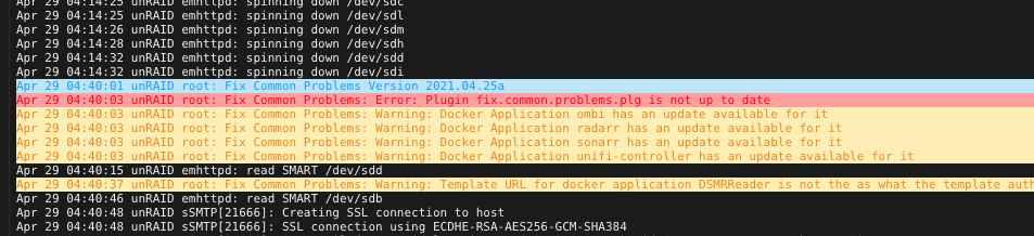

Is there a compelling reason that there is a Red error notification when there is a update for the plugin?
from my perspective this should not be red since it's just a plugin update not something really bad....
There have been quite some Updates the last couple of weeks and I still jump every time I see a red error 😬

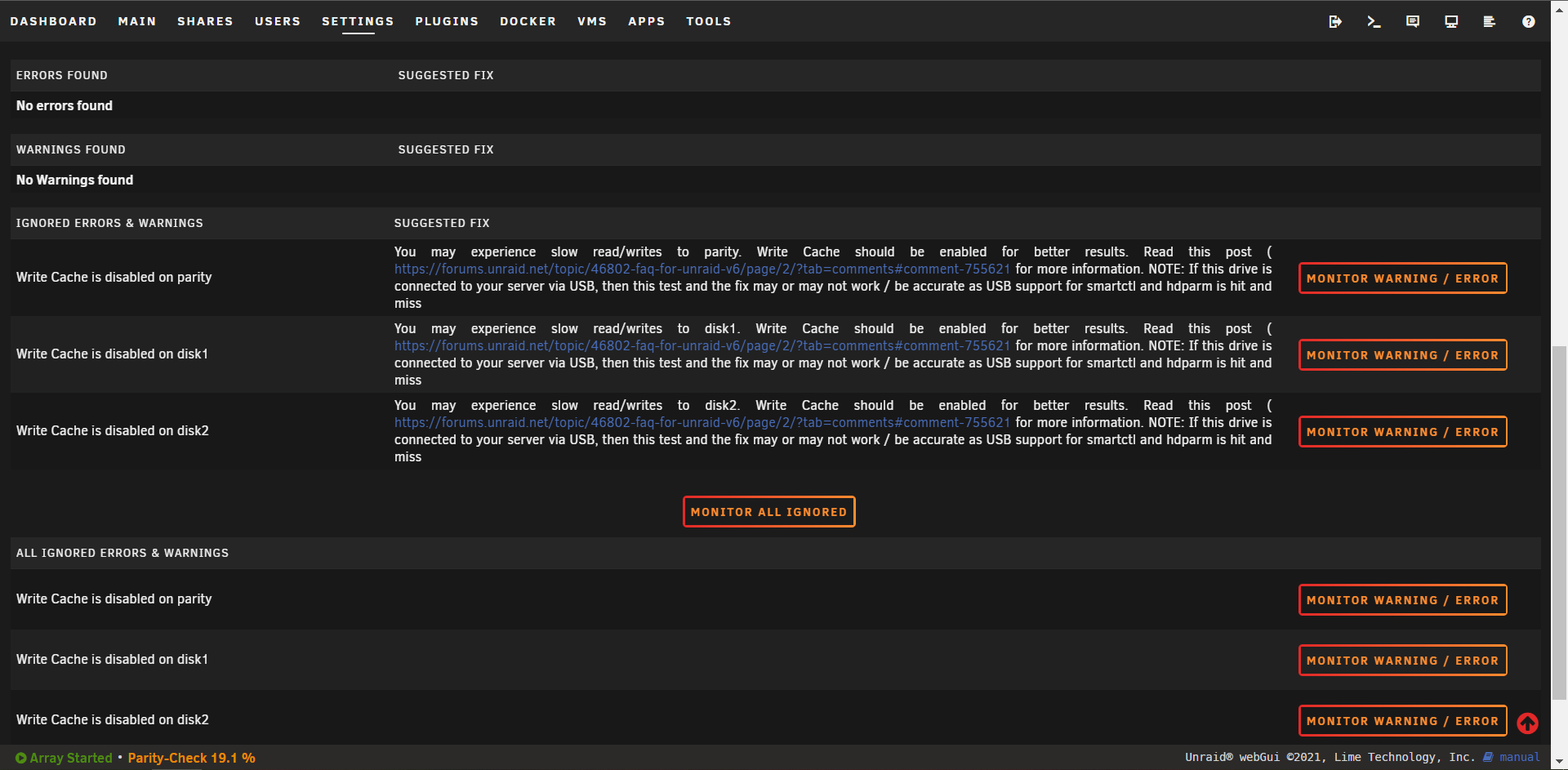

On 3/27/2020 at 9:38 AM, Squid said:
Yeah, the all ignored could / should be collapsed by default, since it's simply a history of everything you've ignored regardless of it's its found again.
Sorry to necro reply to this. I searched the thread for the word collapse and found your comment. It doesn't seem like ignored items are collapsed or even collapsable.
Is there a setting for this that I'm missing?
Unraid 6.9.2
FCP 2021.05.03
No, there're not collapsible.  They're just ignored...
Would you consider adding the ability to collapse sections? (And maybe either collapse ignored sections by default, or make it an option to do so). Every time I open the page I see (the screenshot) all the items I've intentionally ignored. It would be nice if the only things that grab my attention were things I haven't ignored.
Apparently I already have, since you quoted me saying so :) Of course, I forgot all about it.
