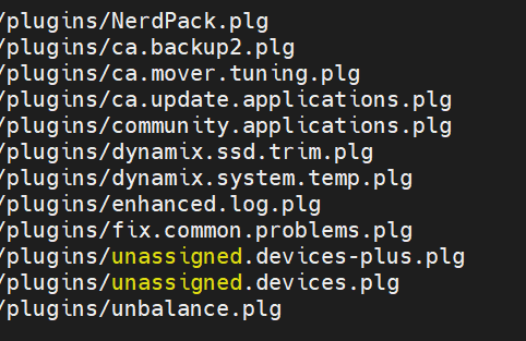

On 3/25/2021 at 9:33 AM, trurl said:
It shouldn't be difficult to know whether or not you have a plugin installed. Look on the Plugins page.
What do you get from the command line with this?
ls -lah /boot/config/plugins/*.plg
Hello
see attached

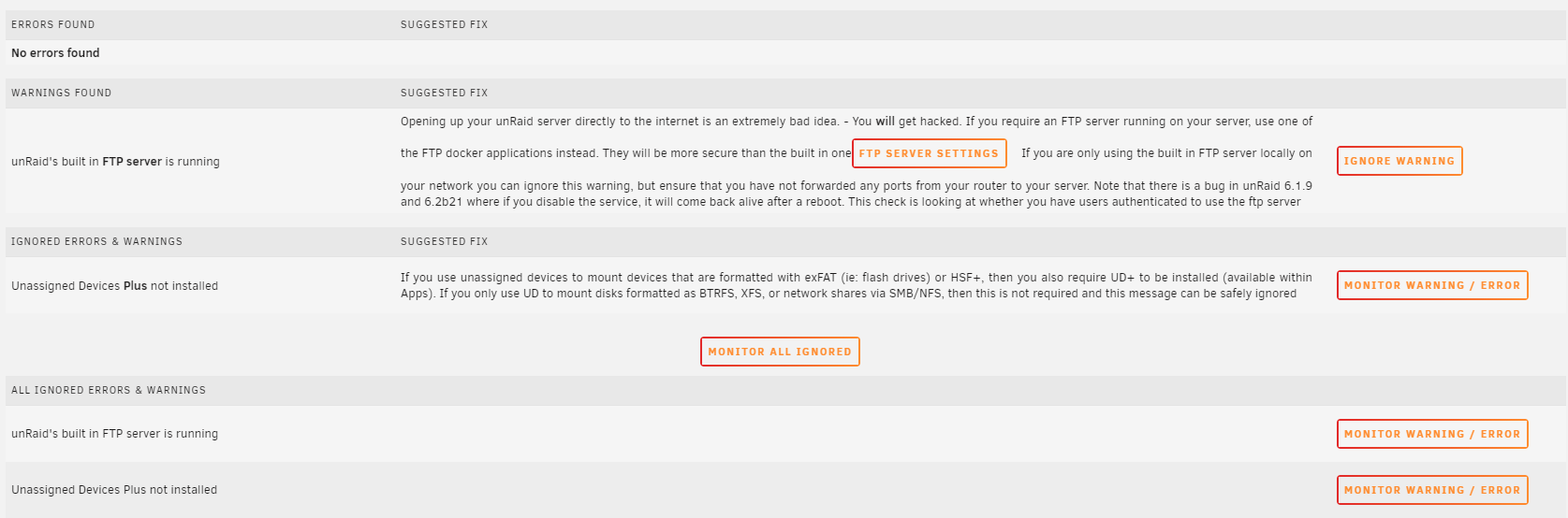

Ok, so I came to post about this (FTP server running).
I deleted the /boot/config/plugins/fix.common.problems/ignoreList.json file completely, rescanned and saw that error, ignored it, resacnned again and it's still showing up like this (listed both as an active one, and an ignored one)
Version: 2021.03.30a
Yes, see my post above. This had been working fine but broke when the single quotes were replaced with ' in mid March. Unfortunately some (all?) browsers treat this as a quote which breaks the Javascript. I had to edit the strings in tests.php to remove the apostrophes before I could get it to work. I'm sure Squid will post an update.
