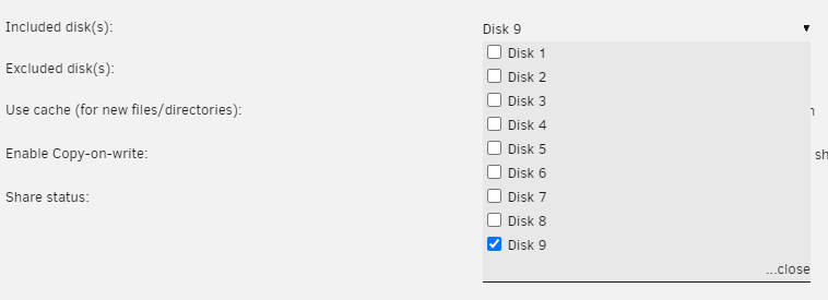

I am running 6.8.3 and recently installed Fix Common Problems.  I get an error message that says "Share Music FLAC has read/write set in its included disk settings".  I am not clear on what problem this indicates and how to fix it, if it does need fixing.
Thank you.
Can you show me a screen shot of that...
Here you go....
Really strange. "read/write" should be something like "disk1". How did you manage that, that your disk array contains a disk with the name "read/write"?!
I think this should be fixed when you select / unselect some of your "included disks" in the share settings for "Music FLAC" and hit the APPLY button.
Well, that worked!  Thank you.  All I did was select all the disks, apply, then deselect and used ALL, apply and Rescan. Presto, no more error message.  Thank you!

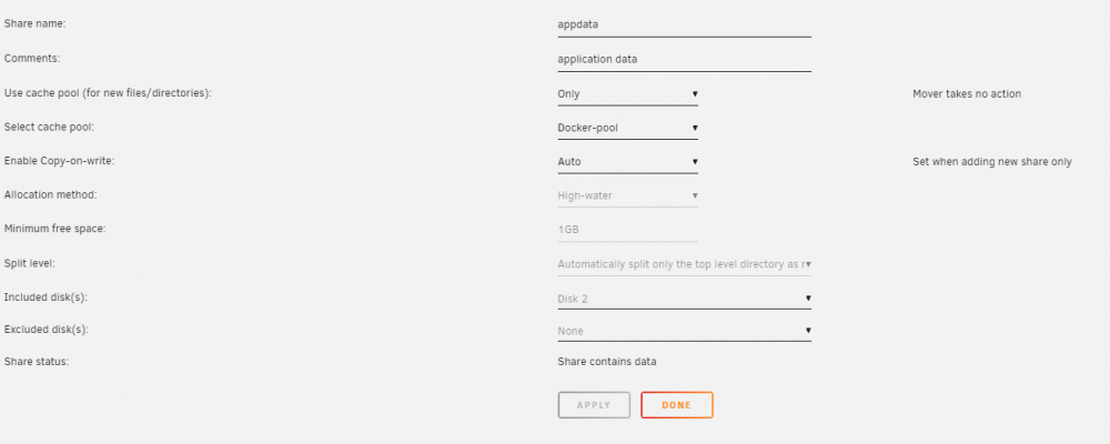

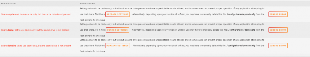

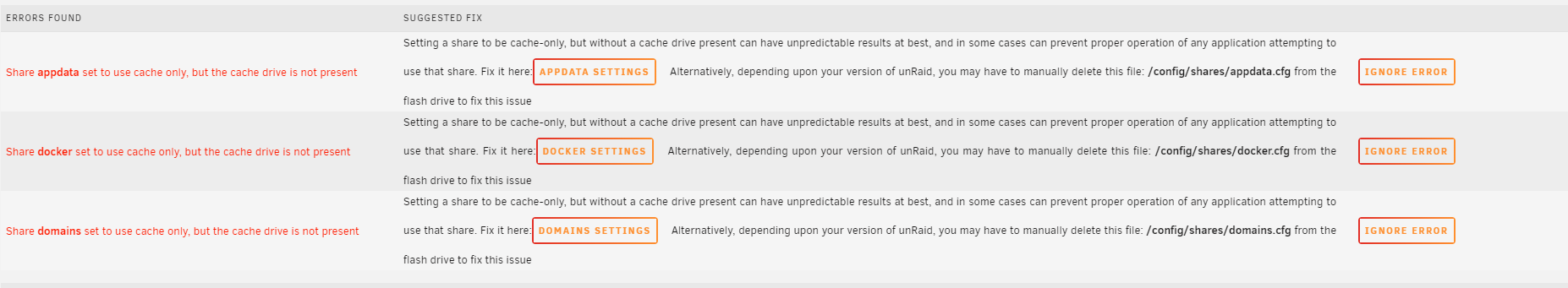

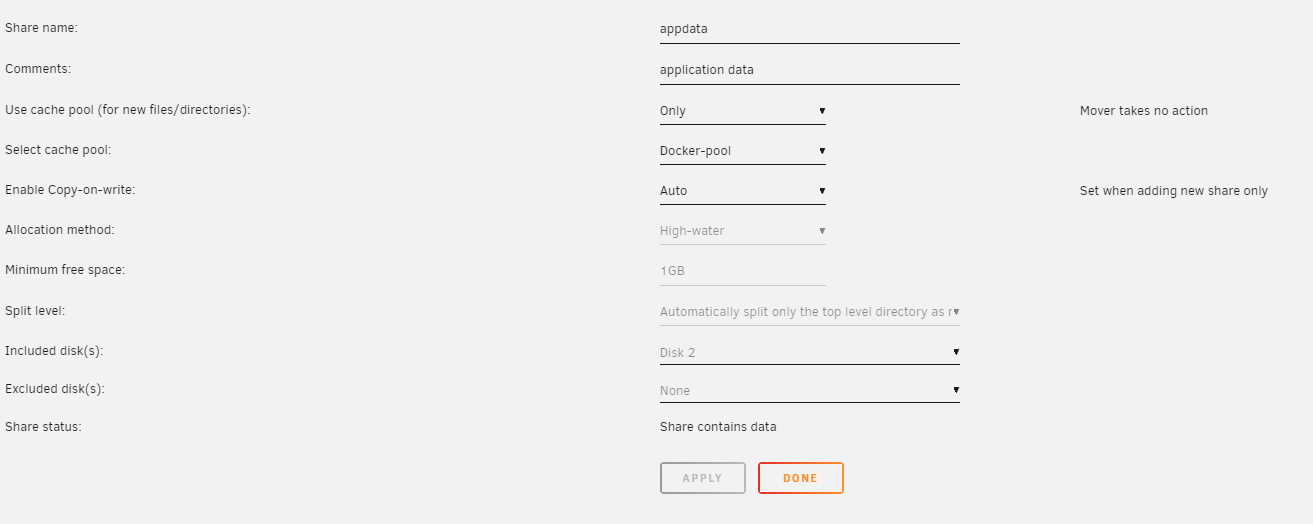

Bug report:
If you have any shares assigned to Cache only but you have renamed your default "Cache" pool, fixcommonproblems will trigger the following error. It happens regardless of which cache pool you have that share assigned to and seems to only be checking for "Cache" instead of the applicable cache pool which is assigned.
"Share VMsOnCache set to use cache only, but the cache drive is not present"
48 minutes ago, Vaggeto said:
Bug report:
I know... scheduled fix week of the 8th
Haha why am I not surprised! I appreciate all of your valuable work for the community!
Is there any other reason why it would be bad to rename from the default "cache" name? I considered not doing out of caution but it made sense now that I had a 2nd cache pool.
Name them as you choose.   Doesnt make any difference to the system

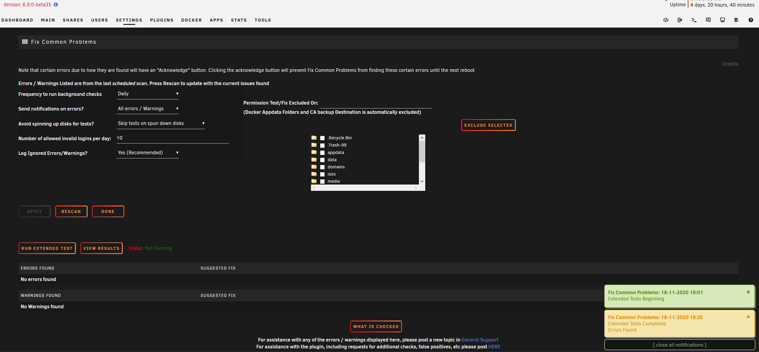

While testing my beta35 issue with the "close all notifications" button, I saw something with Fix Common Problems. (the extended test generate two notifications, it is quite practical :) )
The extended scan does not find errors (on the page), but the notification of the end of the tests says there is a problem.
 Same for the email:
Hitting View Results does list some errors though. Few naming stuff and permissions on stuff I don't care so much about. Fixed the former, I'll bother with the later maybe some day.
Anyhow, the No errors / warning found is a bit counter intuitive.
Different tests, hence the notification that shows that extended found something.  But, I do suppose it is somewhat counter intuitive.
