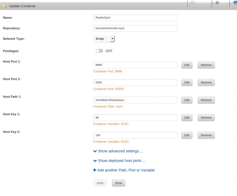

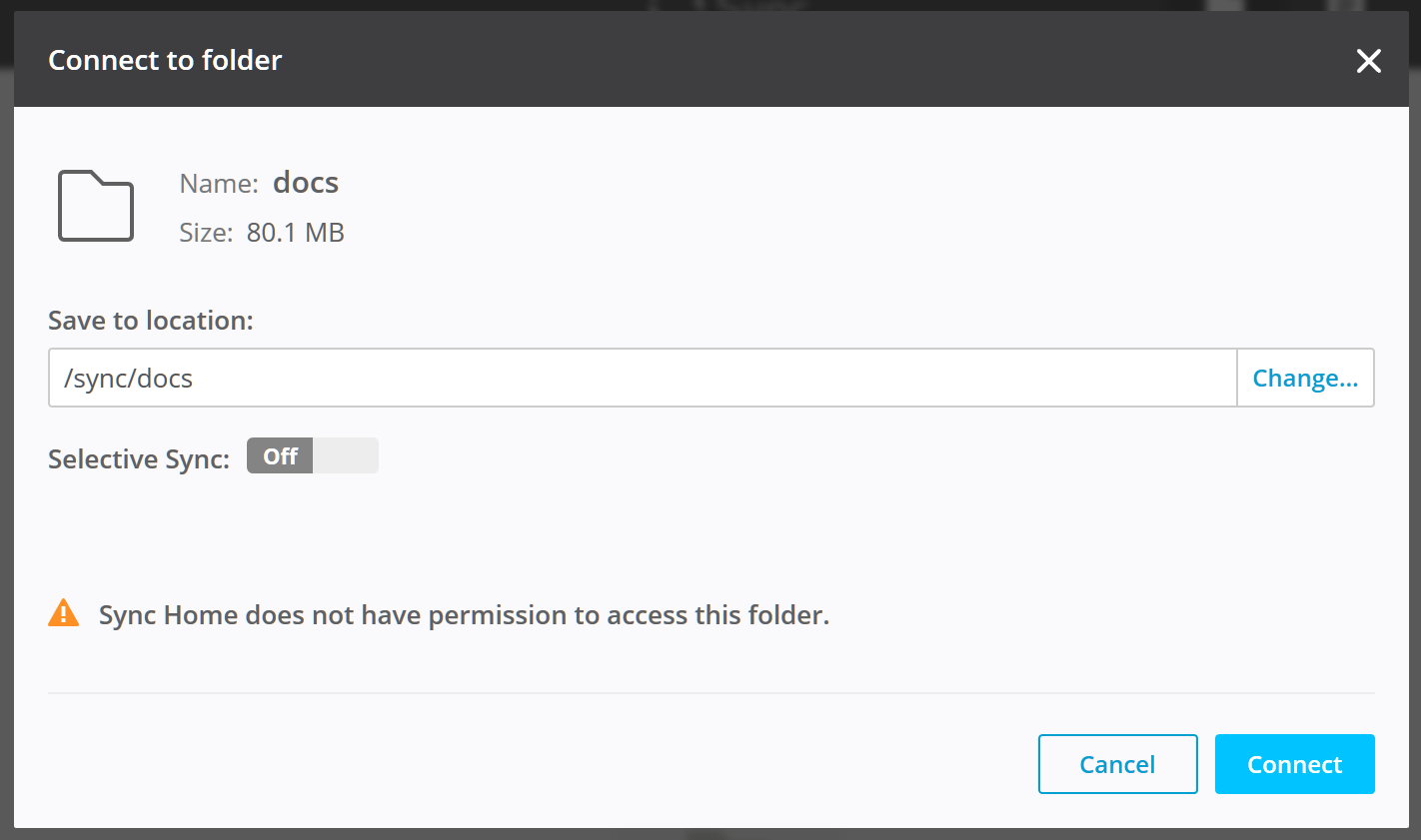

I would like my /sync folder to be inside the array, not on the cache drive. To that end, I set /sync to /mnt/disk1/ResilioSync, created the directory, made sure user:group was 99:100. When I try to create a manual folder connection, enter a key pasted from sync on another machine, and use the path in the "Connect to folder" dialog as set by they share/key to /sync/docs (for example) and press "Connect", the dialog says "Sync Home does not have permission to access this folder."
What am I doing wrong?
Thanks,
- Eric
Edited by eweitzman
Does the folder ResilioSync/docs exist on disk1?
If not try creating it manually and restart the container
I noticed that I missed a "5" in one of the port mappings. It's now "55555". Restarted the docker, it required that I re-enter my license, but still can't access my /sync folder.
This is the docker command now:
root@localhost:# /usr/local/emhttp/plugins/dynamix.docker.manager/scripts/docker run -d
--name="ResilioSync"
--net="bridge"
-e TZ="America/Los_Angeles"
-e HOST_OS="unRAID"
-e "PUID"="99"
-e "PGID"="100"
-p 8888:8888/tcp
-p 55555:55555/tcp
-v "/mnt/disk1/ResilioSync":"/sync":rw linuxserver/resilio-sync
681779083c4b4f12353f7b043d9c782d1c5790e22475ce44a948a35eb8845c5a

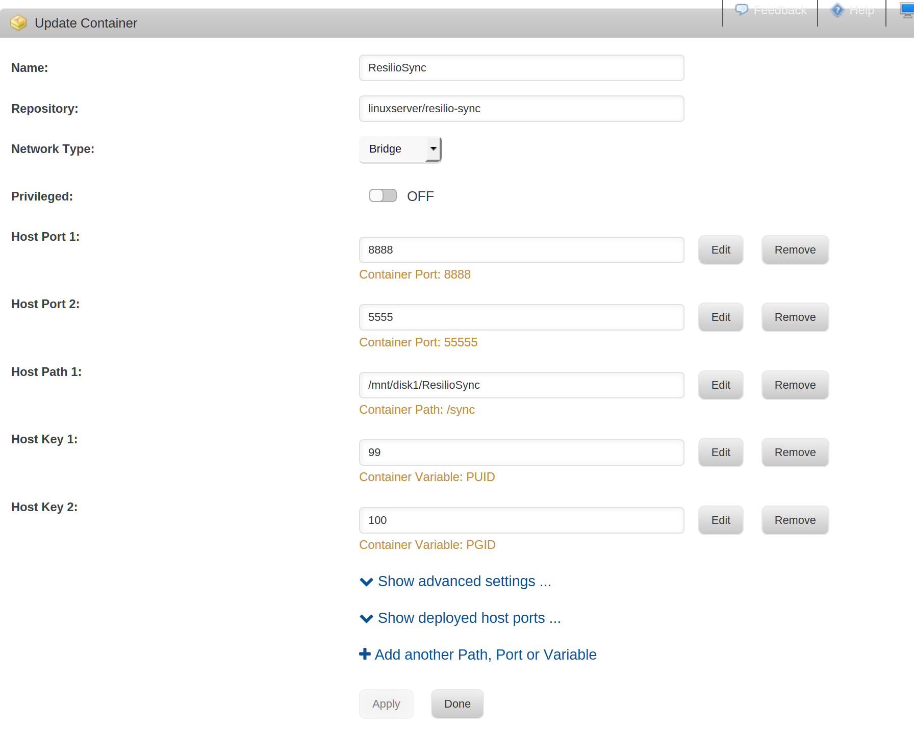

--net="bridge"
-e HOST_OS="unRAID"
-e "PUID"="99"
-e "PGID"="100"
-p 8888:8888/tcp
-p 55555:55555/tcp
When you did the initial setup did you change the user from abc?
Yes. I used user "unraid-sync".
