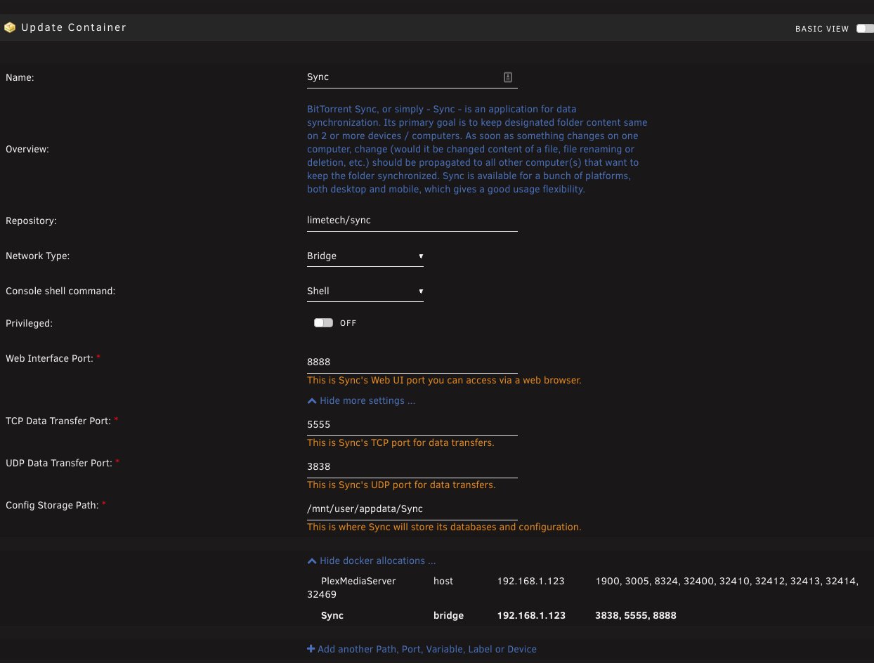

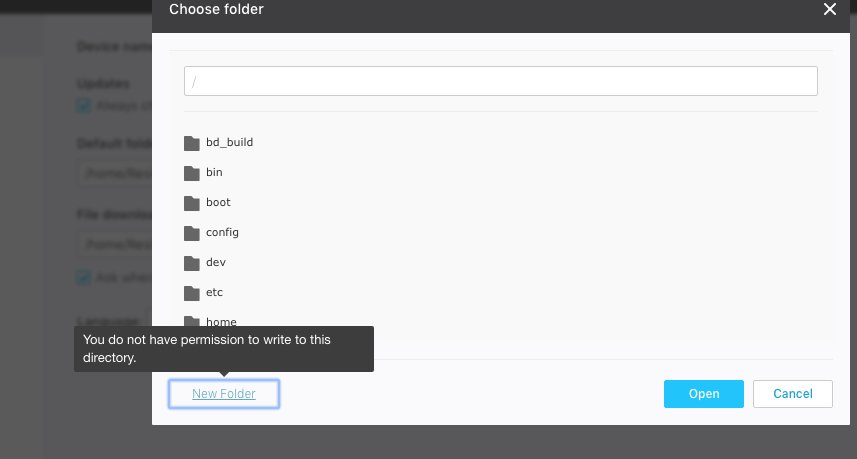

I need help!

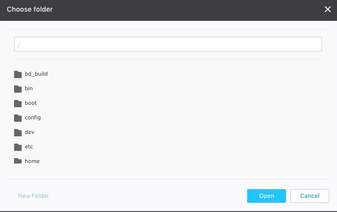

I have installed and used Resilio Sync on Mac and Synology without any issues.
I cannot configure Resilio Sync for UNRAID.
I do not know how and where to add share folders.
When I want to choose a folder to sync, I do not see the list of my share folders, but some other folders I do not recognize (bd_build, bin, boot, config..etc).
When I want to create a new folder, error message states "You do not have permissions to write to this directory".

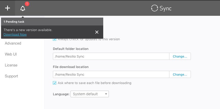

There is an annoying alert that asks me to update app. Then routes me to https://www.resilio.com/platforms/desktop/ which does NOT list download site for UNRAID.
I have never encountered these difficulties when setting up Sync on Mac or Synology. This is frustrating.
Does anyone know how to set up Resilio sync so that I can normally select shares to sync with???
Below are screen shots.

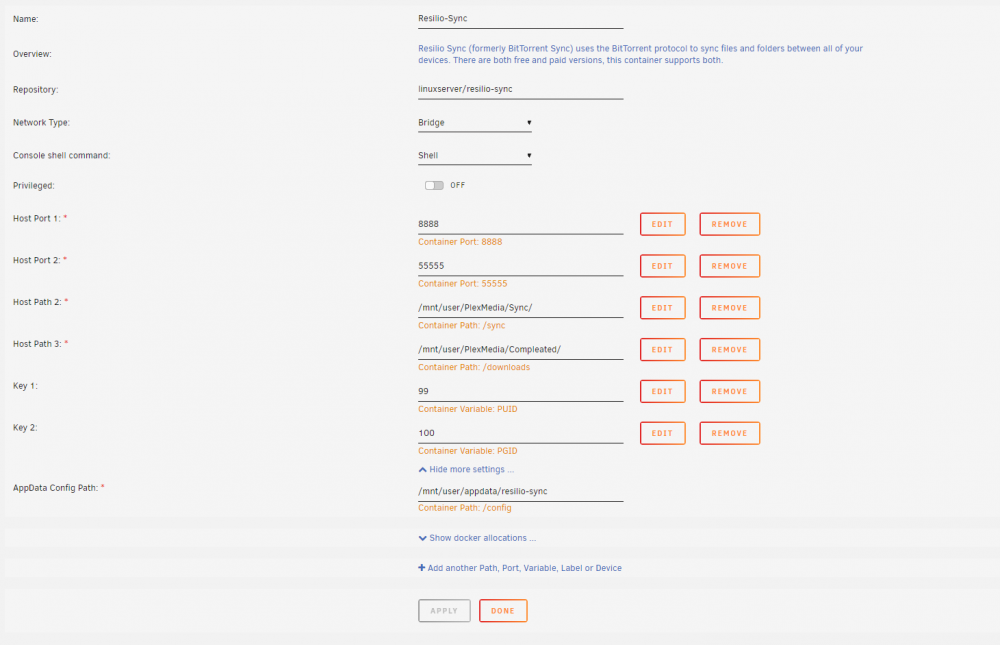

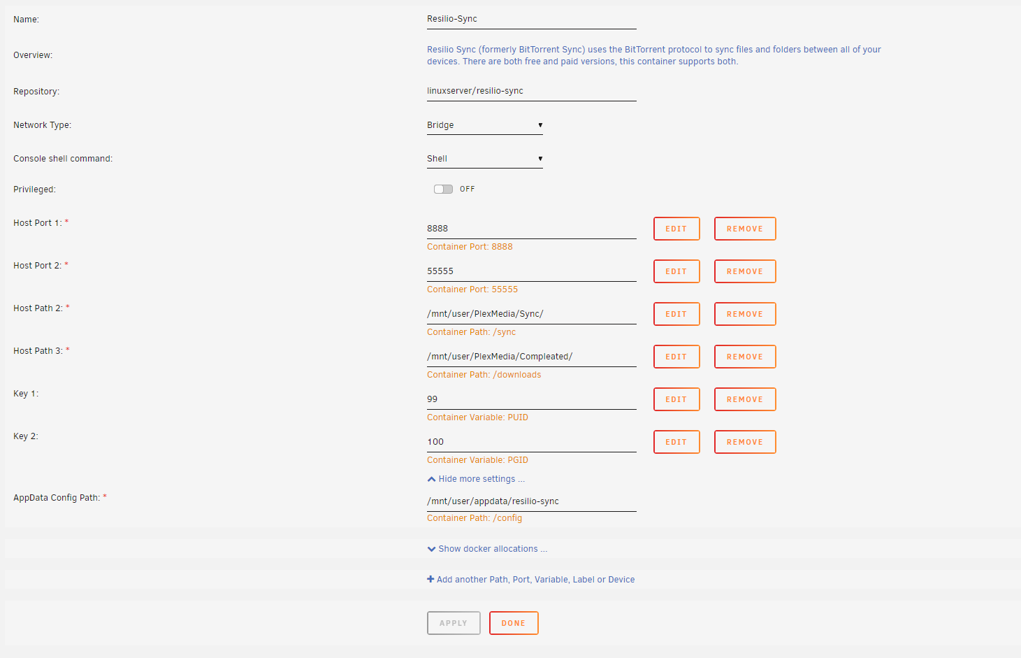

It's been a bit since I've installed the docker, but it looks from your screenshot that you're missing some configuration options. Here's what mine looks like. "Host Path 2" is what shares I'm syncing. In my case I passed through /mnt because I'm syncing disk-to-disk between two Unraid systems.
EDIT: I see you're actually using the Resilio from the limetech repository, I'm using Linuxserver's repo. Not sure what settings to use or not use on the Limetech version.
Edited by master.h
+1 for the linuxserver option.

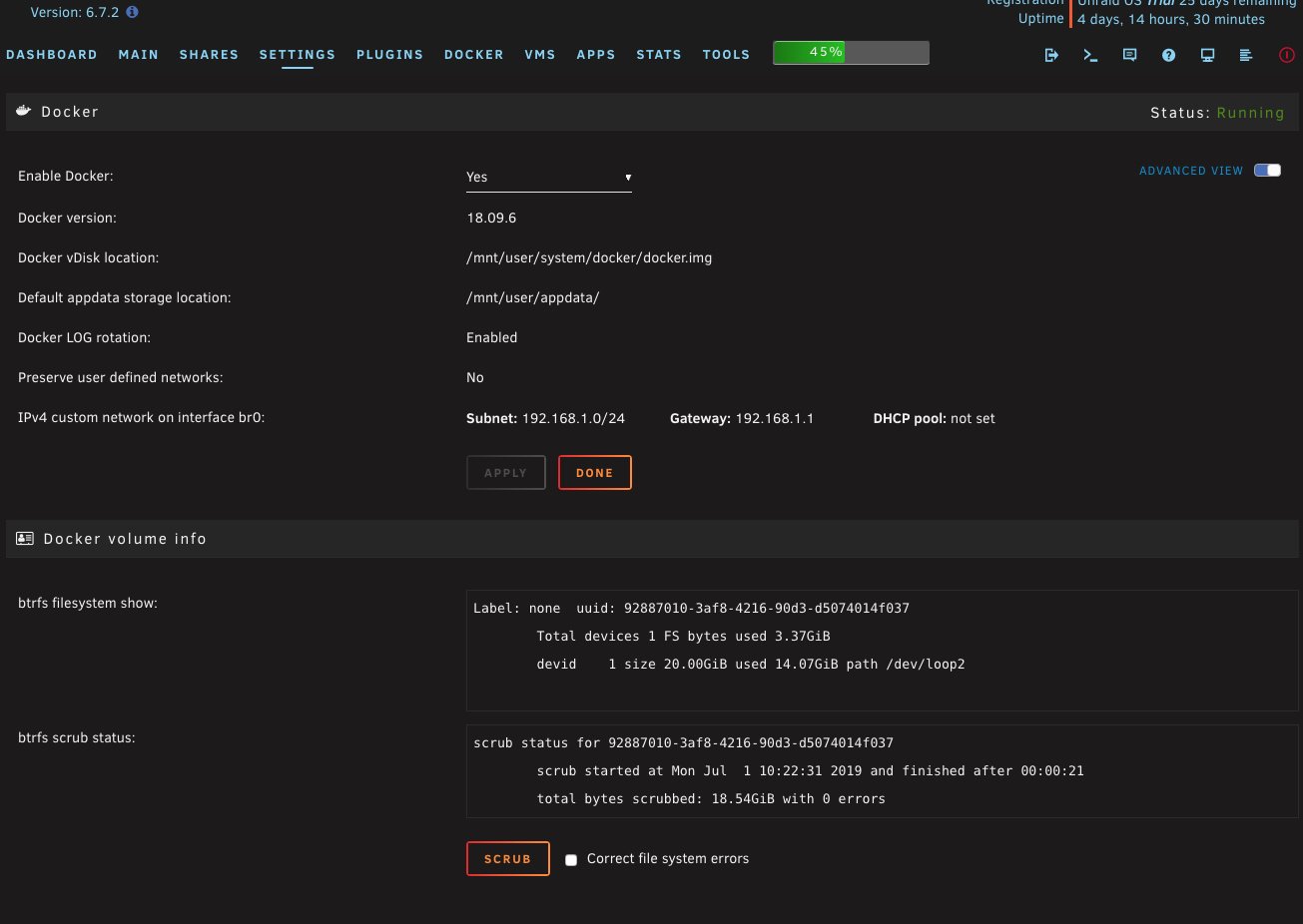

NEW ISSUE!
- My docker image filled up to 93% (from 20GB of total space)
When going to Docker-->Container Size, it shows:
Name           Container .   Wrtiable      Log
resilio-sync .  122 MB        302 kB        15.3 GB
It's clear Resiolio-sync is filling up my docker image with log files.
How do I flush (clear) log files?
How do I prevent this from happening again?
thanks.
I can't remember off the top of my head how to clear logs, I think you can force an update on the docker and it'll wipe all the logs. To prevent it you can add this to the "extra parameters" field week you're editing the docker with the advanced settings button turned on. It will limit your max log size to 50 megabytes
--log-opt max-size=50m

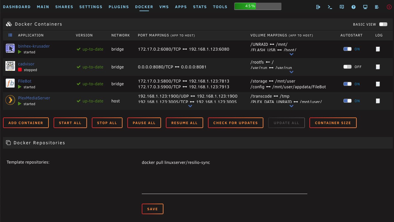

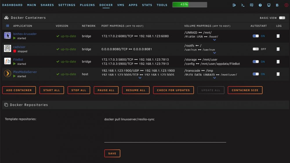

In UNRAID, I went to DOCKER tab, clicked on "Add Container", then under "Repository: entered above link. The command failed. With both links.
So, how do I do it?
Do I go into terminal window and then enter "docker pull linuxserver/resilio-sync". If that is correct, please tell me in WHICH folder in terminal should I be "sitting in" when I execute the command?

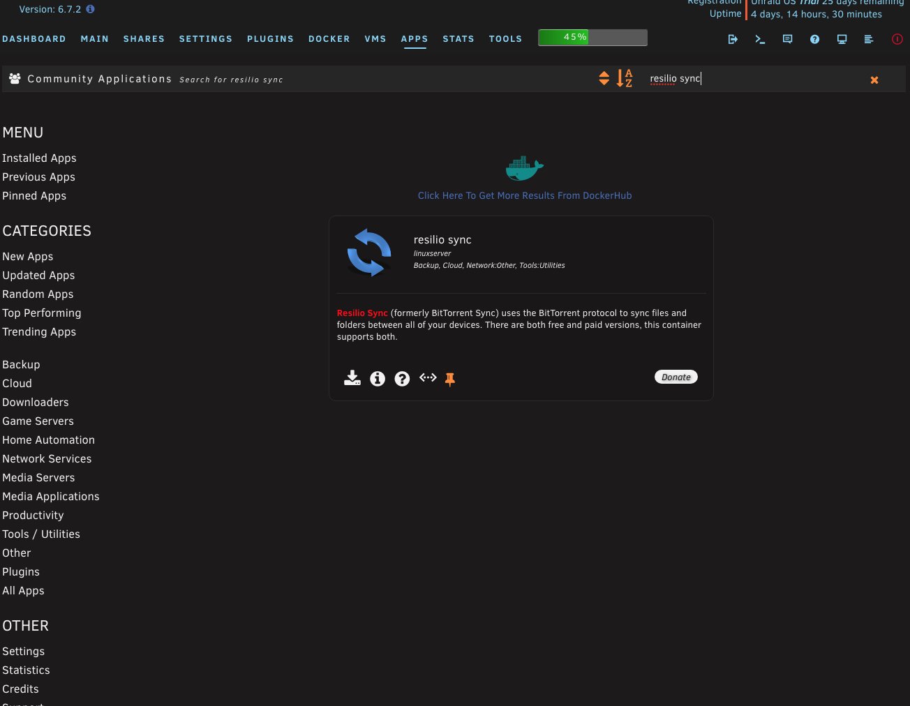

I installed the plugin Community Applications on my server. It will add an "apps" tab to your main Unraid webpage. It's sort of like the iOS app store, or Google Play app store. Search/browse for the docker/plugin you want, and it automatically installs from there. You can download the plugin here: https://forums.unraid.net/topic/38582-plug-in-community-applications/
That's how I install all my dockers. I don't know how to add repos in manually.
Ah, ok.
I just realized there are TWO docker images in APP tab for Resilio Sync. I installed the one from linux server via APP tab and Community Applications.
Let's see if it works.......and if, with correct /downloads PATH , it doesn't baloon my docker image.
Just for future reference, (and for anyone else that reads this post), forget that the "Docker Repositories" tab ever exists.  You'll never use it if CA is installed.  Unfortunately, for various reasons (none of which make sense to me) that section is part of unRaid's GUI, and I am not in the mood to have CA actually delete it.

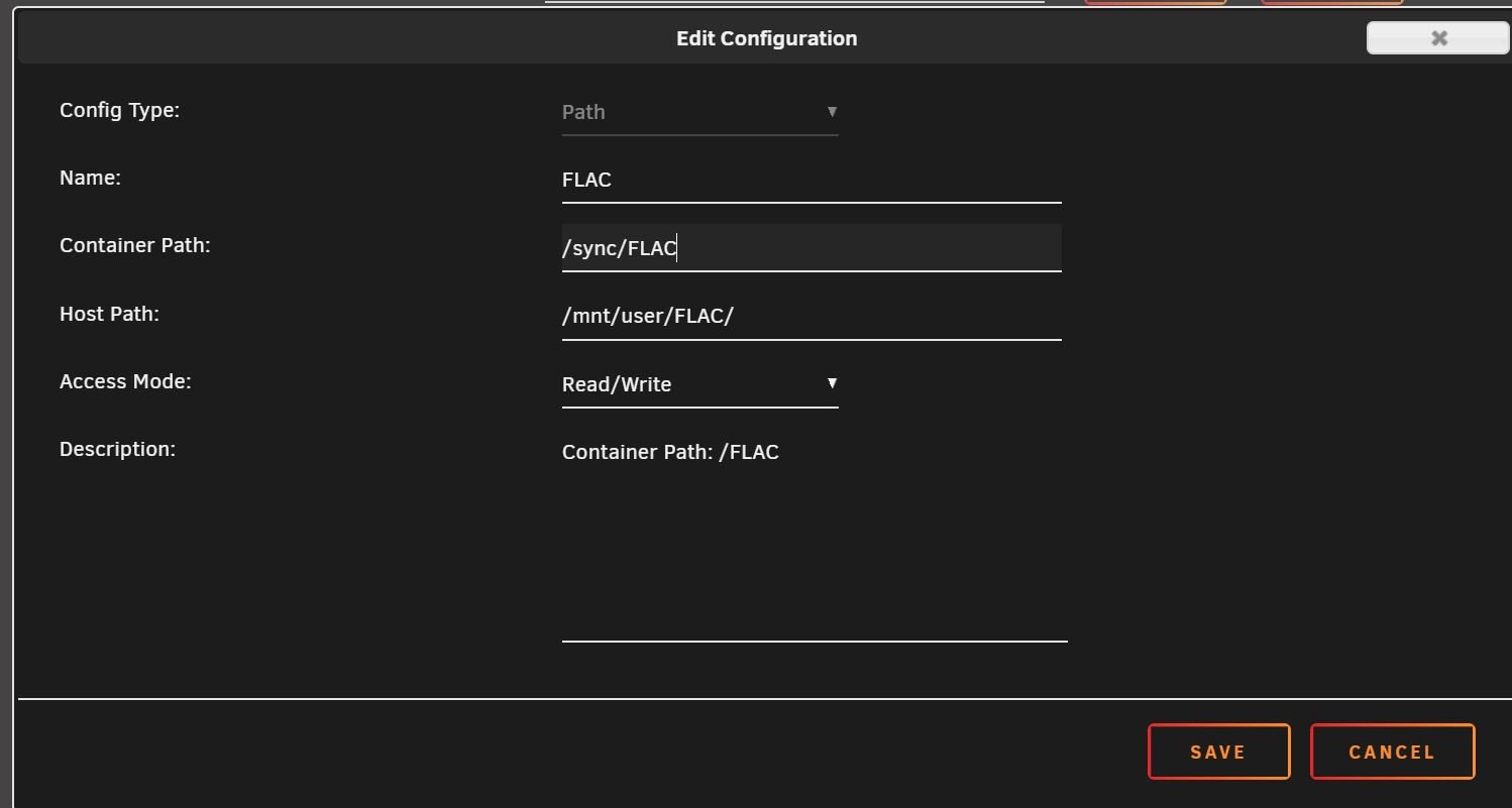

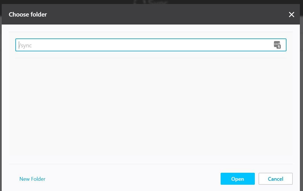

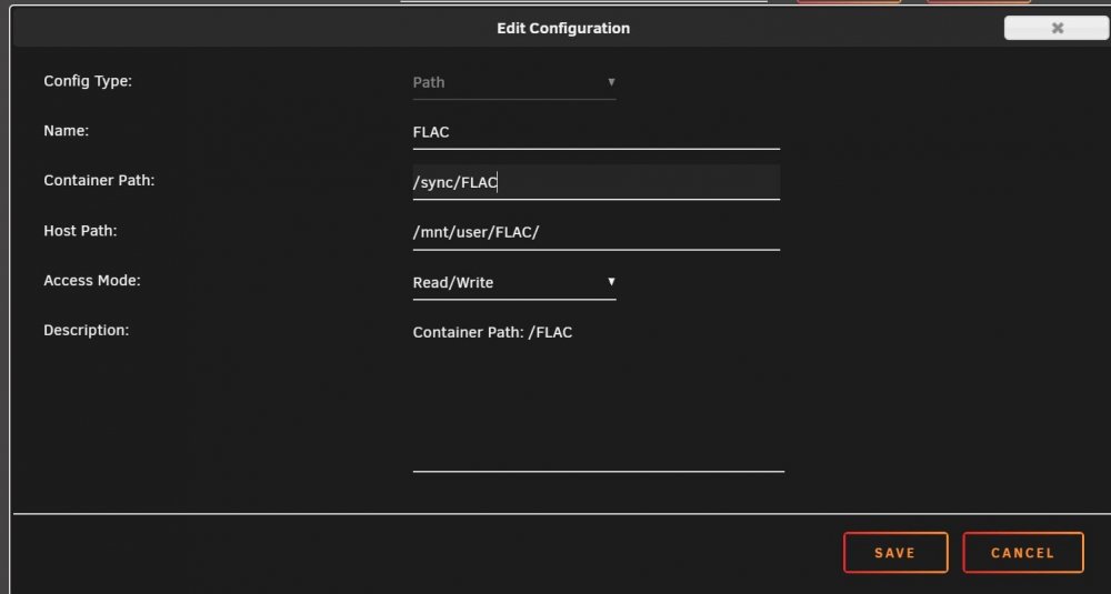

Hey @Froberg, so i did try that first, and removed the /sync folder.  However the container then won't start, it seems like if it doesn't have the /sync folder mapped, the container won't run.
One would assume that when you start sync and then go to add a share, you would see the folders you had mapped, but it only shows /sync, with no way to move beyond that folder and access the other mappings you made
Edited by sdamaged
Sorted issue with the people at linuxserver.  You need to map the container path using a prefix of /sync
Example below
Sorted now.  I found another bug whereby if you remove the /sync share completely the container won't start.  They have raised as a bug.
