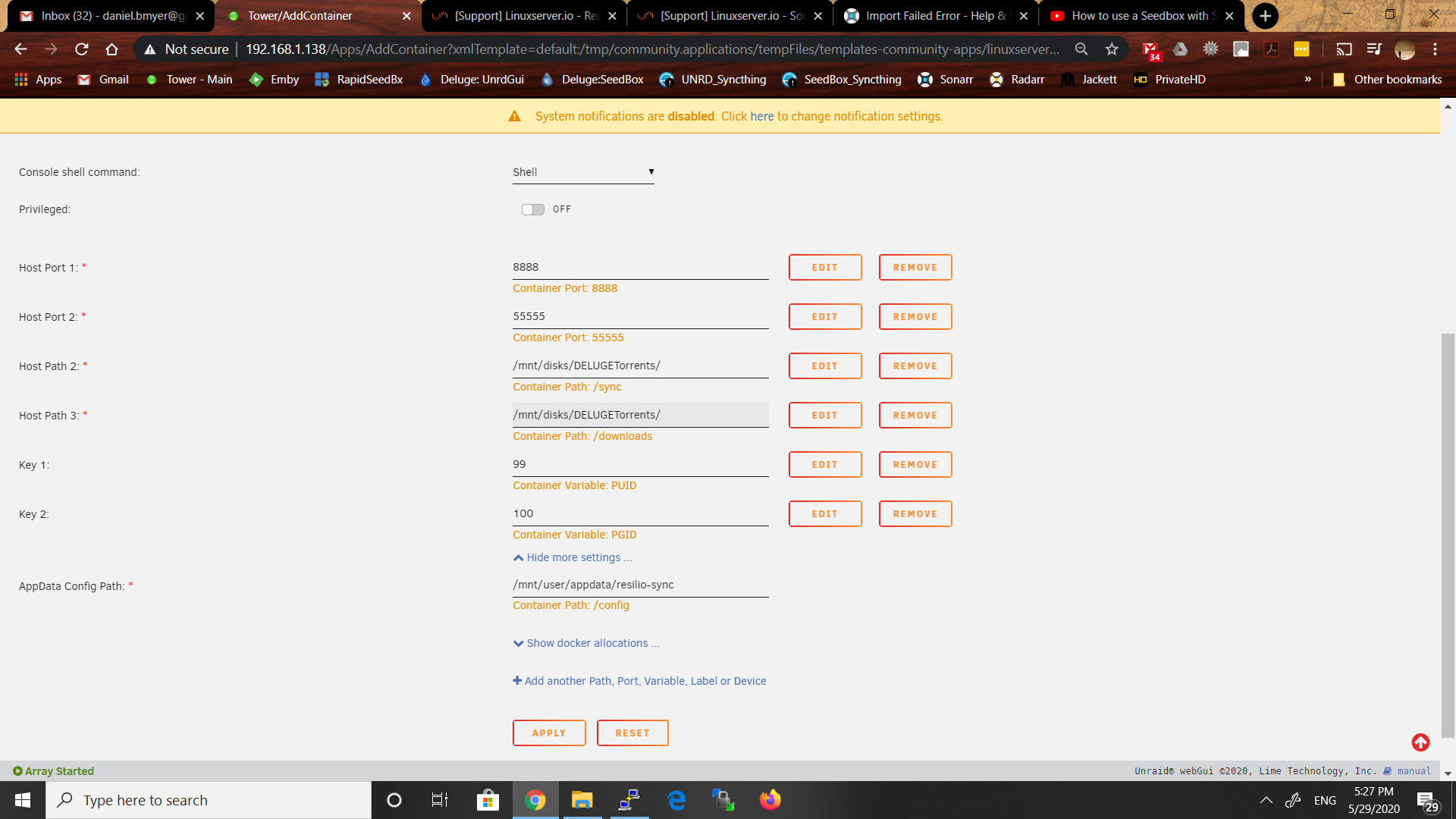

I'm having a problem trying to figure out what I should put for the paths when installing this.  I have syncthing installed and am using the following paths.  For Resilio I'm just not sure what to put for the /download path.
The delugetorrents is the name of an unassigned disk and on there is a folder where I have syncthing downloading the files to so Sonarr picks them up.  I'd like Resilio to use the same.  Can I have the /sync and /downloads the same?
Syncthing
Resilio
Edit..Update.. I forgot that i had posted this.. It's now fixed and it's very simple, go down a couple of posts to see the solution.
Syncthing
Resilio
depends on use case but yes you could.
for me i never use the download. i just want sync.
i have mine set to sync -  mnt/user/
    and           download -  mnt/user/download
but for me i sync folders that are in /user as separate jobs.
so your question is not an easy one to answer but i would say try it and then tell us if there is an issue.
