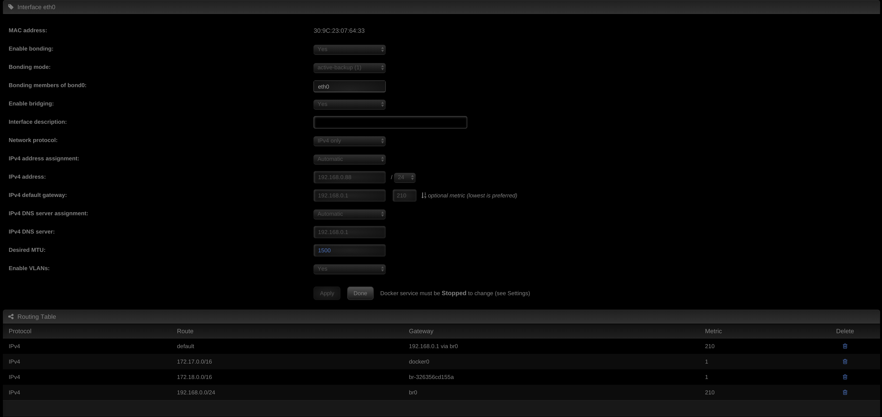

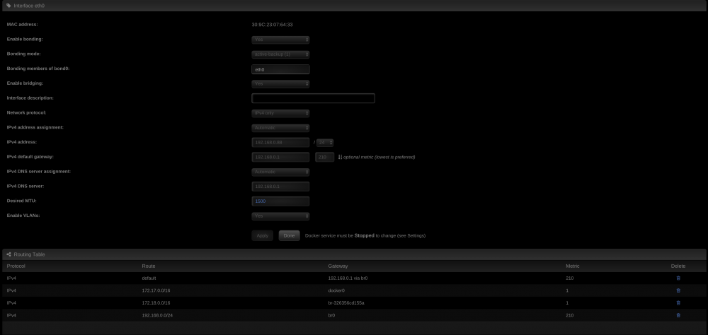

So I am so lost in where I am going wrong here and I hope it is something obvious that I'm just missing. Below is the log I get from the docker

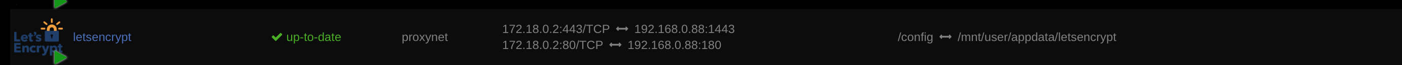

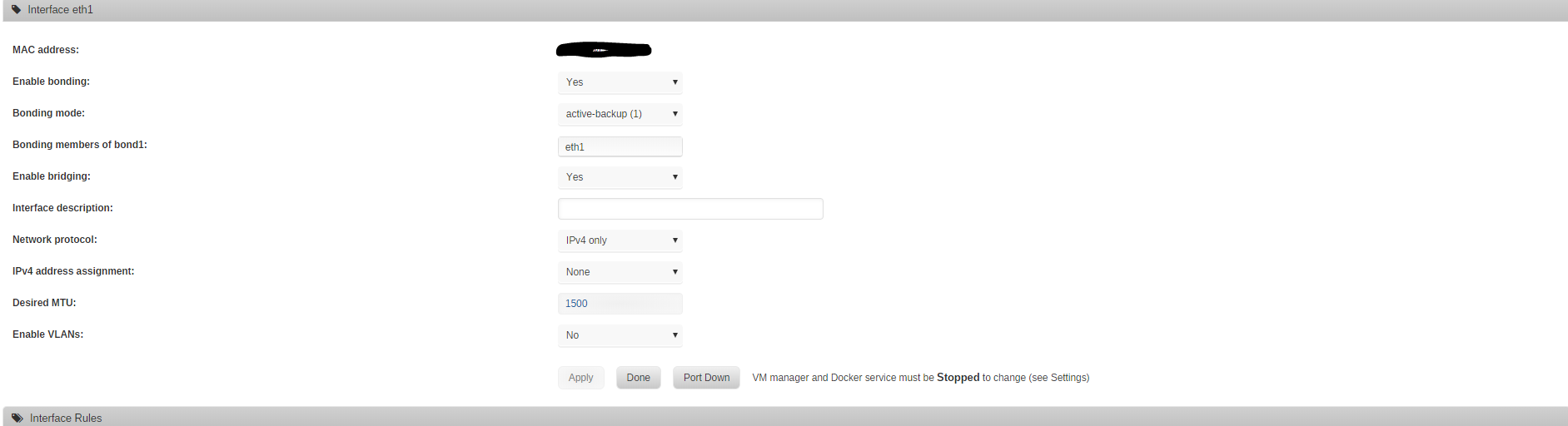

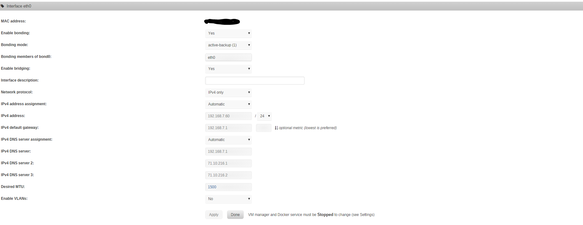

My unraid network settings:
My LetsEncrypt docker settings:

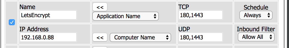

My port forwarding in my router:
Based on other posts here I've already checked and made sure my ISP doesn't block port 80. I also tested to make sure the port forwarding is working correctly by temporarily putting another docker on the ports I have letsencrypt set to and it was accessible externally from both, so the forwarding looks correct. My server is using duckdns to keep my IP updated. Anyone know what might be going on here or have things I can try?
Link to comment
Your port forwarding is incorrect. You need to forward outside port 80 to host's 180
Link to comment
Ahhhhh I see, I misunderstood the settings in my router and thought that was the case with how I had it set. Internal to external port forwarding is under "Virtual Servers" in my router. All working now though!
Link to comment
