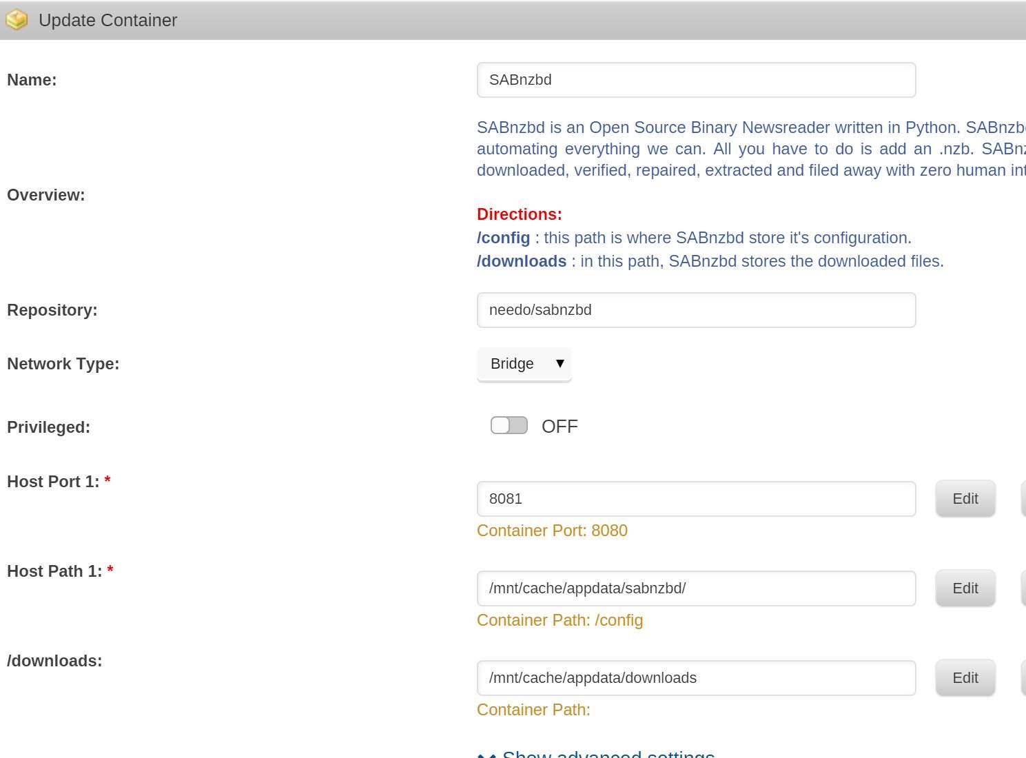

Ok, so it sounds like i need it like this ?
sabnzbd      /config              /mnt/cache/appdata/sabnzbd
Radarr        /config               /mnt/cache/appdata/radarr
                      /downloads    /mnt/cache/appdata/downloads/completed/
My appdata folder resides on cache drive and set to cache only and so is my /downloads folder,. Within sabnzb it is set to download to /downloads/incomplete and when finished, move it to downloads/complete. is this correct ?
17 hours ago, Squid said:
You need to add a mapping to sab of /downdoads to /mnt/cache/appdata/downloads/completed.  And tell sab to move the completed downloads to /downloads

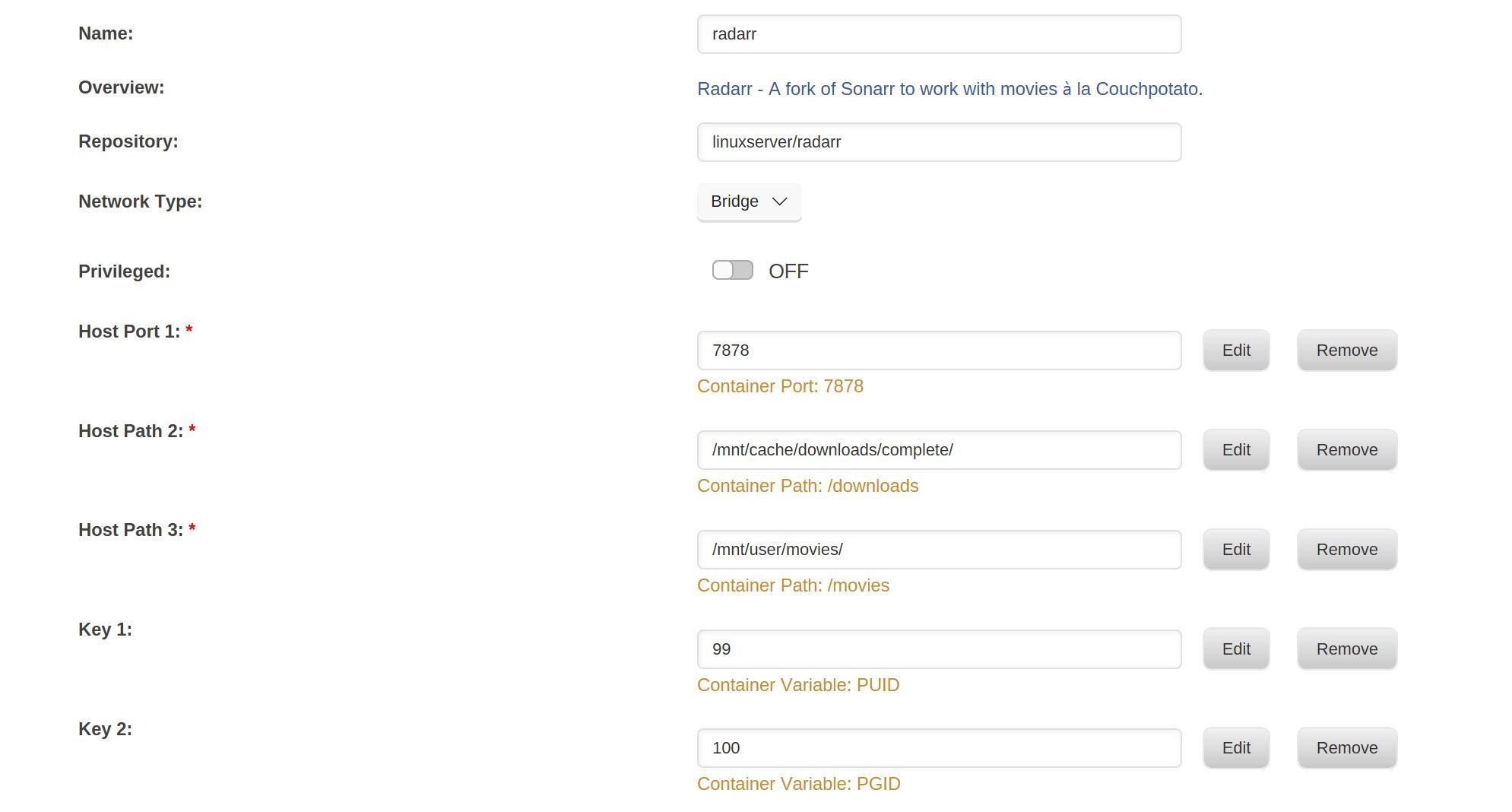

I attached snippets of settings. Sab is being instructed to move finished downloads to /downloads/completed and radar downloads is pointing to downloads/completed.
27 minutes ago, loady said:
am I missing something here?....
Yes, you are missing the understanding of how docker and volume mounts work.
You have used the unraid path in the app setting. You must use the container path. It says it clearly in the screenshot which is the container path.

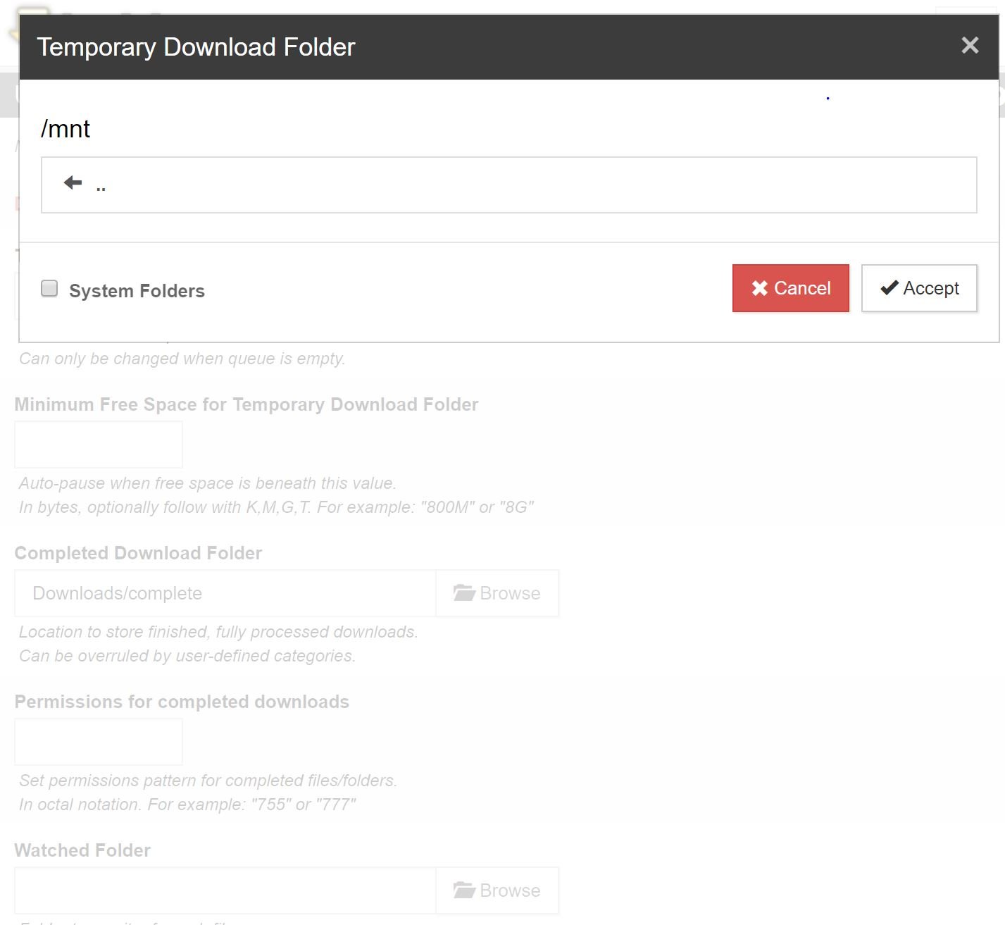

i think im getting there....so if in sab docker template i set a host for downloads and call it /kissmyballs, then this folder will appear as a folder in sab for me to browse to for the downloads
Yes, but you'd also need to map your balls into Sonarr/Radarr so they could kiss them too. Otherwise they'd never find them.

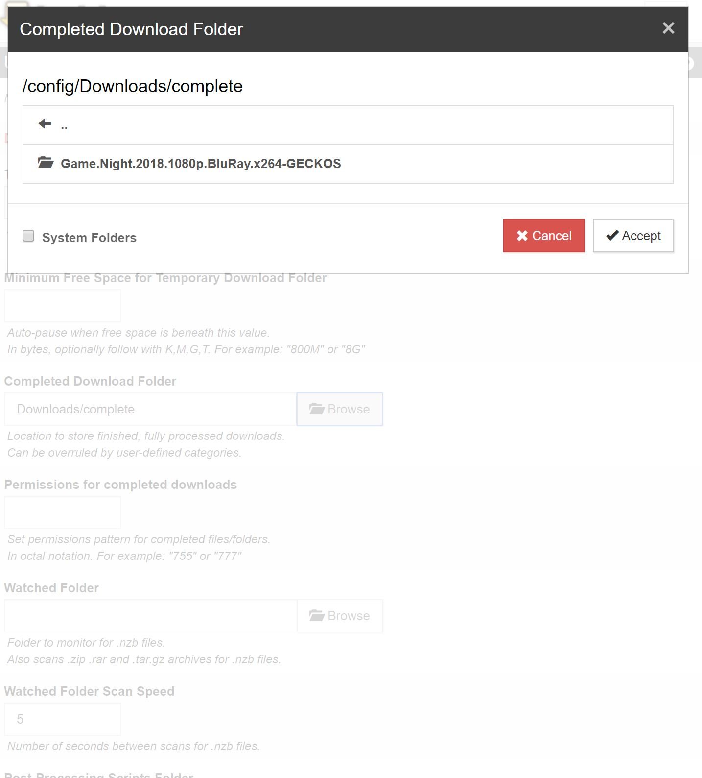

still not getting this...so i wanted to set sab to move movies downloaded via radarr to /movies/radarr so in docker template i set another host /mnt/user/movies/radarr and then i went to catagories to set path but i cant browse to it
now its completly fucked up...set a film to download in radarr and sab has downloaded...saying it is at
Path
/config/Downloads/complete/Game.Night.2018.1080p.BluRay.x264-GECKOS/d1022548832541d9af475869a0a21f0a.mkv
can find it...i never told it to put there ffs
EDIT: found it...its now in /mnt/cache/appdata/sabnzbd/Downloads/complete

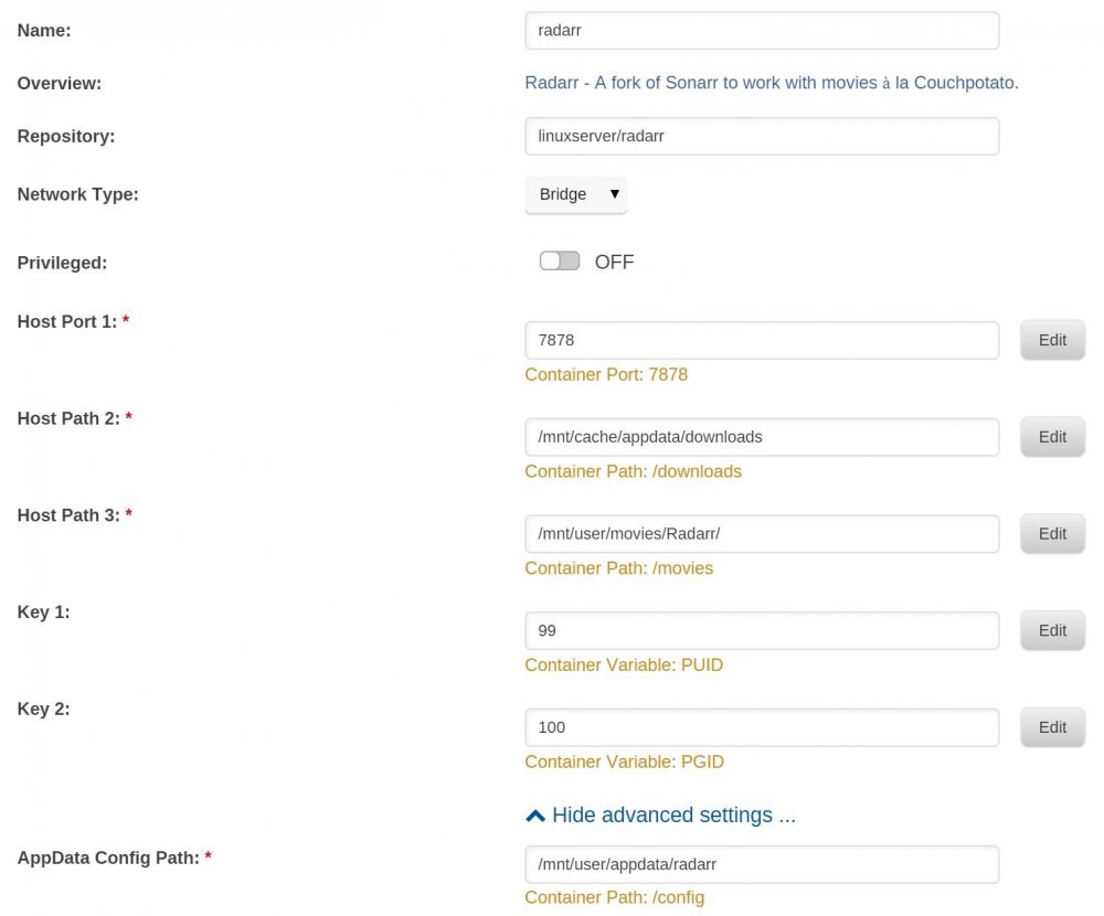

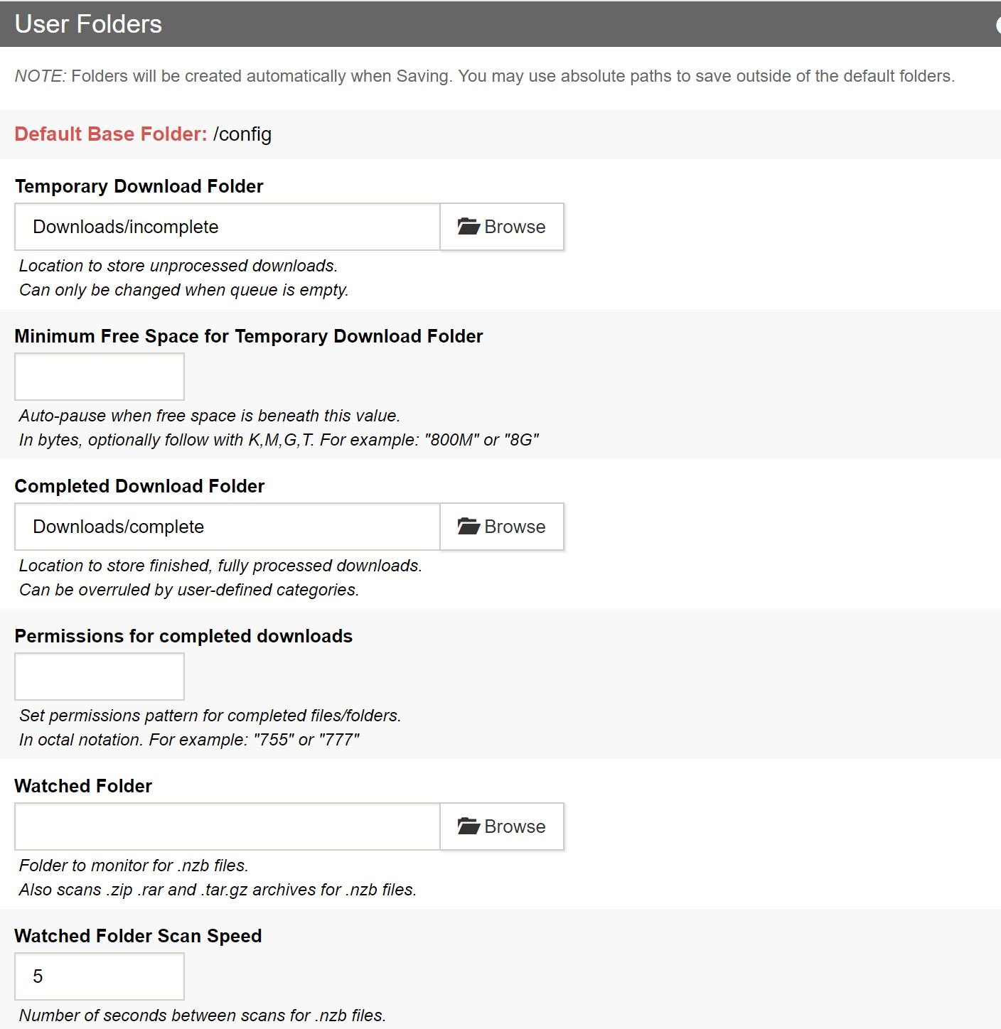

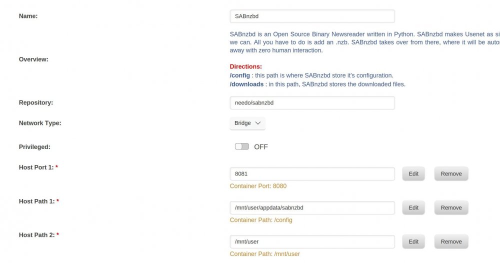

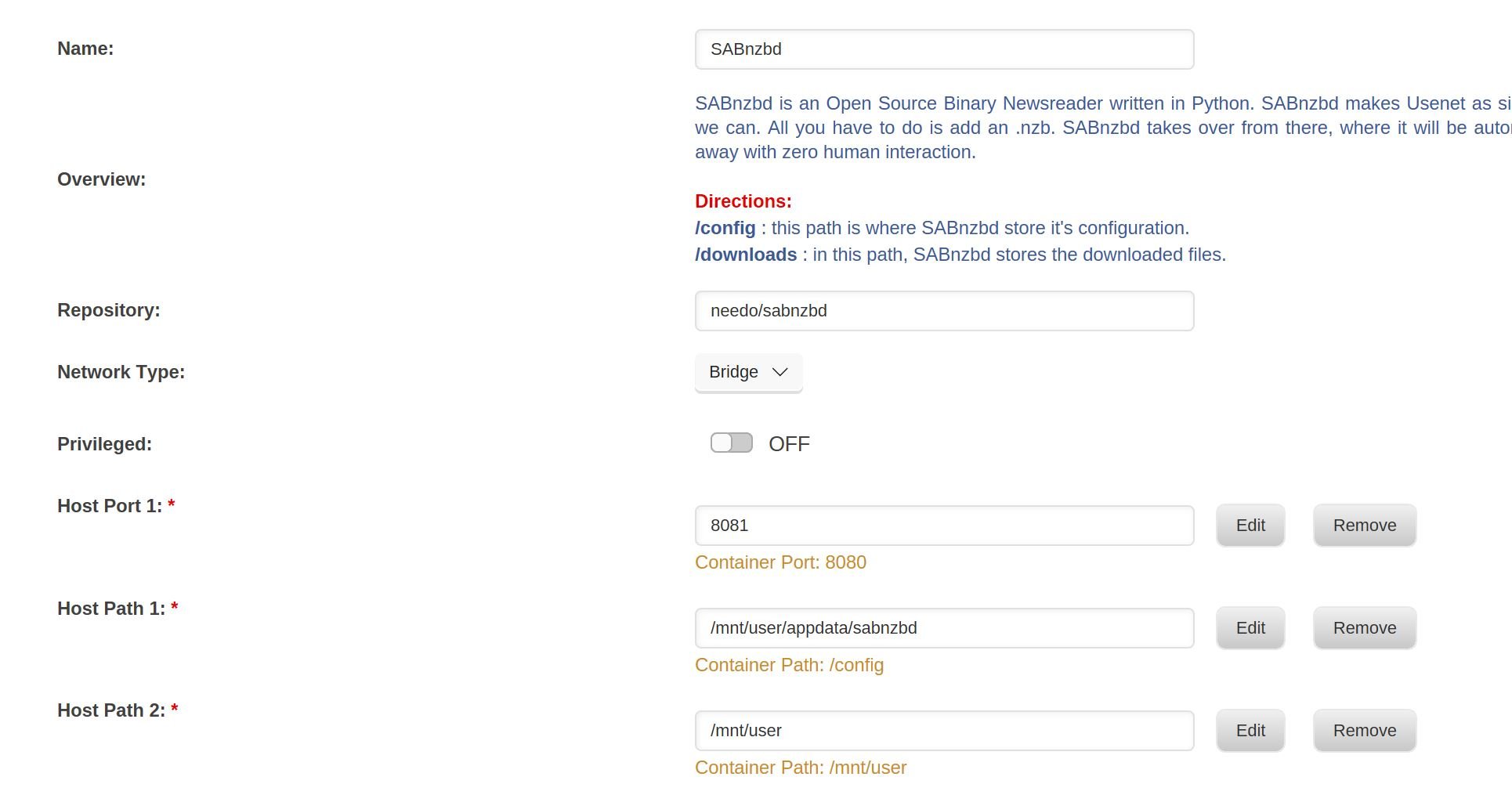

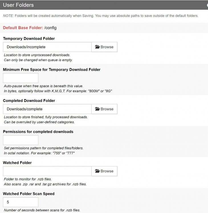

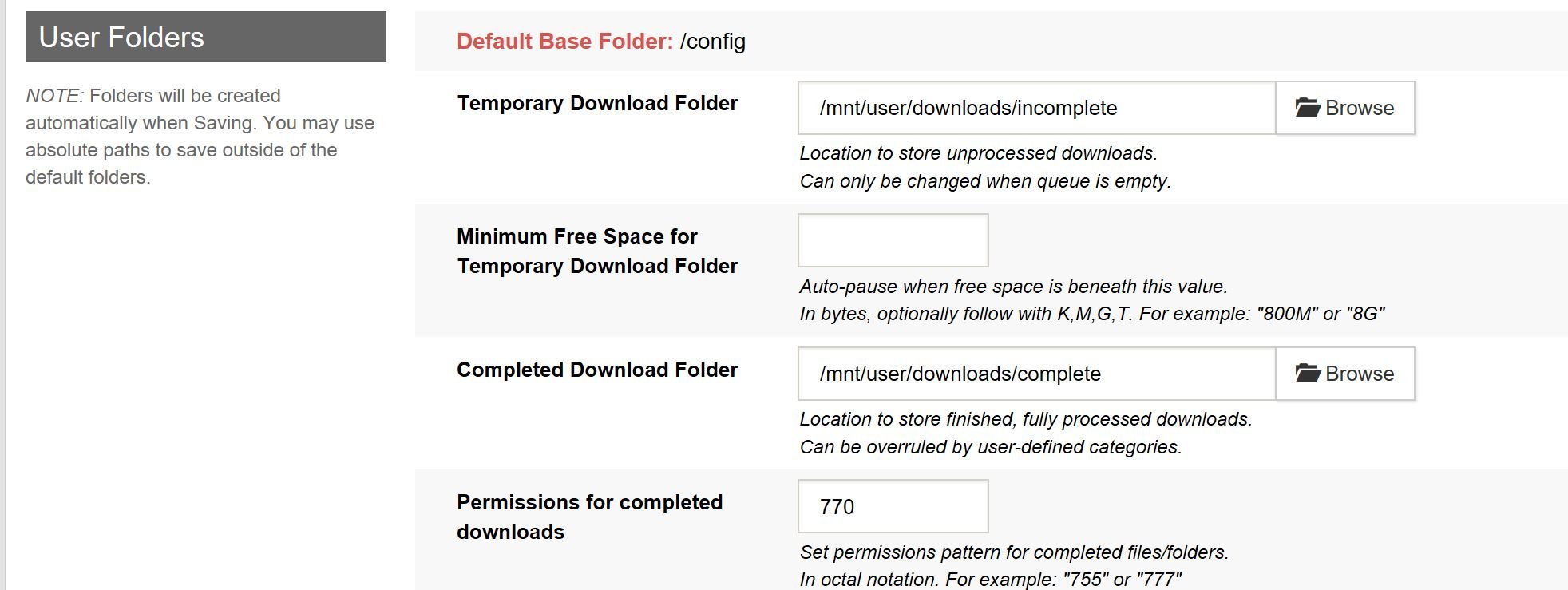

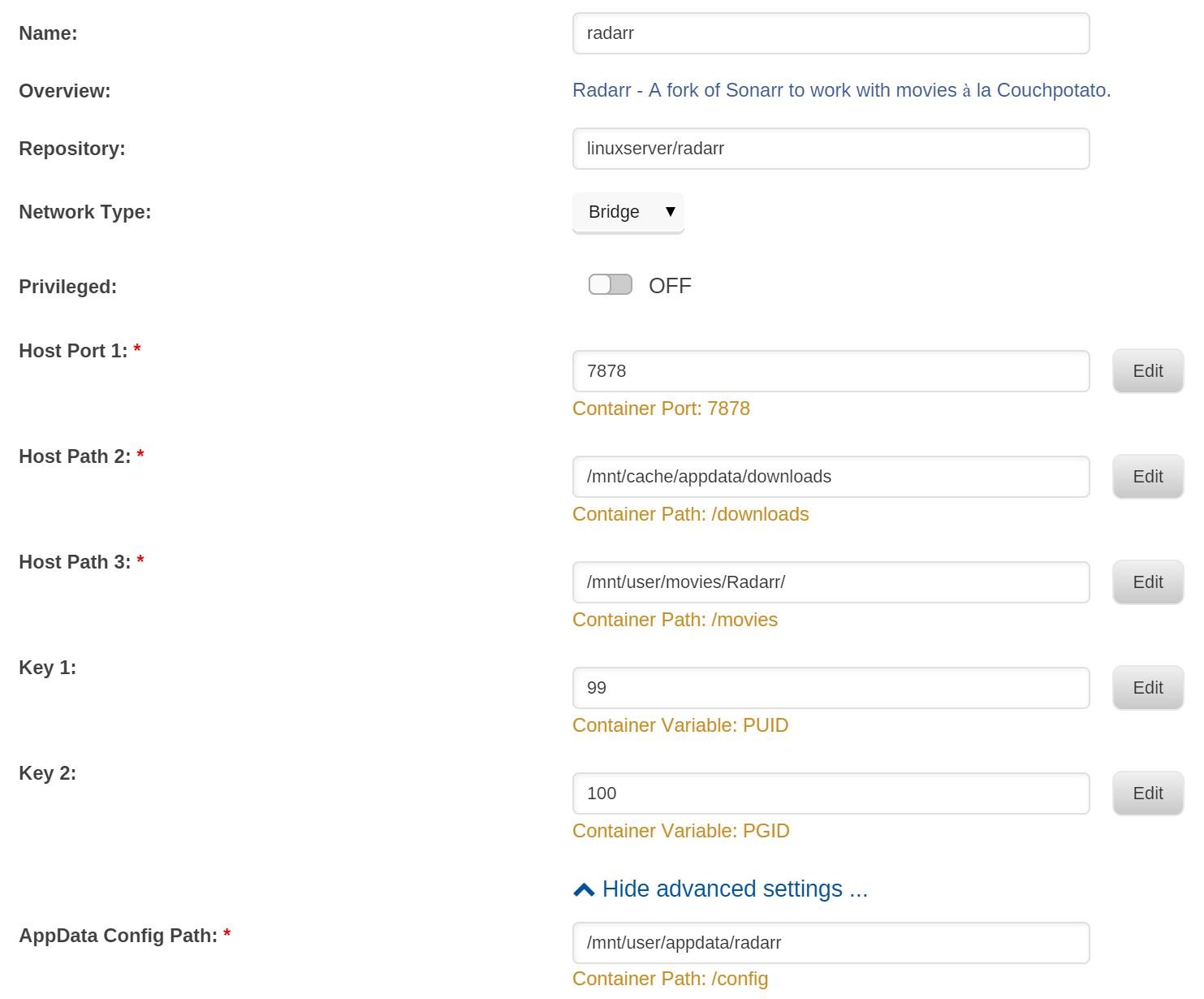

so i have set the paths the same...sab is putting the downloads in /config/Downloads, i can see them there via ftp but radarr not
Look at the sabnzbd settings screenshot, you've got the default base folder as /config
It needs to be /downloads
Also do you really want all your downloads as /mnt/cache/appdata/downloads or did you mean to put /mnt/cache/downloads
