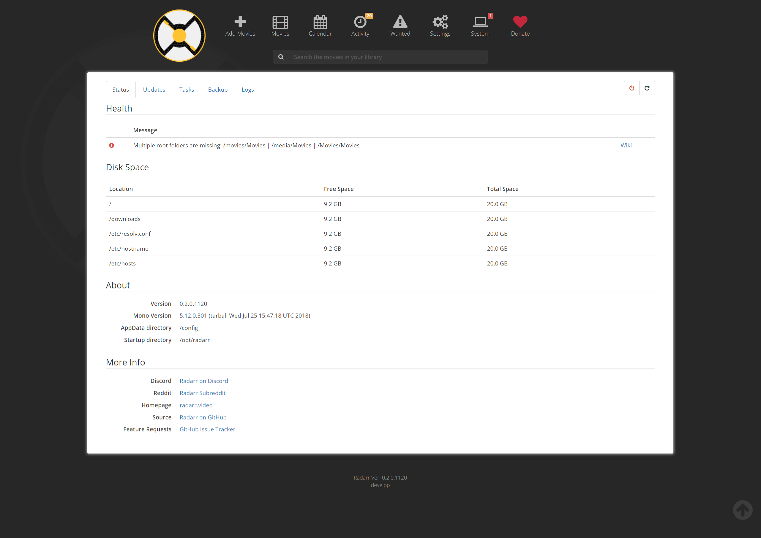

I did some more alterations of settings and now get this error.  Do you think if i delete and re install this will resolve the issue?
screencapture-192-168-1-200-7878-radarr-system-status-2018-08-02-19_18_05 (1).png
On 7/31/2018 at 10:23 PM, CHBMB said:
It's a remnant of that, no idea how to fix it, might be worth asking the Radarr guys.....
Hi CHBMB,.
I hope you're well dude.
50 minutes ago, Greygoose said:
Hi CHBMB,.
If the delete and reinstall includes deleting your appdata and starting from scratch completely, yeah, I'd imagine that would fix the issue.
I apologize if this is a silly question, how bad of an idea would this be if you had a large personal collection of movies in your radarr?  I understand the movie backups would be fine, just unsure what the appdata contains and the time to replace?
Well you'd have to import your whole collection back into Radarr, that might take a while.

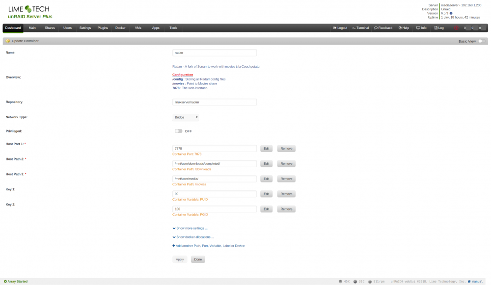

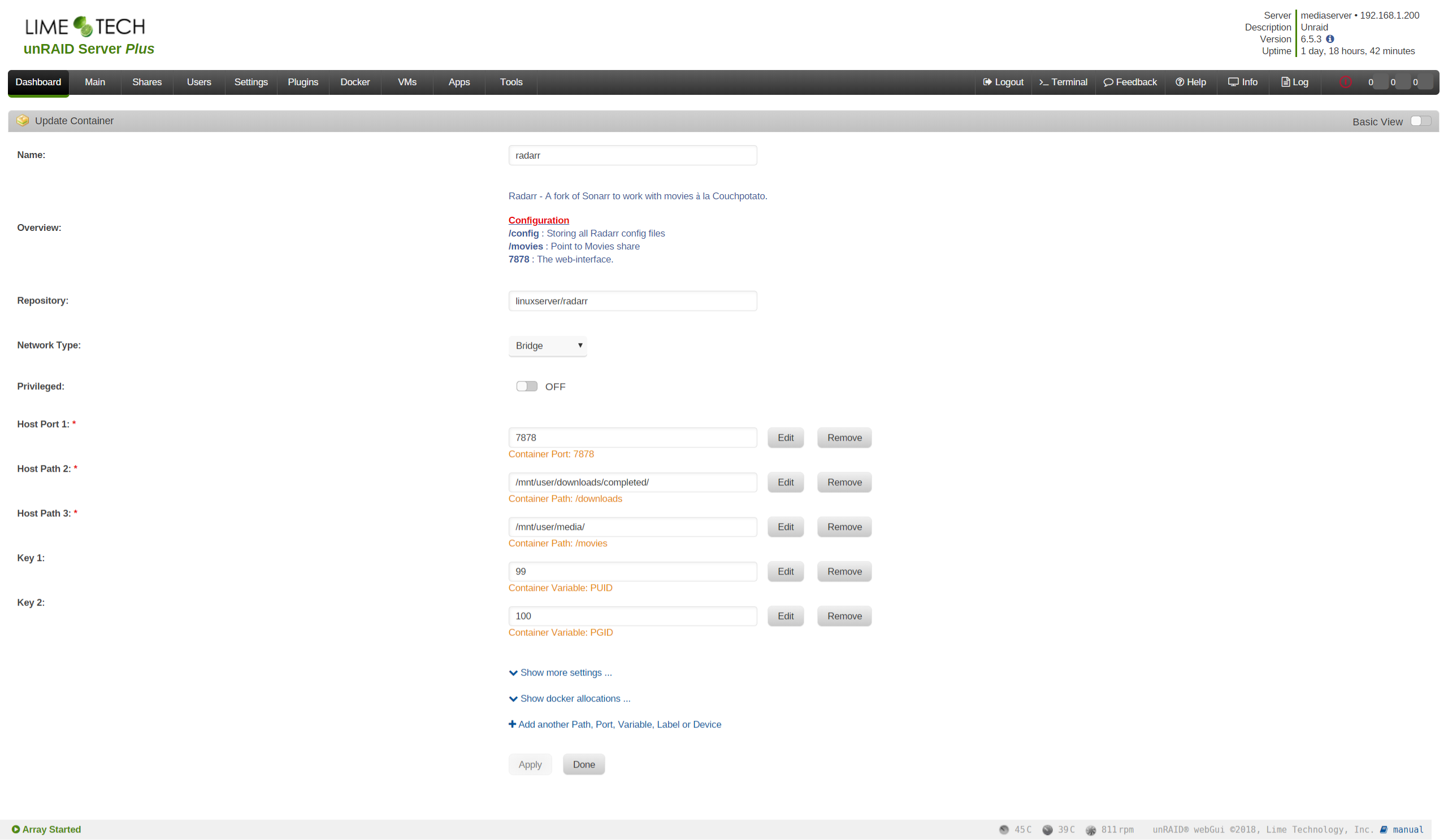

Hi CHBMB,
 I have re installed Radarr, all back working except the auto rename and move to media folder.
Import failed, path does not exist or is not accessible by Radarr: /data/completed/
screencapture-b4fd9fb505226e1d2422be93a9c2f61cb5f9fe8a-unraid-net-Dashboard-UpdateContainer-2018-08-05-17_06_44.thumb.png.8d969cd950d9f93571bd97207d10c141.png
