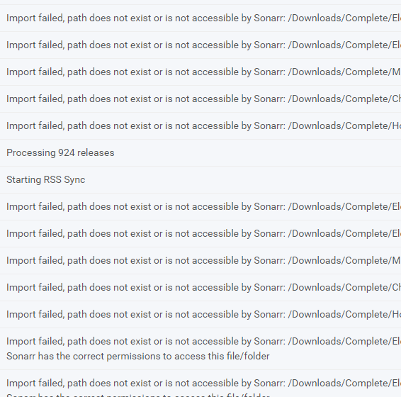

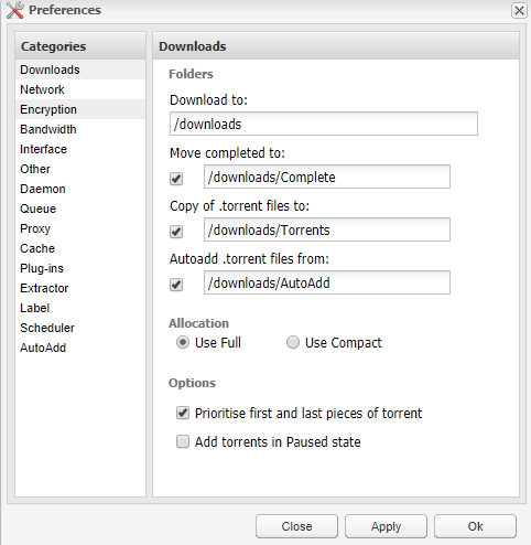

Thanks for the reply! I think I have it all changed, but it looks like Sonarr and Radarr are both still looking at Downloads instead of downloads?
Deluge:
Sonarr:

50 minutes ago, LumberJackGeek said:
'/mnt/user/Media/downloads/':'/downloads'
^From your Sonarr
^From your Radarr
'/mnt/user/Media/downloads':'/Downloads'
^From your Deluge
See the difference? They must match.

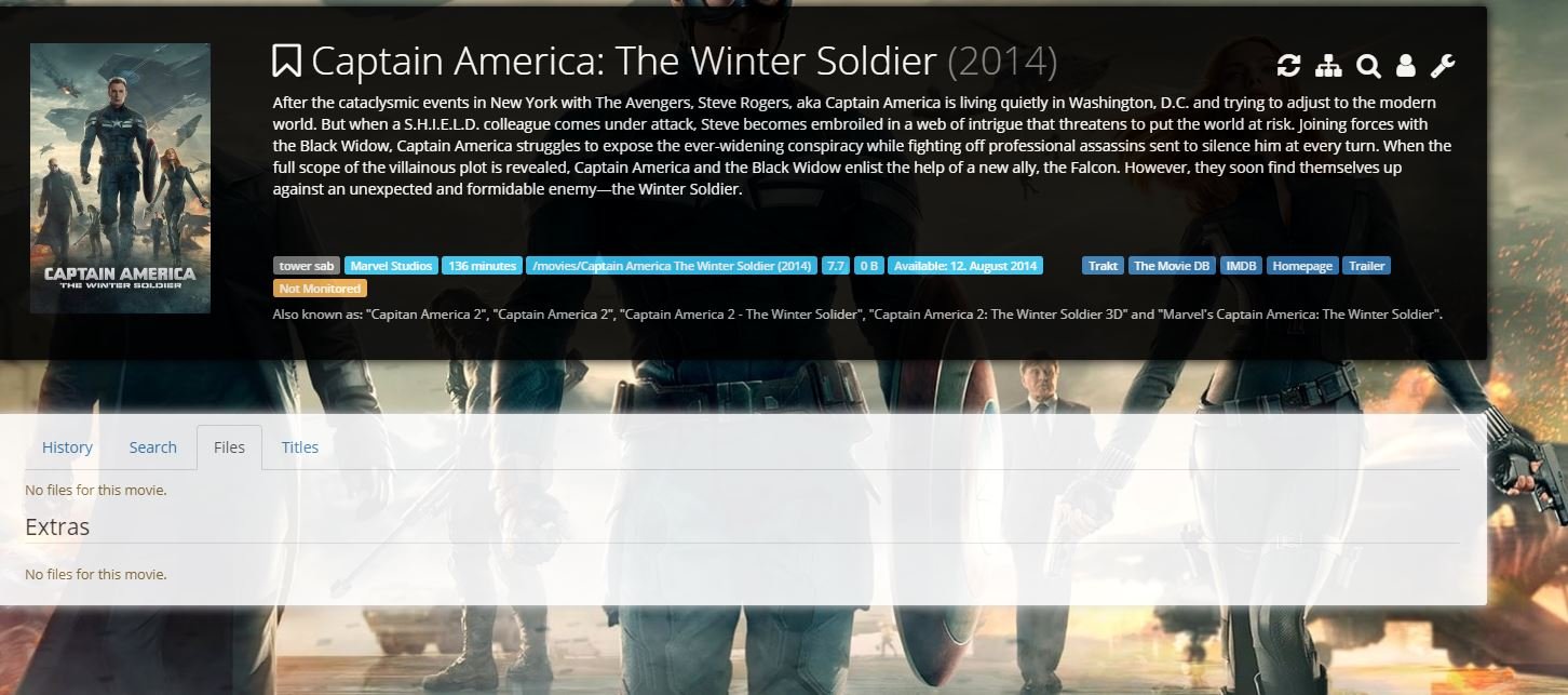

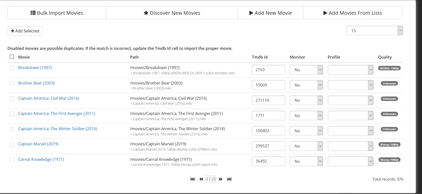

hi all, long time unraid, sab, sonarr and plex user.  recently installed radarr. Imported about 8,000 movies, but about 300 (in pic) are showing as duplicates.  can't figure out why though.  movie appears to be identified correctly and matches file name
any advice on how to resolve??
Because the movie has already been added. Go to that movie in radar, then files, and you will see that it probably was added as an incorrect match

appreciate the reply.  when i go to all of the above, i get 'no files for this movie' as per the attachment.  its my favorite movie, its definitely there lol!  any advice on what's going on ?  i seem to have 360 of these situations...
Then just delete the existing entry and reimport
Sent from my NSA monitored device
Ok thanks again Squid.  So to confirm, go to winter soldier through radarr, choose delete (but not delete files).  Then go to add movie and search for winter and add?  Does that sound correct?

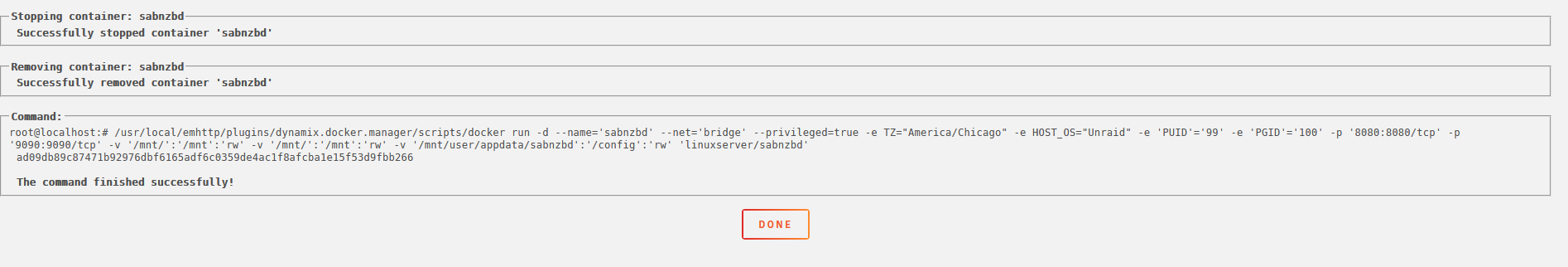

Hi all, sorry to be the slow kid in class.
 so my new problem is i'm getting an error in radarr that 'no files are elegible for import' after a download.  I realized I had sab extracting directly to my movie folder therefore radarr was being 'cut out' of any processing.  have now chnaged sab to unpack movies to a folder called '!unzip'.  but now they are staying there, and radarr isn't processing them and moving them to my main movie folder.
any advice?  totally blank on how to trouble shoot this error

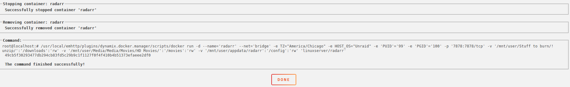

56 minutes ago, Squid said:
Post the docker run commands from Sab and Radar
hi, is this the info?
Edited by grither
