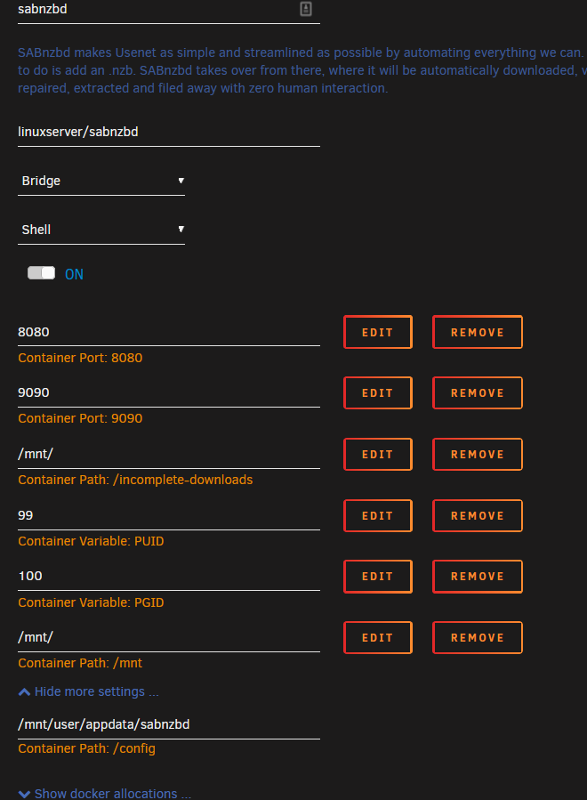

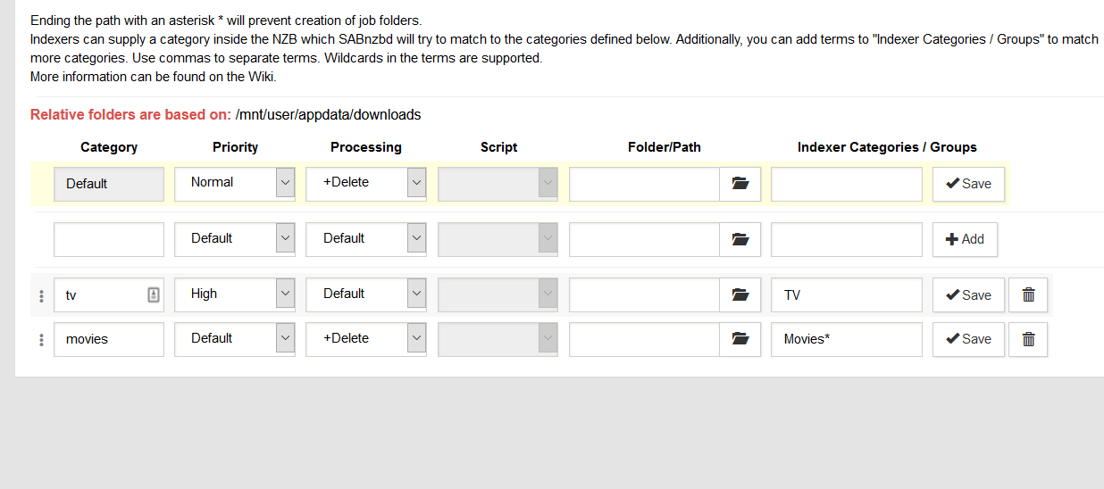

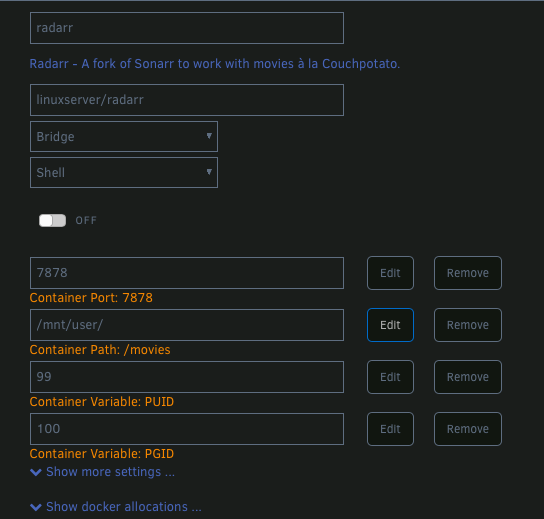

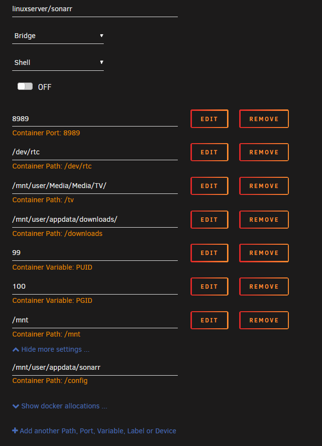

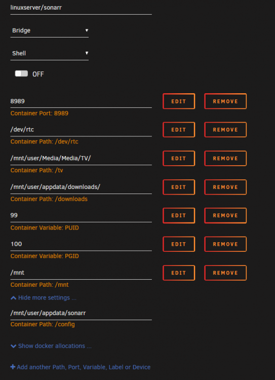

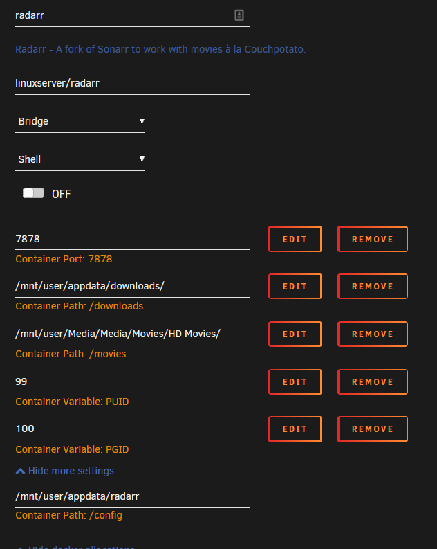

Still having the issue though!!!  I reset all my paths to be in accordance with your advice.  spot anything off?
included my docker settings for radarr, sab and sonarr.  also the categories in sab.  I can select a file in radarr and send to sab, which downloads into the right spot.  but radarr still says 'no files eligible for import
also noticed i have added paths for 'mnt'.  can't recall why there or if they should be deleted
Edited by grither
You shot for sab shows that "Relative folders are based upon /mnt/user/appdata/...."  This works because you've passed through /mnt to /mnt on sab
However, you didn't do that on Radarr, which means that radarr's error message will make it look like everything should be right, but since /mnt isn't mapped to /mnt on it's template, radarr won't have access to the files.
thanks so much!  added the mnt reference to radarr, and successfully imported my first movie!!!  thanks Squid, you are so awesome.  do you have a kofi page or anything where i can contribute my thanks?

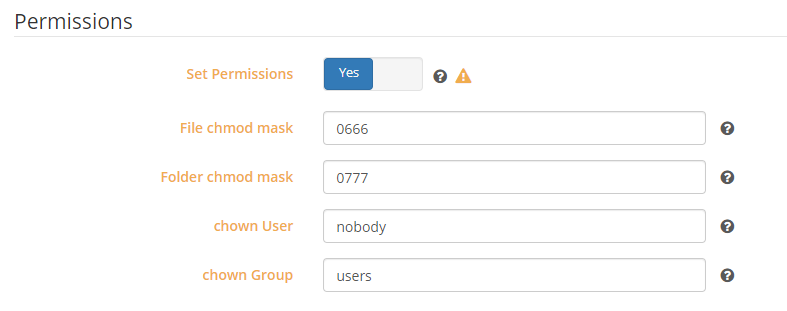

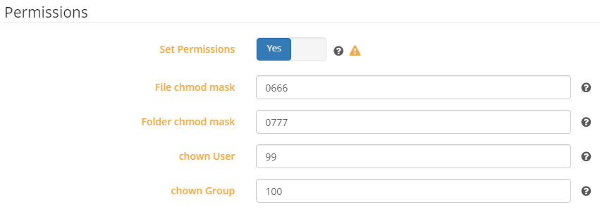

I have been using the following permissions setting in linuxserver/sonarr and linuxserver/radarr and everything has been working fine for some time now.
After an automated docker update a couple of days ago, I am now getting the following error in radarr:
Unable to apply permissions to: /movies/XXXXX: Error setting file permissions: EPERM

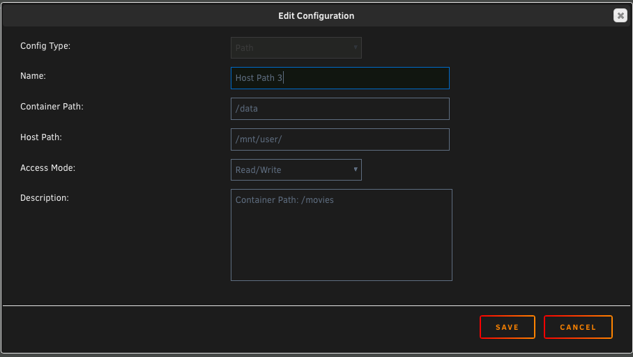

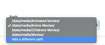

Hi everyone.
Im writing to ask for some help (yeah, again, sorry), I thought I had everything setup as per a previous post regarding slow import speeds because User Squid (sorry I don't know how to link or mention user accounts directly) mentioned that files traversing different mount points cannot be moved so a copy is done, and what I thought I did right following the advice posted but I noticed again when importing a 30GB movie that it took nearly an hour..
So I did some experimenting.
Firstly, I have changed my Radarr mounts in unraid to be /data only (I deleted the /download mount point and changed the remaining one) as per user "Wh0_cares' "and then within radarr itself had /data/media/movies while pointing it to manually import from /data/downloads. (this was on page 10 of this post)
my understanding was because /data was now the original mount point for this docker, any subdirectory difference shouldn't matter, but it still does..
If I move the file to the same folder as where the movie folders live and import, its instant, if I have it at the downloads folder, to copies, but its all originating from /data. so I think?
I have included some screenshots showing the layout.. I thought I had it going, as im sure I did a test import last month when I set it up, but testing now shows it still copies when manual import is set to move unless its from the same folder as the destination.
so you can see my radarr folders :
all coming from /data.
so if I have the source file living within /data/media/import or /data/media/temp files (see pic:
its an instant move
but coming from its original download folder which is /data/downloads/radarr/
it will only copy.
I can happily use Krusader to move the file instantly between these directories.
Any help greatly appreciated!

There is a problem with Mono 6.0 where this doesn't work anymore for some reason. Try switching to linuxserver/radarr:5.14 tag and report again. The problem also occurs in Sonarr.
I have the same setup as you and it was working fine until mono 6.0 was introduced.
